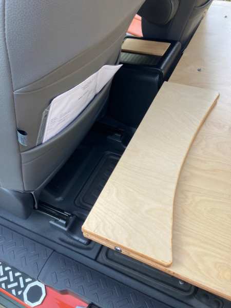

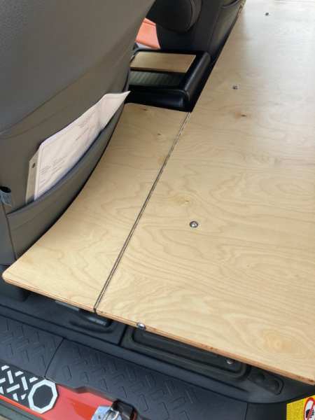

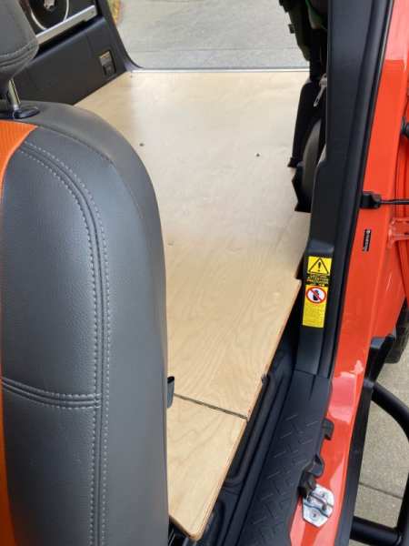

We never use the rear seat in the FJ Cruiser, they’re always folded down to transport the dogs. Unfortunately when the seats are folded down the cargo area is not flat so I made a platform using prefinished 3/4” birch plywood. The platform is 64 1/2” long, going up close to the center console, I added filler pieces to the sides by the half doors to fill in the gaps and made brackets using 1/4” x 1 1/2” steel flat bar to support the front. Since my wife is short and has the seat far forward I made a filler piece behind the driver seat that folds up accommodating my seat position. I’ll add some 3” foam on top for the dogs’ comfort. Also added some stainless steel corner guard to the back edge for a touch of class.🤣
