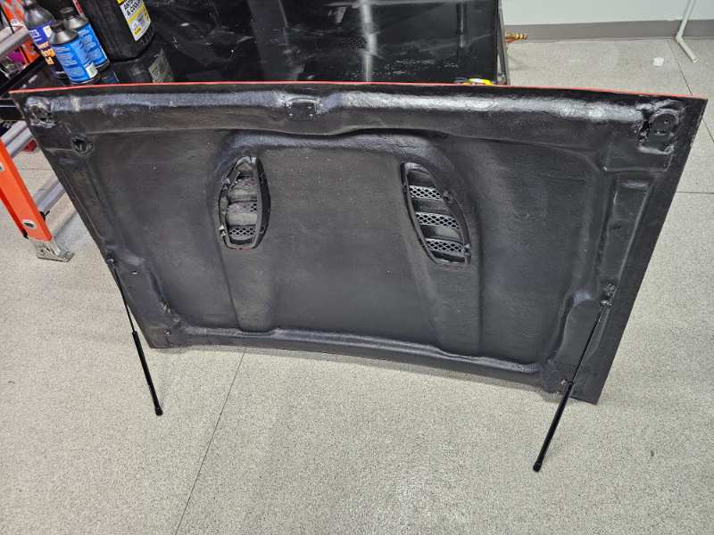

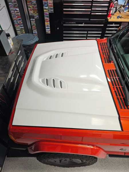

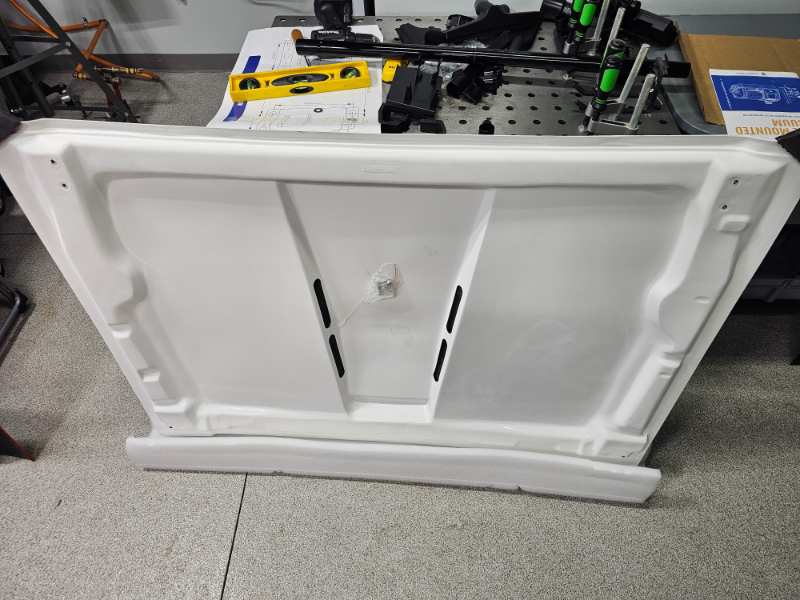

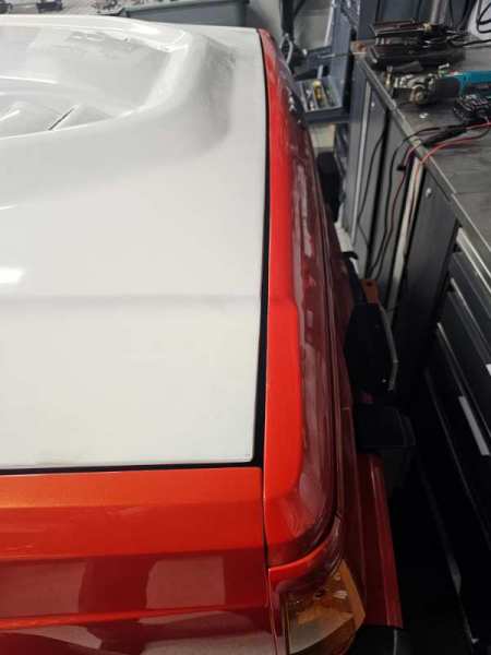

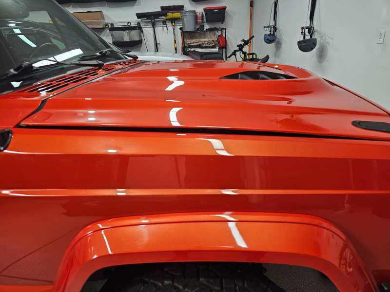

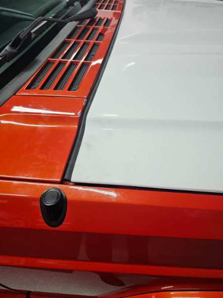

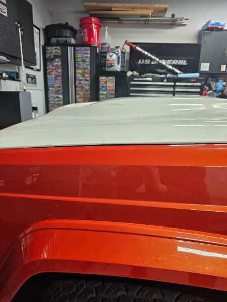

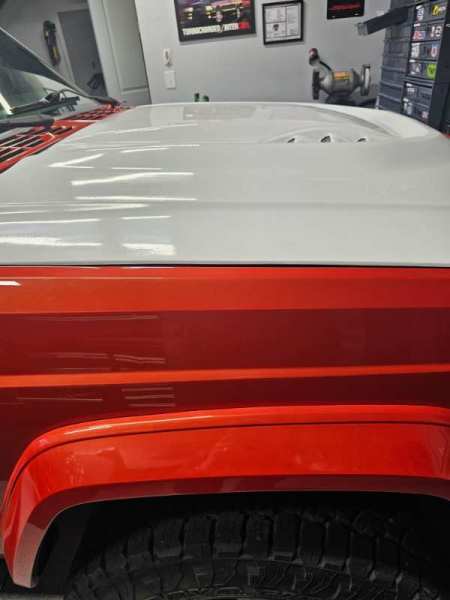

Limeyjeeper Posted December 31, 2025 Author Share Posted December 31, 2025 Finally got my replacement hood from Off Grid Research. Took a long time to get it. He had a lot of issues getting it done. I know a lot of people got upset with him but the product is far superior to anything Baja Fiber built and I appreciate that fact he even tried. The fit is good and the quality is excellent. It is being made by a well-known hood manufacturer, and they did a bang-up job. My original hood warped really badly because there was not enough structure. Warped old hood Baja Fiber Hood OGR Hood - Fully finished on both sides. Built in hood mounts and functional vents with water drain holes This was before I adjusted it Gaps are all good. Hood curve is near perfect. I can adjust the fenders to get it exact. No different to a stock hood Clean gaps I dinged the paint which will get fixed when the hood is painted Gap looks off it actually isn't. Just the angle. I am never expecting 100% perfection it just doesn't happen with any fiber hood, but this is very, very close. It will require almost no finishing before paint. Link to comment Share on other sites More sharing options...

ghetdjc320 Posted January 1 Share Posted January 1 Glad you finally got the hood! Seems like OG just got so stressed out running a business many customers dropped out. Hoping things work out though as it looks like a good product! Link to comment Share on other sites More sharing options...
