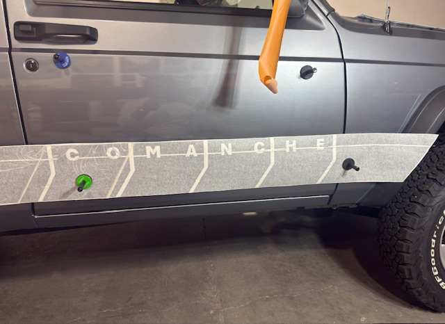

Gjeep Posted April 29 Author Posted April 29 Exciting times – At long last, final graphics in-hand! The aim is to get these on this weekend (or so). I even purchased some felt covered magnets for the job.
Gjeep Posted May 4 Author Posted May 4 Getting there on the graphics... I didn’t have as much time as I hoped to this weekend. Finished the hood and a bit of the driver side. Looking forward to posting completed pics soon! The wife will be headed to a mother/ daughter college Mother’s Day weekend event this Friday through Sunday and there will be my window to get back to it. Here's where she currently stands (and as an FYI, those are scab wheels/tires and flares. The good stuff gets put on later). In the meantime, I was inspired with another modified grille idea to compliment the Comanche’s new stripes. This grilles metamorphosis is much easier than the full knock-out/mesh grille build I did a couple years back. I still need to trim around the grille mounting ‘boxes’ and then do a light plastic-fill at the trim locations, sand, and paint. Will see which grille I end up going with. Having options is good. Finally, the topside of the Warn solenoid box has been empty for several years. The domed M8000 sticker that came on it hazed over couple months after I installed it and looked real bad. Not sure why that happened. That empty spot has been nagging at me ever since. Yes, I have the Warn emblem front side I had done but needed something back on top. Jeep had a decal many moons back (I believe for CJ or SJ factory winch installs) that inspired me. Here’s the rectangular original (not a fan of the glossy finish) and the tribute I made below for my solenoid box. Will get it produced in either a domed emblem or a high heat friendly decal. Many of the under the hood stickers I have had done online is through uPrinting or StickerApp. I create the artwork and they produce the decal in the appropriate spec based on location/ temp/ etc.

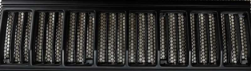

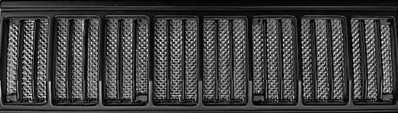

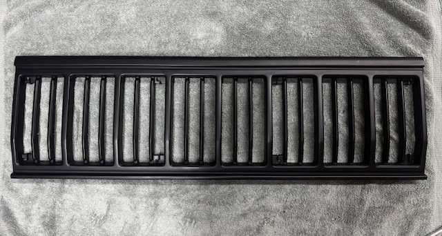

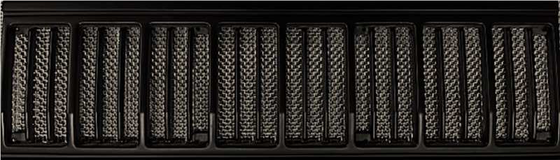

Gjeep Posted May 13 Author Posted May 13 Mother’s Day weekend didn’t afford me the time I was hoping for to finish up the graphics, so I focused on some other crazy… This grille has taken about half the time to modify as the full knock-out stainless steel mesh I did a couple years back. The raw cuts of factory vertical slats removed were done using a Dremel wheel, followed by a flat 1/2” X-acto blade to trim as close to the plastic framing as possible, then Permatex Plastic Welder/ various grits of nail files on all those spots to ensure they were good and smooth. Knocked it all out in about 30 hrs. Half inch honeycomb black (not bent to backside shape of grille yet)… Quarter inch stainless steel square mesh (not bent to backside yet)… Quarter inch black square mesh (not bent yet)… Rims… I’m all over the place currently. I still have the factory Jeep rallye’s that Stockton Wheel widened to 15x8 a while back. And the matte black Mopar 60’s era 15x8’s. But these American Racing Vectors look right on my other MJ (Chief). I’m tempted to go with these again as era appropriate – but the 15x8.5 option this time. Close to an inch more 'dish'. I’ll put one of each wheel on a 31” tire and mount it up to see what looks best with the graphics. Only way to do it. The options that fall by the wayside will be saved for another project.
fiatslug87 Posted May 13 Posted May 13 The thing I don’t like about the honeycomb is that it’s not symmetrical in the openings. Even if the square isn’t it’s not obvious due to its size.
Gjeep Posted May 14 Author Posted May 14 I agree on the honeycomb. No way to get it to look quite right.

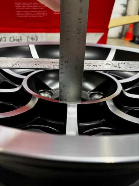

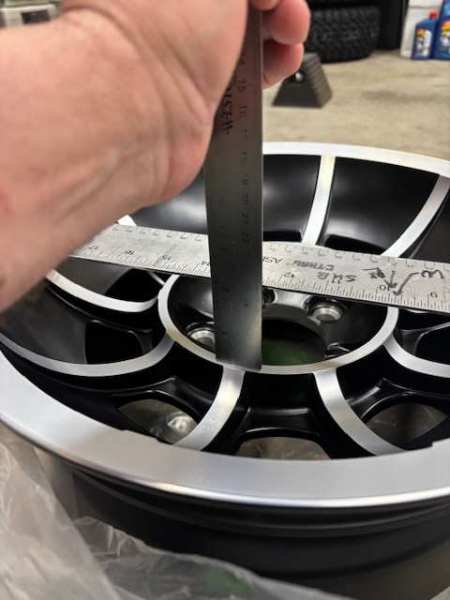

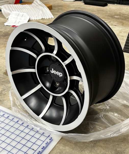

Gjeep Posted May 15 Author Posted May 15 Yep, this is the other MJ still with test graphics driver side. (Need to pull these and finish the factory Chief stripes soon enough.) For now though she serves as a good representation of how the stroker MJ will look when graphics are installed. Below are the wheel options… the two 15x8 steelie options are on a 31” BFG, while the Vector is 15x7 variant mounted on a 30” tire. The 15x8.5 Vector will have an inch more depth front side (and will also be on a 31” tire). Opinions? To me the winner is once again the Vector wheel on the MJ with a Jeep logo’d center cap. Close second to me is the black Mopar steelie with stainless trim ring and NOS Jeep flat center. I do like the early MJ/ XJ rallye wheel I widened, but think it’s too conservative for the graphics.
89 MJ Posted May 15 Posted May 15 Vector is my top choice by far. Period correct, looks a little bit sporty, and has a nice combination of bright aluminum and black. To me, but of the steel options don’t stand out enough and the chrome seems out of place being that there isn’t much, if any, other chrome on the truck.
fiatslug87 Posted May 15 Posted May 15 The Vector wheel looks fantastic! Their rib pattern really matches well with the hash marks in the graphics.
neohic Posted May 15 Posted May 15 My vote is for the widened silver rally wheels. I think they add the little extra punch of brightness.
Gjeep Posted May 16 Author Posted May 16 Sad to say after 124 years of wheel service about 6 months after I got my spare wheel widened Stockton Wheel Service went out of business. From what the owner said, that whole area of town (all the historical industrial) was being leveled for progress. Very neat place.

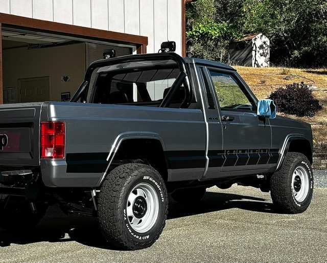

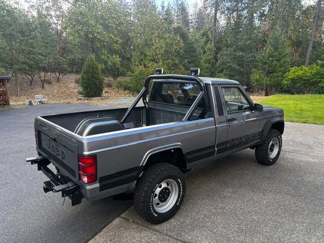

Gjeep Posted June 9 Author Posted June 9 Graphics are finito. I decided to do modify the original design a bit for those with a keen eye. The bedside stripes were run so they now tuck under the rear flares versus stopping 1/2” prior to the flare. (There were just too many starts and stops visually on the flanks.) And the top of the bed looked naked as compared to the nose-end of the truck, so added vinyl on the side lengths and tailgate ridge. Also, the tailgate blackout as I envisioned it just wouldn’t work because of the stamped ‘Jeep’ lettering. The ‘e’ cut-out/ recessed areas are too small for the lettering to look proper. Thanks to 3M cut tape, I went with a different design that looks more fitting with the rest of the graphics. Excited about the finished look – slightly modern with a nod to the MJ’s of an era gone by and its variety of vinyl visuals. Next step is getting the 15x8.5 Vectors wrapped with 31” BFG’s.

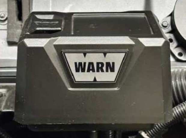

Gjeep Posted September 3 Author Posted September 3 I’ve been holding my breath for the past 5 years hoping the measurements and work I did on the support bracket between the front crossmember and bumper was spot on for my hidden winch setup. And thankfully it was – just bolted it all together. My youngest helped me with this whole hidden winch setup back when she was in 4th grade (and she starts her freshman year of college in a few weeks). Crazy how time flies – and how long sometimes these projects take to get done! The go-between support bracket itself has weld nuts just behind the front bumper for the fairlead and Maximus winch line hanger bolts to thread into. Nothing is bolted down tight but wanted to do a test fit before taking everything to get powder-coated. Mounting hardware for the fairlead will be the same stainless steel bolts I used on for the factory sport bar. There will also be a ‘dust brush’ (shown below) just behind front bumper to keep the winch line clean and bug-free. Warn Epic fairlead and hook both blacked out will adorn the front. Getting back to it!

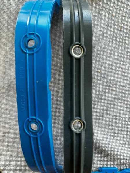

Gjeep Posted October 7 Author Posted October 7 Should have listened to the little voice in my head (8 years ago)… Before I installed this motor. That voice of wisdom that echoed repeatedly in my head for a couple months – ‘just redo the oil pan gasket and rear main seal before you drop the motor in’. 3D me said, no no, it’ll be alright after all it’s a brand-new build. They know what they’re doing. In the stroker goes with all the leak-free confidence in the world. After a week of running it, a drip appears on the garage floor. Knew it. Just knew it. I remember Hornbrod’s advice, ‘Just run it. Fix it later’. Dear Don, ‘later’ has now arrived. I spy at least one possible reason the RMS was leaking. They secured gasket to the pan but there NEEDS to be anaerobic gasket maker on block where arrows are pointing. And my guess is, once I pull off the rear main bearing cap, there will be a lack of gasket maker between the two seal halves. Life will go on once I button up – sanity for the most part restored. Also took a moment to replace the plastic FPR vacuum line with a stainless steel version. Better.

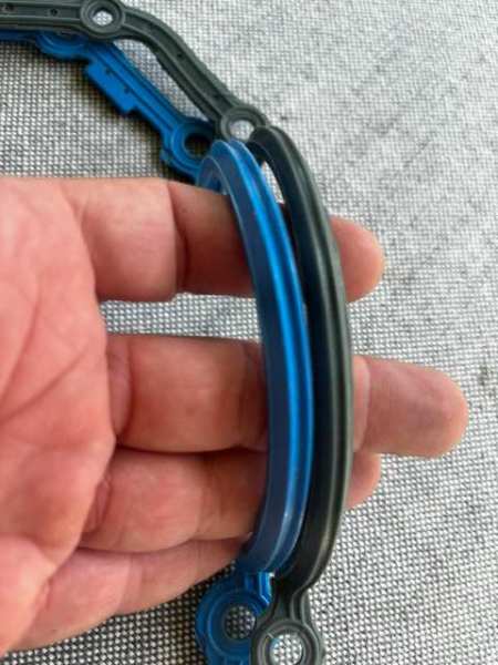

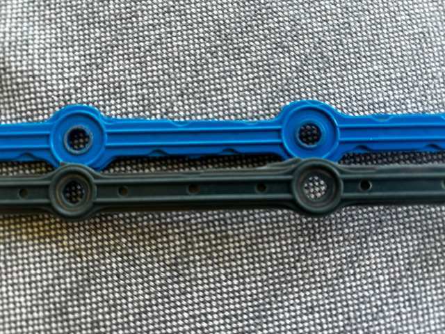

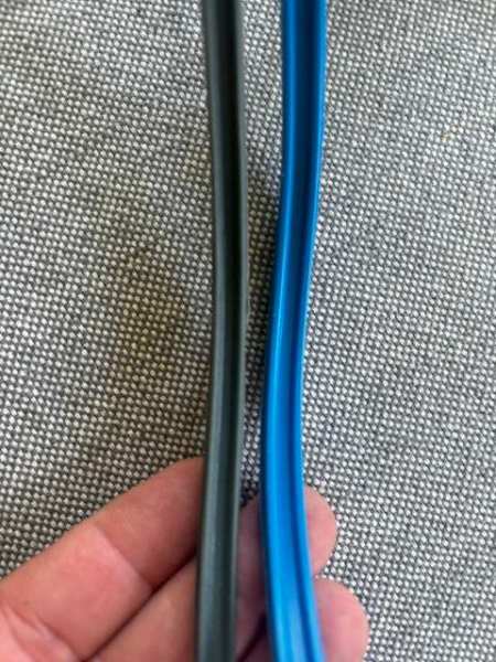

Gjeep Posted October 8 Author Posted October 8 Since Hesco used a factory Mopar one-piece oil pan gasket on the stroker, I was thinking that would be the direction I’d go for the replacement. Especially since the blue Fel-Pro was, well, blue. I got curious as to the differences between the two and decided to do a side by side comparison. Mopar’s final gen was a one-piece unit is very similar to the Fel-Pro. In absolutely every other RMS/ oil pan gasket job done, I’ve always gone with the Fel-Pro. Never an issue. Fel-Pro is wider as you can see in pics but both sides of the Mopar ‘tracks’ are deeper than Fel-Pro all around. Mopar has slightly smaller bolt holes with gasket material ‘inside’ the hole – except the two holes as very front of the engine. (I put gasket maker on pan bolt threads always.) Which is the better gasket? Who knows. My purchased new XJ’s (1995 & 2001) each reached 150K before any leaks at the RMS, with the oil pan gasket showing no signs of leakage. Closest comparison using the Fel-Pro would be this very MJ pre-rebuild. Around 125K I replaced the RMS and used Fel-Pro blue on the oil pan…it got me to the vehicle refresh of 250K with no leaks either.
