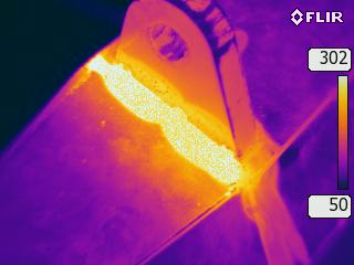

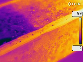

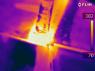

Sir Sam Posted December 17, 2018 Author Share Posted December 17, 2018 So I'm finally getting to the bumper part of this project. Got it bent, tacked, test fitted, and now onto the welding, have a friend over to help with the welding since my welder/me suck and I want it to be presentable. Link to comment Share on other sites More sharing options...
Pete M Posted December 17, 2018 Share Posted December 17, 2018 can't say I've seen pics like that in a build thread before nice! Link to comment Share on other sites More sharing options...
Sir Sam Posted December 31, 2018 Author Share Posted December 31, 2018 Link to comment Share on other sites More sharing options...
Sir Sam Posted December 31, 2018 Author Share Posted December 31, 2018 Justin helped me finish the bumper welding yesterday. Just in time too. Took a video while welding one of the end caps: https://youtu.be/5BxyG-z_26E Link to comment Share on other sites More sharing options...
