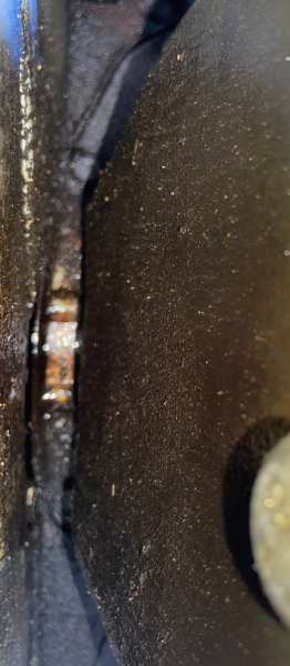

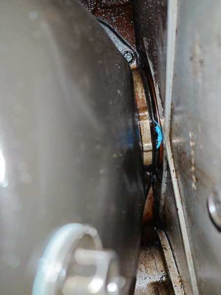

pizzaman09 Posted March 26 Share Posted March 26 Last year I changed my rear main seal and oil pan gasket to try to fix the oil leaks I have. I was under the truck today and see that the Fel Pro 1 piece gasket I used on the oil pan appears to be extruding out at the rear. Does anybody have an opinion on whether the single piece or multi piece gasket is easier to deal with in install as I'm going to have to do this again. Link to comment Share on other sites More sharing options...

Eagle_SX4 Posted March 27 Share Posted March 27 I have had this happen to me as well where the part under the rear main seal slips out of the oil pan. When I reinstalled it I used some silicone to glue it to the pan so it wouldn't happen again. It has been holding up well. Link to comment Share on other sites More sharing options...
Gjeep Posted March 27 Share Posted March 27 In that area and the front area I use a gasket sealer to help keep the FelPro in place while installing. Link to comment Share on other sites More sharing options...

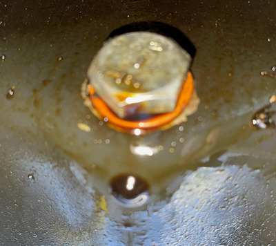

AnotherOldJeepGuy Posted April 8 Share Posted April 8 It also looks like my drain plug might be leaking. Perhaps a new washer is needed. Link to comment Share on other sites More sharing options...
