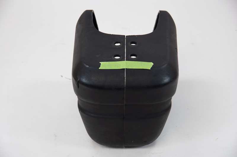

White_Comanche Posted June 11, 2025 Share Posted June 11, 2025 That pair from eBay arrived. The caps are just as described... straight, not warped, and not many imperfections. Molding and replicating these should be possible. Believe I'm almost there on how to go about mold making. Unfortunately, what ever pair I use, the studs will need to be sacrificed. I'll need to cut them out, and make that mid plastic spar flat. With that being said I am willing to exchange these with a pair that is equally MINT, but do not have the bolt studs for whatever reason. We both pay shipping, and detailed pictures will be sent of each pair. Administrators and frequent members of Comanche Club only respond please. Link to comment Share on other sites More sharing options...

White_Comanche Posted June 12, 2025 Author Share Posted June 12, 2025 Singles or Doubles will work, just as well. I'll send detailed pictures to anyone who has either. Link to comment Share on other sites More sharing options...

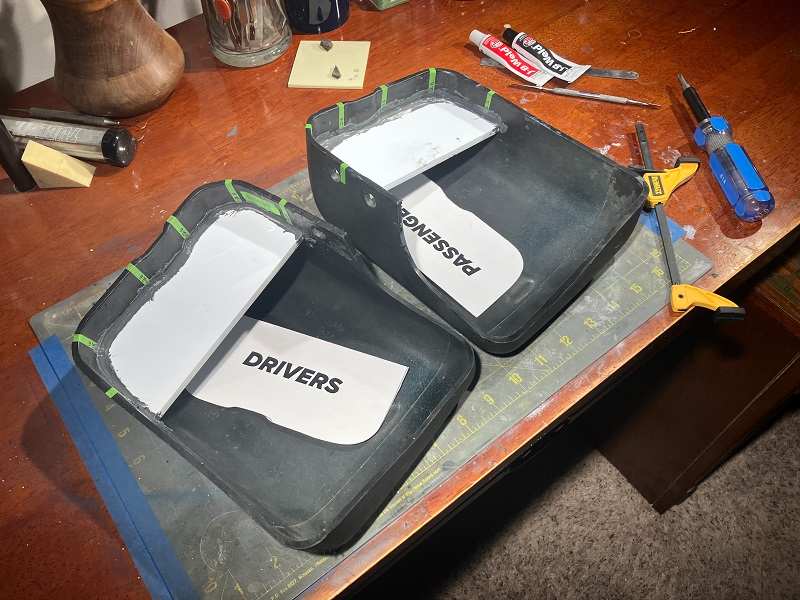

White_Comanche Posted August 11, 2025 Author Share Posted August 11, 2025 At first, I was hesitant in showing in-progress shots. Now with this much time into it, I doubt too many would even get to this point. Link to comment Share on other sites More sharing options...

White_Comanche Posted October 12, 2025 Author Share Posted October 12, 2025 Reached milestone today. Next stage is mold making Link to comment Share on other sites More sharing options...

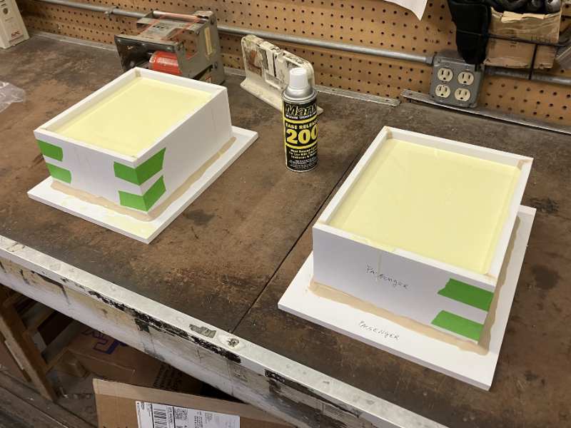

White_Comanche Posted January 19 Author Share Posted January 19 Much has been accomplished in the past several months. Sure has been a real journey learning about large scale reproductions. It's been both Fun & Very challenging. Every step has been met with one roadblock or another, workaround, or re-thinking. Just poured the largest pieces of the mold blocks today. Really hoping that these cure completely fine — and without any sort of reaction involving the silicone. I borrowed my work building to mix the product. I'll know in the morning if it all went well. Link to comment Share on other sites More sharing options...

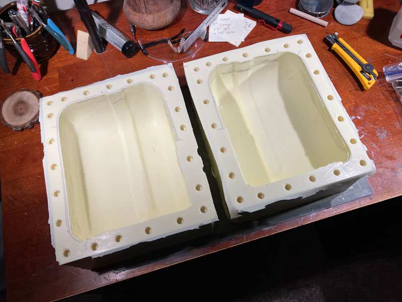

White_Comanche Posted January 20 Author Share Posted January 20 Here's the result. The bumper pads and keys successfully extracted from the molds. No cure inhibition with the silicone occurred... Cure Inhibition refers to contaminates either being on the surface of the part or embedded into the actual material that prevents silicone from curing properly. Instead of dry and tack-free, you would get very sticky results. The business I'm working with in Denver says I'm on the right track. Next are creating the other mold parts, along with establishing pour mouths and vent tubes. Link to comment Share on other sites More sharing options...
