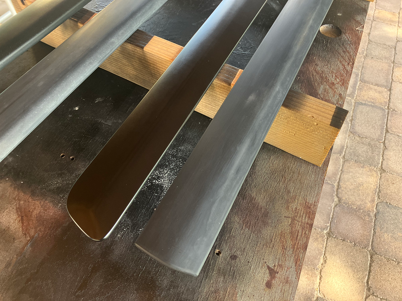

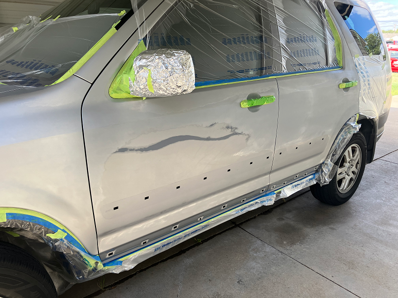

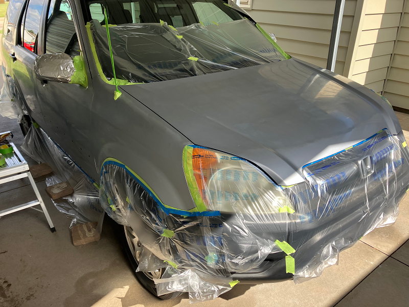

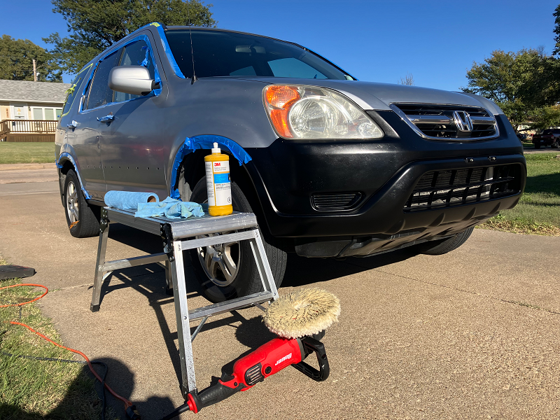

I can see the light at the end of the tunnel. Have been working on this project every weekend, and some weekdays after work. Trying to complete before it gets too cold. Very satisfied with this SEM 3+1 black plastic trim restoration process. Professional Body Shops use these products, so it must be pretty good. Discovered that the cured black coating bonds pretty well... I sanded part of a thin strip that points wheel well side. It smoothed down nicely using 220, and didn't go down to plastic. 1000 GRIT SCRATCHES ~ 2000 AFTER This front fascia is the largest thing I've ever spray painted ! Very complex to keep track of painted areas. 1/2 FINISHED ~ FRONT FENDERS & HOOD COMPOUNDED

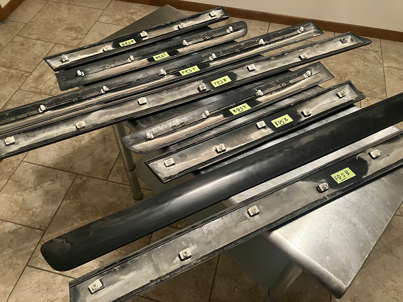

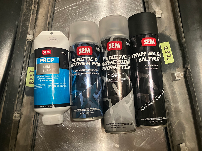

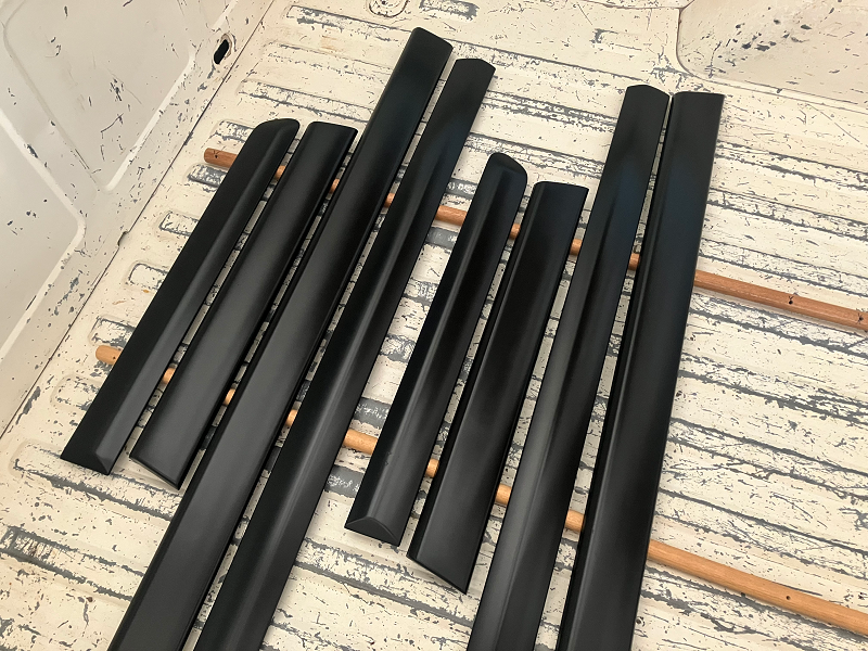

This SEM 3+1 Step Process sure worked out well today! The black colorant sprays like paint, but actually appears to become part of the plastic. Does not have that paint-on-surface feel or look. Looking forward to doing this to the front of the vehicle! BEFORE & AFTER
Just as NHMJXJ said: the torch method for "restoring" black plastic fatigues the plastic. DO NOT USE THE TORCH METHOD TO RESTORE BLACK PLASTIC IT TOTALLY DESTROYS THE PIGMENT OVER TIME !!! SO, I CREATED A NEW FUN PROJECT... ... INVOLVES USING THIS PLASTIC RESTORE LINE FROM SEM IT ALL BEGINS WITH FIXING PAINT AFTER WET SANDING F-UPS NEXT WILL BE USING THE MULTI-STEP SEM PROCESS ON THESE... NEXT: • PAINTING ALL BLACK PLASTIC - FRONT FASCIA IS NEXT • AFTERWARDS - SANDING, COMPOUNDING & POLISHING This old bird is gonna look GREAT when finished
