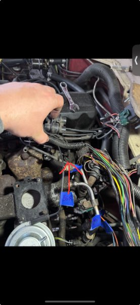

joeCor Posted May 30, 2025 Author Share Posted May 30, 2025 Got the tbi out and goi g to try to remove the screw today. Can anyone tell me what this sensor is? Link to comment Share on other sites More sharing options...
GonzoTheGreat Posted May 30, 2025 Share Posted May 30, 2025 That's the intake air temperature sensor Link to comment Share on other sites More sharing options...

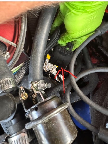

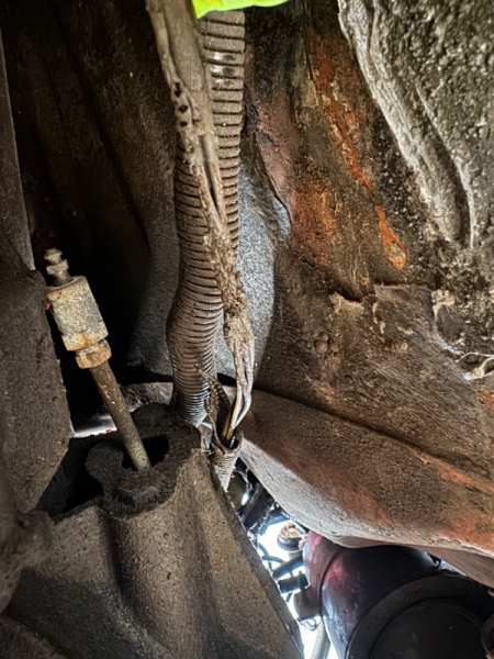

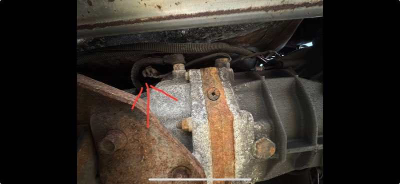

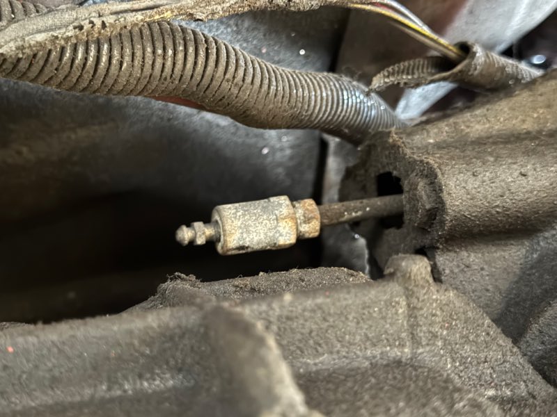

joeCor Posted June 2, 2025 Author Share Posted June 2, 2025 Didn’t want to start a new topic if I don’t gotta but can any one tell me what this is and why it seems like something is missing? Also near it are these wires that are all melted together. I’ll include a pic of the harness it goes to in the passenger side of the engine bay and point out the harness it goes to under the truck. I’d appreciate any info👍 Link to comment Share on other sites More sharing options...
llhat Posted June 2, 2025 Share Posted June 2, 2025 got a hydraulic clutch? looks like a bleeder fitting for some type of hydraulic... certainly not electrical. Link to comment Share on other sites More sharing options...
87MJTIM Posted June 2, 2025 Share Posted June 2, 2025 Two of the wire go to the reverse lights. It looks like there are more than 2 wires in the loom, thou. Link to comment Share on other sites More sharing options...
