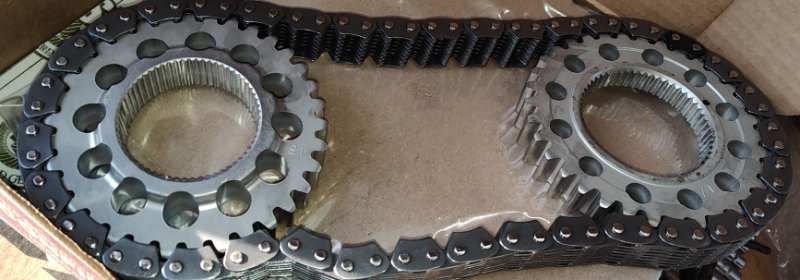

Eagle_SX4 Posted April 3, 2025 Author Share Posted April 3, 2025 Rebuilding my NP242 transfer case because the chain was worn and actually skipped a tooth a few weeks ago. That was a very loud concerning noise. Checked both driveshafts and axles and everything else is fine. Got a new chain along with new drive and driven gears. It will be going back together tomorrow. Link to comment Share on other sites More sharing options...
Eagle_SX4 Posted April 6, 2025 Author Share Posted April 6, 2025 I got my transfer case rebuilt and installed. The only thing I regret not doing is opening up the differential. It seems to be sticking when in full time mode. It seems to grab and then let go when doing tight turns. I might pull it apart again and see if I can rebuild that differential. I also changed the rear wheel bearings and seals on the 44. I was glad to have a press. The passenger side seal had started leaking badly and gear oil was leaking on to the tire and the brake drum was full of gear oil. The driver's side had started to leak but had not made it to the brakes or wheel yet. Link to comment Share on other sites More sharing options...
