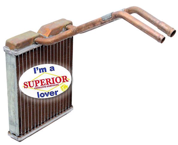

1999 MJ Posted July 20, 2025 Share Posted July 20, 2025 I know this is from 18 months ago, but this company advertises copper / brass heater cores (superior cooling dot com). https://www.superiorcooling.co/4874045-399233-heater-core-jeep-cherokee-comanche-wagoneer-wrangler.html Link to comment Share on other sites More sharing options...
