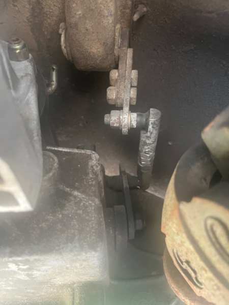

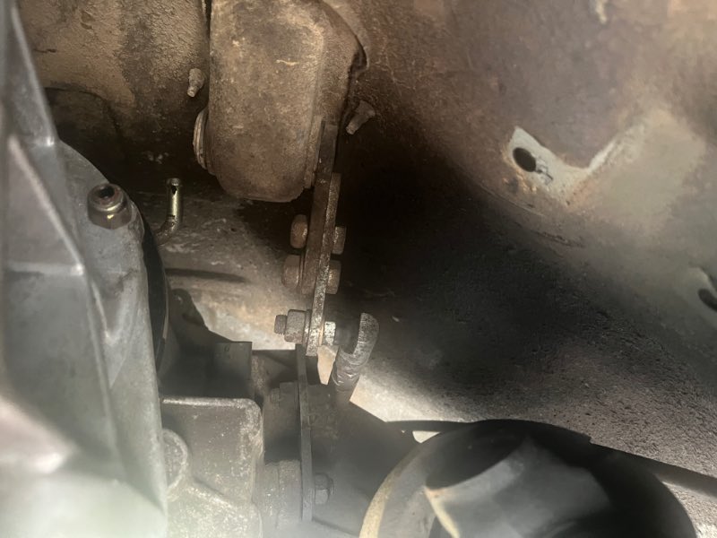

SoloRiderForever Posted April 1, 2022 Posted April 1, 2022 Even tho my truck is a new build my xfer case linkage was wonky. I looked at it, and all of those rubber gromets were new, but one was missing, causing the wonkiness. I took one look at the Borg-Warner linkage and laughed at how companies will keep engineers that make problems harder than they are and I ordered the Azzy's Design Works linkage. They tell ya it'll take about an hour. It should have. Well, I got mine on and couldn't shift to 2-High. So after several times of taking it off and re-mounting it with something turned different, I kept getting the same issue - couldn't get into 2-high. I looked at Azzy's videos and couldn't see any with my problem. What problem? The dang piece that they give you to replace the shifter - it's too wide and would hit the Xfer case! Simple fix - get out the grinder and take a eigth-inch off of it. Easy fix. Frustrating time waster. There's no reason for the part to be shaped as it is. And Azzy's didn't warn me about this issue. It could have saved me a couple of hours. I did find another video of a guy that ran into the same thing - his fix was the same as mine. And, it your crossmember is in like mine was, it's a pain using two wrenches everywhere! I didn't find it until after I had ordered the Azzy's, but I wish that I had gone with the cable shifter. It looks like a really simple and elegant fix. I'm not unhappy with Azzy's, but not happy either. ...just giving my two cents worth.

SoloRiderForever Posted April 9, 2022 Author Posted April 9, 2022 On 4/2/2022 at 5:46 AM, Pete M said: Weird that some people have that issue but others don't. but glad you were able to make it work. Got a pic of the interference? Maybe there are some unknown differences in the t-cases over the years. I took about 6 pics today - and not one showed it well enough to see the issue. Problem is, I can't see a thing on my phone when I'm outside, so I take a bunch of pics and hope for the best. Today it didn't work. I'll get a pic of it tomorrow.
howeitsdone Posted April 9, 2022 Posted April 9, 2022 I have a BA10/5 and 242. Installed the Azzys and I'll say it's not 100% perfect, but far superior to the stock linkage. It did take me longer to install than I anticipated, but I believe that to be more user error than not. I installed it backwards the first time... IMO worth the price. Especially when compared to the cable shifter cost vs. return. Then again, I don't shift the TC every day, or week for that matter. What part were you having the clearance issues on? I initially had a clearance issue from the nut, but then I realized the piece was backwards. I didn't even remove the existing bar like they said to do since the bolts were seized and I didn't feel like doing more than necessary.
SoloRiderForever Posted April 9, 2022 Author Posted April 9, 2022 Pete M, I don't have to take a pic now. Simply look at the pic above - the red & white piece - it would hit the xfer (231) case when trying to go into 2-High. I simply ground an 1/8" or so off it, just at the top. But, ya know, you take it off and put it on several times before you figure out to grind it - just a little frustrating.
Pete M Posted April 11, 2022 Posted April 11, 2022 yeah, I was wondering if there's any difference in the t-case itself at that point. maybe they changed the casting slightly over the years?
