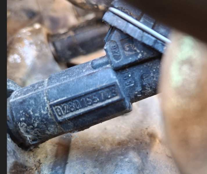

Cool, the Neon injectors were installed by the PO, I'll see if I can find some 0280155702's and see if that stops the Pop Pop Pop, thanks for the insight! -

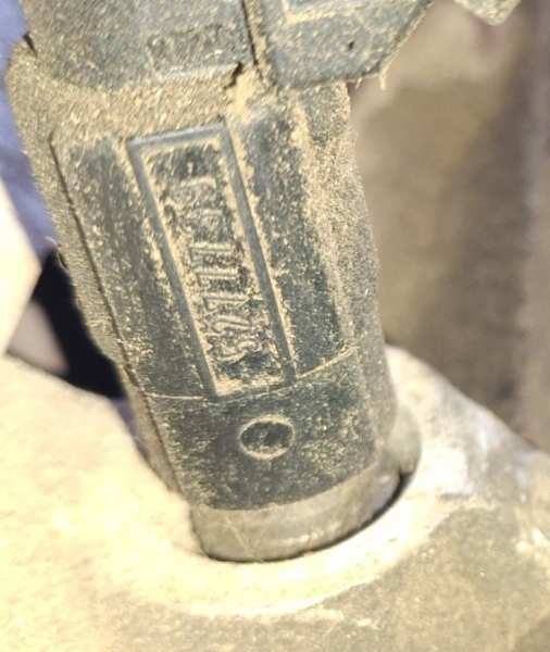

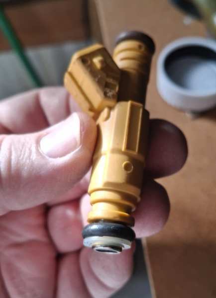

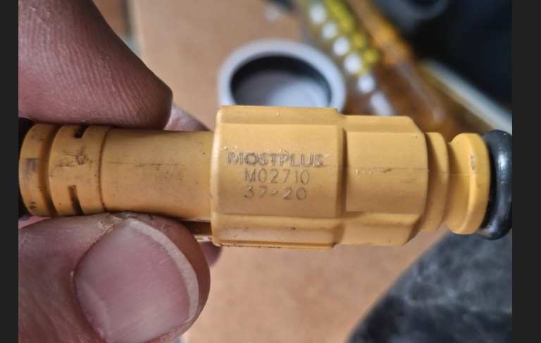

I was able to get to this today. CPS is the non-high altitude version Injectors have a bunch of numbers, Side A: 0280155703 I think the first digit is a Zero, but I'm not 100% sure Side B: 5277739 I have another set of injectors on hand that I suspect are Chinese knock off Volvo injectors to try if the ones I have are incompatible. I bought them off Ebay or Amazon a few years ago, installed them and they didn't work, but I was having other issues at the time so I'm not counting them out if I need to swap in a different set of injectors. -

Thanks for the input gang, looks like y'all have assigned me some tasks, 1. Pull injectors get part no 2. Pull CPS see if it's high altitude/adjust per Renix tips (there always seems to be something new and relevant there) Once I have these handled, I'll post up thanks again all -
