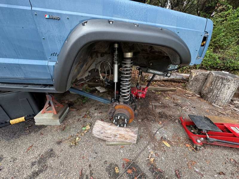

Routed my exhaust out the side to get it up further. It will end up being protected by a skid. I was also able to add the dirt bound protection panels and started fitting their sliders. I hope to have all the armor on by April
