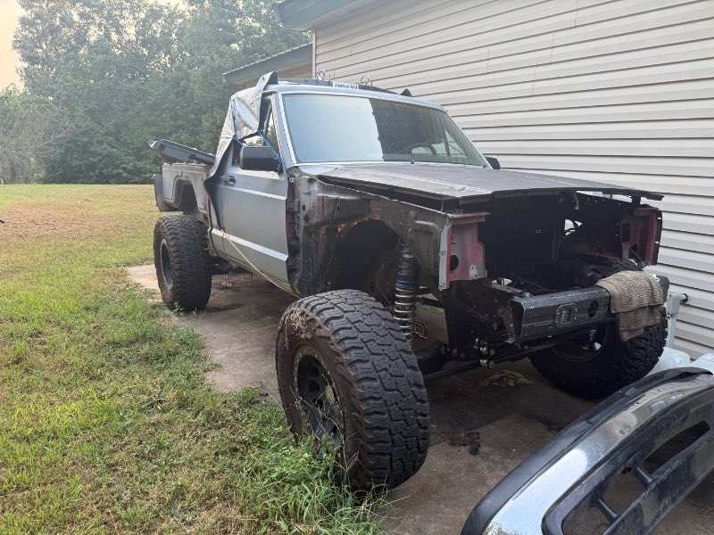

Comanche SS Posted February 1, 2022 Author Share Posted February 1, 2022 Today's progress. Can't weld in the shock tower until the WJ master and booster are fit into place. So hopefully this weekend I can burn in this shock tower and then move to the other side!Sent from my Pixel 5 using Tapatalk Link to comment Share on other sites More sharing options...

Comanche SS Posted February 2, 2022 Author Share Posted February 2, 2022 So the front will be at 69" WMS and 84" overall width. Pretty on par with most prerunners. Finding a 65"-67" WMS rear axle shouldn't be too hard.Sent from my Pixel 5 using Tapatalk Link to comment Share on other sites More sharing options...
