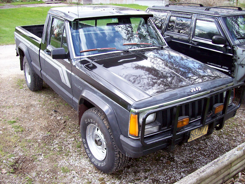

I was looking through my photobucket acount and was tired of waiting for the next picture to load. Photobucket is nice but why is it so slow? So I remember I used to use Picassa and thought I would try to post using this. Well what a suprise when I found a few pictures I forgot about. So here's a few that I misplaced over the years.
My truck when I got it home, next to my wrecked '98 XJ which is the reason I thought I would buy a beater truck in the first place. Look at where that thinking got me!!
