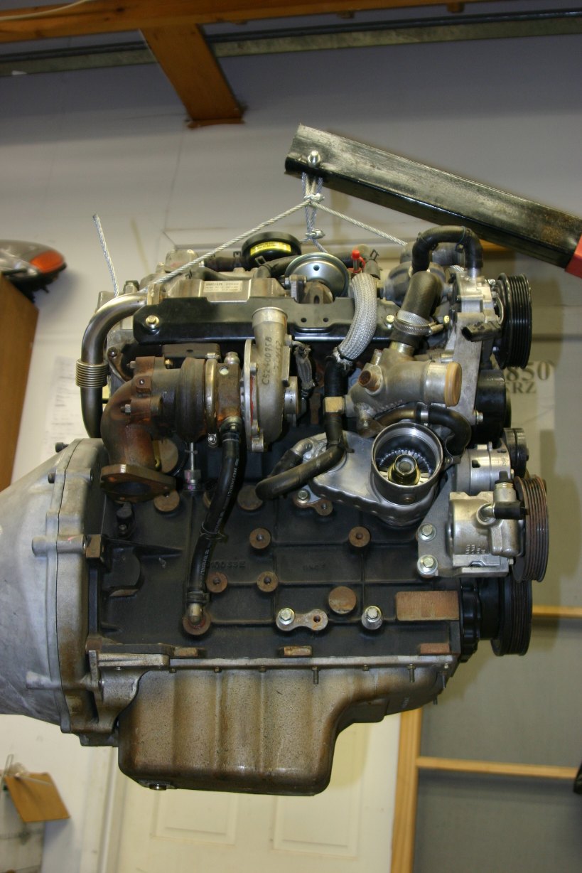

Sir Sam Posted March 22, 2009 Author Share Posted March 22, 2009 These are just a bunch of picture of the side of the engine, I figured I would never have as good of a view of it again once its in, so I took some pictures for reference. The combination of the extreme height of the engine, and the depth of the oil pan, means that at the very least the front end needs to sit up about 3" and the engine needs to sit back a good ways to clear the front differential. To get good clearance the firewall needs to be persuaded into a different shape. Its gonna be tight: Link to comment Share on other sites More sharing options...

Sir Sam Posted March 25, 2009 Author Share Posted March 25, 2009 Lots of extra metal on the fender that needs to be removed: Here you can see the parts of the headlight support that need to be trimmed: This will be my drivers side engine mount, its a engine mount for something, I just grabbed it off the shelf at autozone because it looked close, it has the right height to clear the articulation of the upper control arm. I just wish it was heavier duty looking. This is going to be the passenger side engine mount, its very similar in design to the OEM KJ mounts, but it only about 3" tall, the passenger side engine bracket sits up much taller than the drivers side, so I have to use the shorter one on the drivers side. This is the Oil filter location, when I got the engine it came with a cartridge style oil filter that stuck way out, it just wasn't going to clear the frame rail, I was worried I wouldn't be able to fit anything and would need to get an oil filter relocation kit. So today at autozone I brought my parts down and started looking at oil filters, of course the larger fram PH8A and the sotck PH16 work, but both are too large, I started grabbing some off the shelf and it looks like the one I picked works perfect, as it turns out it looks like its for the 4cyl XJ/TJs........lucky for me I will actually be able to get this oil filter on and off when the engine installed: Link to comment Share on other sites More sharing options...
