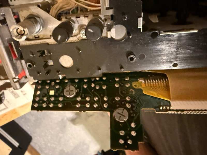

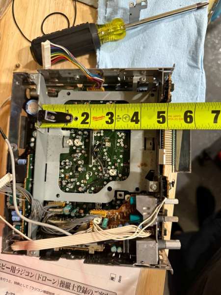

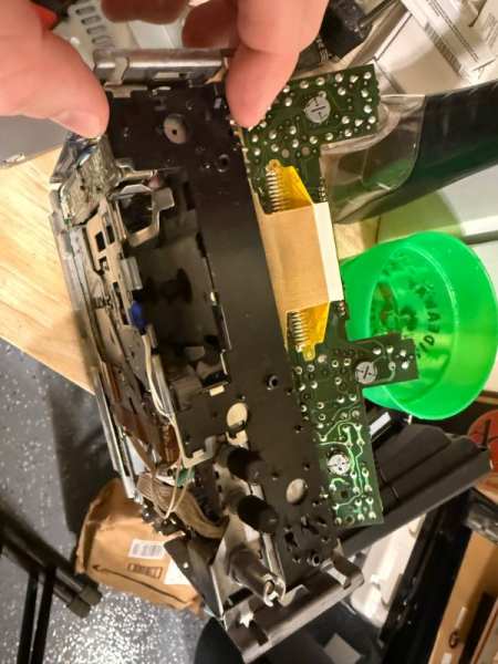

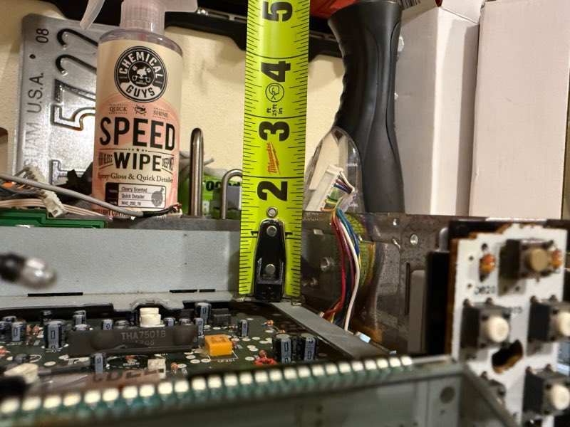

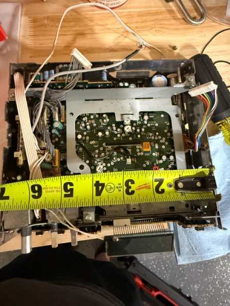

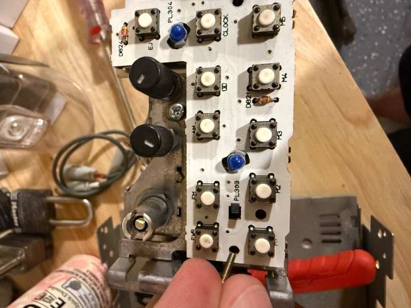

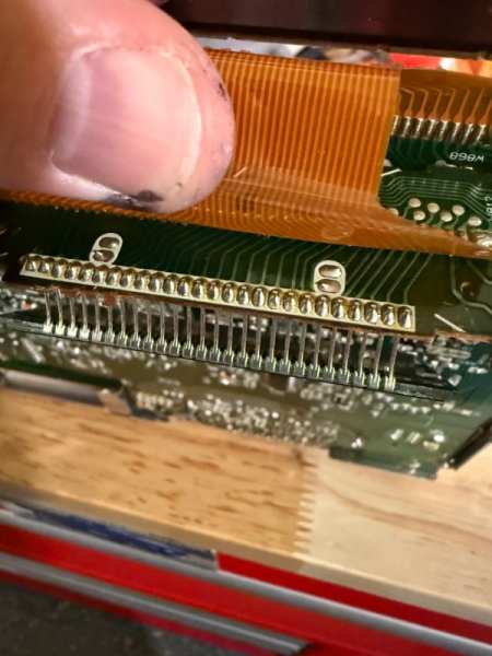

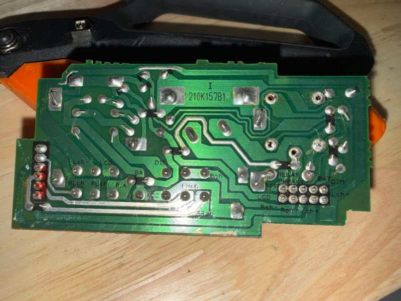

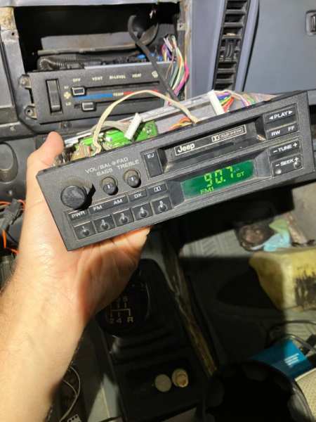

So... I've been digging through a recent RX-172 from a 92 MJ recently. I'm really just doing process of elimination signal testing. I've had many different ideas about what to do with these ready from custom Arduino with OLED interface in place of the stock LCD to installing a DSP amplifier board in place of the tape deck. From what I've been gathering, The main am/fm radio processing board is the large bottom PCB on the bottom of the radio. There is a 3 wire JST connection that feeds the pre-amp module with radio signal in basically an XLR audio format. There is another 3 wire JST from the cassette deck module to the pre-amp. What I'm referring to as the pre-amp is the small board that hosts the two pins that people are using for the aux input and the volume/fader and tone control pots. The actual amplifier board is located just behind the main radio speaker/power connector. I'm going to do a picture dump so everyone can see the insides in more detail.
I have zero use for the tape deck. with the removal of the tape mechanism bracket, you now have a really nice mounting platform for a variety of PCB modules such as DSP's or Amplifiers. The radio board still needs power to provide the LCD with information to display such as the clock and radio station. Will add to this in a bit but for now here is a picture dump:

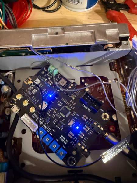

Next up, I’m going to measure the am/fm radio module output voltage to the pre-amp. I’d like to install a tinysine Bluetooth module which has an audio priority line. So basically, the am/fm radio signal will first go to the tinysine module. The module will pass through the audio from the radio until it receives a Bluetooth audio signal. Once it does, it will completely block the am/fm input. This is in an effort to delete bleed through from the radio without disabling it.
The issue we’ve had with this in the past is the output level of the tinysine module is 1.9vrms which overloads the pre-amp and introduces distortion. So I will introduce a line level attenuator to the signal to match that of the am/fm radio.
Then I’ll tap the pre-amp output signal and run it through an active DSP board which will ramp back up my line level outputs from .6vrms up to +/-2vrms.

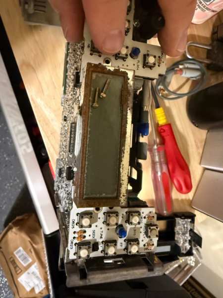

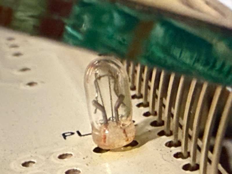

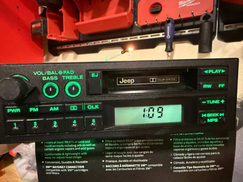

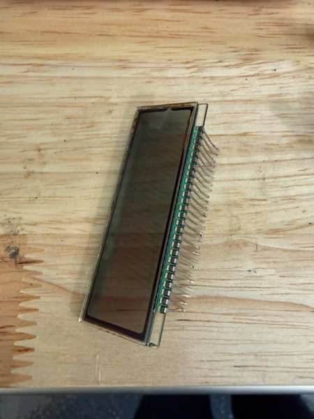

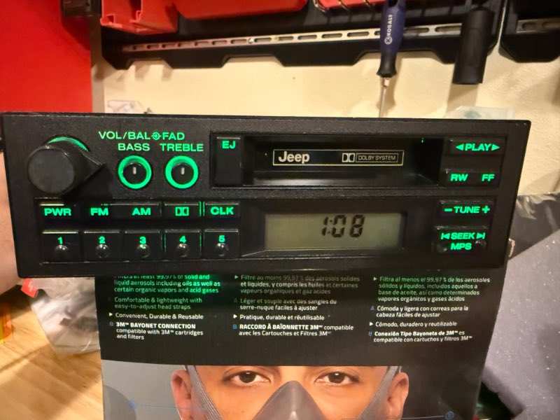

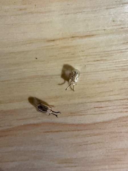

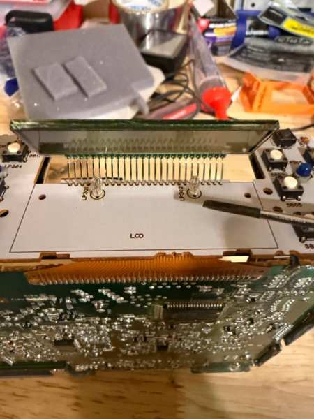

Replacing the bulbs on the RX-172 LCD is tricky but not difficult if you take your time and don’t overheat the board desoldering the bulbs.
The replacement bulbs for the actual button backlighting is a t1 style. I’ll post up part numbers here in a bit. Too much of this information has stayed elusive now for too long imo.

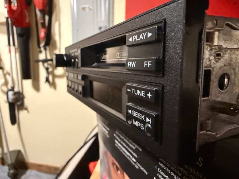

Another option I’m exploring is repurposing the play/rewind/fast forward buttons to control the Bluetooth module playback. I’d map them as play/pause, skip forward and return. I’d also like to map an actual input switch. If I go this route, the priority audio pass through will be irrelevant. The ultimate goal here is keeping it looking stock but functioning like a newer unit and integrating a DSP for audio quality improvements.

All-in-all, it would be SO awesome, if you (or anyone) could figure out how to get the LCD (or a replacement LCD) to display custom information -- even if it just said something simple like "AUX."
