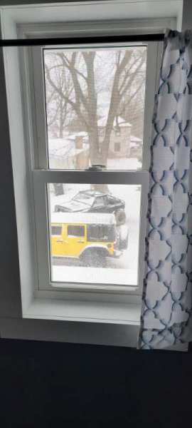

ThatJeepGuy Posted February 22 Posted February 22 My opinion to offer would only be on who you talk to if your not doing them yourself... sry for my rant as it may be less the helpful you may be looking for... Avoid the big companies with a 1-800 #. Bunch of damm thieves. We had some come in to quote replacing our existing wood frame windows with updated units. "Gee 9 windows - that'd be $18,000". Neither companies even measured the windows. Here we are now 6 years later and they are still calling/emailing spam *Anderson Windows*. We found a local fella through word of mouth and got the 9 windows replaced with some other roof work for a whopping $3800. I forget who told me this years ago but it goes a little something like "hire the fella with a working man's pickup- it'll be roughly 10 years old and have signs that work is getting done! Ladder rack, scratches maybe some dents. Avoid the folks that show up in a sub 3 year old truck that looks like its getting washed more than once a week. One of these guys is charging far too much/not doing the work themselves and it shows."
jdog Posted February 23 Author Posted February 23 13 hours ago, ThatJeepGuy said: Avoid the big companies with a 1-800 #. Bunch of damm thieves. We had some come in to quote replacing our existing wood frame windows with updated units. "Gee 9 windows - that'd be $18,000". Neither companies even measured the windows. Here we are now 6 years later and they are still calling/emailing spam *Anderson Windows*. Can't stand the company's with commercials around here, won't call Em. Both of those windows look nice. On 2/21/2026 at 9:00 AM, neohic said: This. I usually go whatever slightly higher than middle of the road is for quality. I also like specifying when ordering that I’d like new construction style instead of remodel. It means taking off whatever trim is around the window but I much prefer how they instal. That's kinda what I'm trying to figure out what middle is. From what they are telling me with the windows that are getting replaced I have to take new construction.
