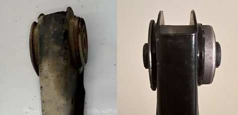

I ordered some new ones. I can tell you from measuring them, they won't fit. This is a real pisser!
Where the bolt threads through measures approx 2 3/8" wide on the stock ones.
The new ones measure 2 7/8" at the same point.
What am I doing wrong?

Yes. See pic. Old and new. The news ones are wider by a good margin. Plus, the old ones don't have those "ears" that stick out beyond the install bracket. Again, is this user error or part error?
44 minutes ago, Eagle_SX4 said:
That defiantly looks like part error.
The thing is, the set I ordered from Rock Auto was the same. This set I ordered from Parts Oasis with a "guaranteed to fit" clause. I don't get it.

Nope. SKP was the first set and the second set was True Drive. The sets were identical. I'll keep looking.
9 hours ago, Gojira94 said:
That pic clearly shows whatever manufacturer is supplying the brands he’s bought thus far are installing axle bushings in the body side of the arms.
That's interesting. They may not even know it's wrong. Or, they don't care.
Well, I placed an order with Detroit Axle. I know they are not favs around here, but they are the only ones to respond to my questions and they said their arms fit without modification. We'll see. :popcorn:
Finally! The Detroit Axle set is only 3mm wider than the mounting bracket. Should be able to squeeze then in.
