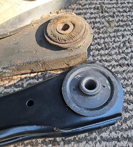

ghetdjc320 Posted March 22 Posted March 22 1 hour ago, NC Tom said: @89 MJ@ratrapp@AnotherOldJeepGuy@Gjeep@ghetdjc320@Gojira94 Alright guys, I'm in the middle of this install and don't want to go further if this isn't correct. To install the new ones, I have to hammer them into place. This is bending the bracket. Is this right? The new ones won't sit flush like the old ones. Reminder, this is the third set of these I've ordered. They have all been basically the same. If this isn't correct, I'm lost. No, definitely not correct. I’ve seen some post here about grinding down the sleeve with the WJ arm swap. You may have to do something similar if you can’t get a drop in fit
NC Tom Posted March 22 Author Posted March 22 20 minutes ago, 89 MJ said: These are the Detroit axle ones? Yes. I don't get it. EVERY seller says, "Guaranteed to fit."
NC Tom Posted March 22 Author Posted March 22 6 minutes ago, ghetdjc320 said: No, definitely not correct. I’ve seen some post here about grinding down the sleeve with the WJ arm swap. You may have to do something similar if you can’t get a drop in fit Yeah, If I do that the heat from grinding will melt the bushing. Or so I assume.
ghetdjc320 Posted March 22 Posted March 22 7 minutes ago, NC Tom said: Yeah, If I do that the heat from grinding will melt the bushing. Or so I assume. Nah, get and aggressive flap disk and knock some off. You don’t need to remove all the material at once. You can remove some, cool it off then remove more. It takes a decent amount of heat to start melting that rubber.
NC Tom Posted March 22 Author Posted March 22 1 minute ago, ghetdjc320 said: Nah, get and aggressive flap disk and knock some off. You don’t need to remove all the material at once. You can remove some, cool it off then remove more. It takes a decent amount of heat to start melting that rubber. Even though most of what I read about Moog is negative, the part images they post look correct. I may just return the Detroit ones.
89 MJ Posted March 22 Posted March 22 They all probably come from the same crappy factory overseas. Moog is likely your best bet, but don’t hold your breath. Anymore it seems most direct replacement parts aren’t that and require modifications to fit.
Gojira94 Posted March 22 Posted March 22 The arm pockets do squeeze in a hair when the bolts are torqued during (the last) installation. You can use a prybar and a scrap of lumber to open them a little and then install the arms. Get the bolts just snug and put her back on her feet before torquing to spec.

NC Tom Posted March 22 Author Posted March 22 This is insane! Decided to grind and now the holes don't line up!? I'm assuming I can drill it larger?
89 MJ Posted March 22 Posted March 22 I wouldn't drill anything larger, especially the mounts on the truck.
ghetdjc320 Posted March 22 Posted March 22 Don’t drill anything. From the pic it looks like you just need to line up the hole better. Does your oe hardware fit properly in the control arm sleeve?
Eagle_SX4 Posted March 22 Posted March 22 DON'T drill any holes. What you are probably fitting is that you put the control arm in the axle first. You should put the control arm in the body side first then move the axle to get it lined up properly. I had to use a come along winch to get my axle in the right spot for the bolts to drop in.
