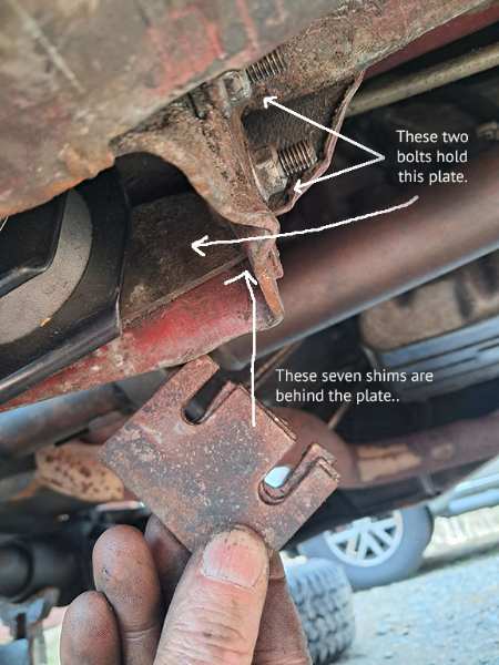

Glad you got it! So what ended up working for you?
I had to move the axle with a ratchet strap and hammer the shims back in. I broke three straps trying to move that thing. Bought a new, heavy duty one and that worked. I originally had the strap hooked to the step rail on my other truck, but the rail started to bend, so I stopped that. Then, I hooked it to the trailer hitch receptacle, and that worked. Although, I swear I was slightly dragging that truck towards the Jeep. :laugh:
