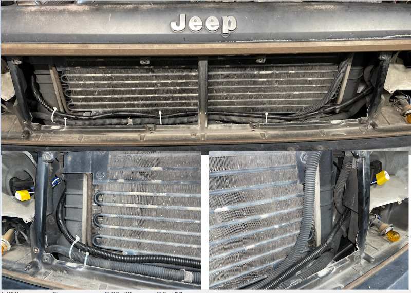

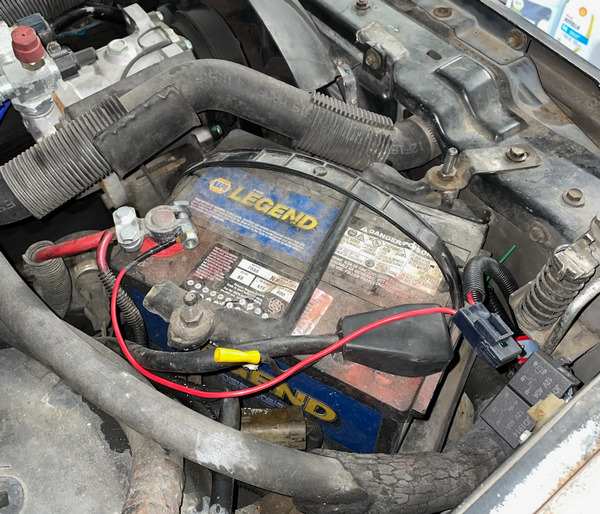

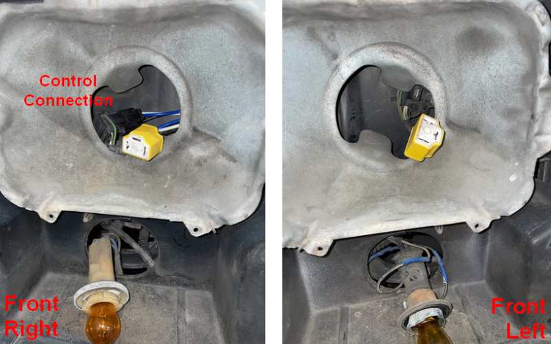

AnotherOldJeepGuy Posted January 5 Share Posted January 5 22 hours ago, Pete M said: this harness was made explicitly for helping the stock headlights give their full potential worth every penny! (also prevents your headlight switch from catching fire!) 22 hours ago, AnotherOldJeepGuy said: Awesome, I will order it today! @Pete M, if you get time would you snap a pic of where you mounted the relays and routed the cable? Thanks in advance! Link to comment Share on other sites More sharing options...

Pete M Posted January 8 Share Posted January 8 On 1/5/2026 at 8:24 AM, AnotherOldJeepGuy said: @Pete M, if you get time would you snap a pic of where you mounted the relays and routed the cable? Thanks in advance! I'll try, but the truck I installed them in isn't mine and lives about an hour away. essentially the relays live over by the battery and the wire is run next to the factory harness. Link to comment Share on other sites More sharing options...
