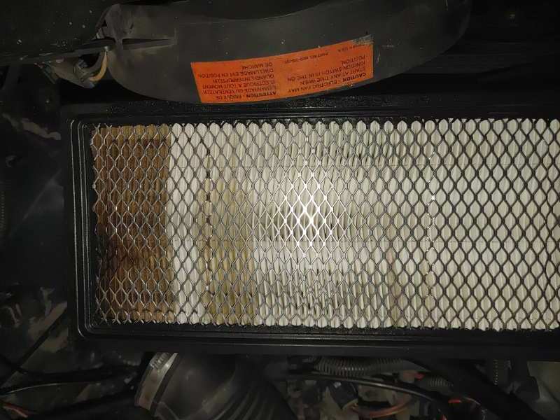

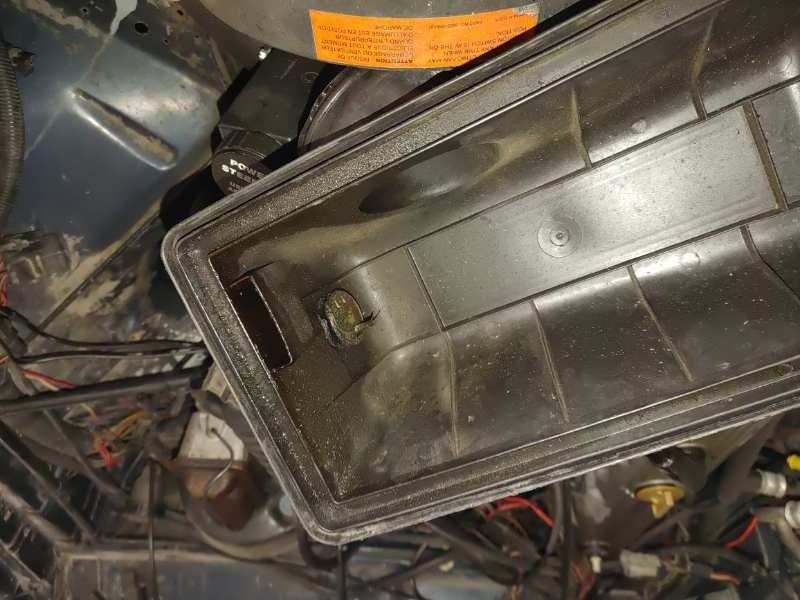

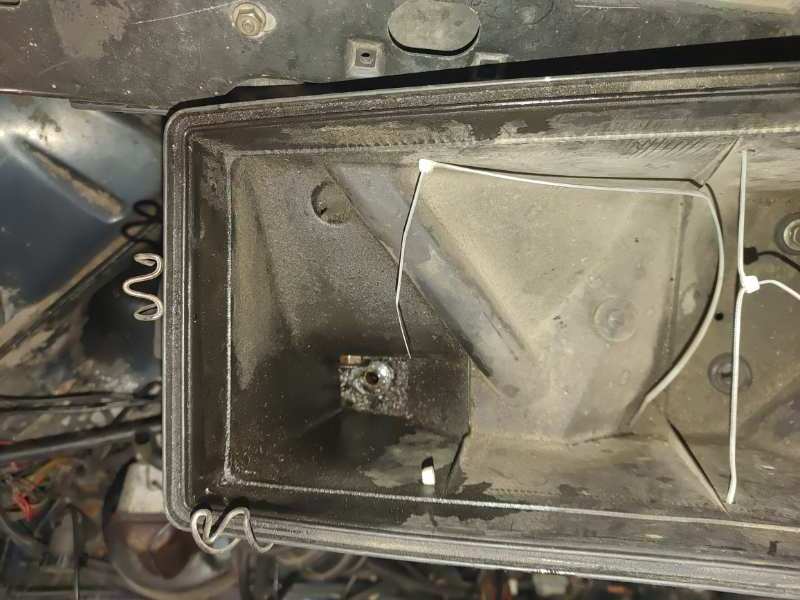

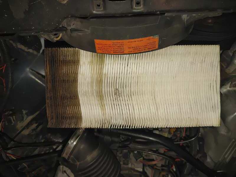

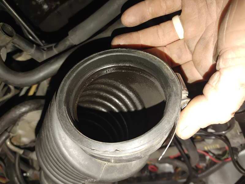

watchamakalit Posted May 4 Share Posted May 4 Ok I want to start with saying I have recently (last 5 years) replaced the ccv breathers and confirmed no blockage, cruiser54 modded my valve cover breathers, switched to lighter viscosity oil and my dilemma persists. I can't stop this old girl from running an oil bath air filter. Am I missing something obvious or is she just ready for an ls style catch can? Link to comment Share on other sites More sharing options...

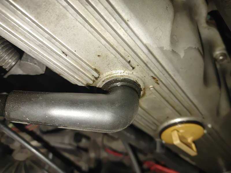

GonzoTheGreat Posted May 4 Share Posted May 4 Is the little vacuum line that runs from the other port on the valve cover clean and free-flowing? That’s the one that is meant to draw blow-by to the intake. If it’s clogged, cracked, or disconnected, it can cause this. also what oil do you run? I would imagine a thinner oil would actually increase blow-by. Link to comment Share on other sites More sharing options...

watchamakalit Posted May 4 Author Share Posted May 4 Yes the rear line is clean and free flowing. I was running 15w40 rotella, but heard it could be an issue of oil not draining back through the block fast enough cause by heavy oil weight. Last oil change I went to 10w30 and there has been little to no change. This seems to be the one oil leak I can't stop. Link to comment Share on other sites More sharing options...

AZJeff Posted May 4 Share Posted May 4 The 4.0 engine has what is called a "controlled crankcase ventilation system". That means that the rear hose is sized such that an engine in "as designed" condition will suck normal amounts of crankcase vapors through that rear hose and burn them with the combustion air being drawn into the intake manifold. When a 4.0 engine becomes substantially worn, this vent hose is not large enough to deal with the larger-than-normal amount of blow-by that the cylinders leak into the crankcase past the piston rings. Once this condition exists, the crankcase now has more pressure in it than the rear vent hose can scavenge from the bottom end of the engine, and the excess vapors now seek another way out. That way out is the front hose on the valve cover, which is normally providing INLET AIR to the crankcase. The end result is oil vapors in the air filter and air box. One can increase the size of the rear crankcase vent hose, but that also upsets the airflow mass being measured by the MAP and Throttle Position Sensor, and will result in a leaner mixture. A little bit of extra crankcase vapors being sucked in by a larger vent hose is not seriously harmful, but a large amount will cause long-term engine damage. (Using a PCV like "Pizzaman09" suggested helps limit the amount of crankcase gases being drawn into the manifold to some degree.) The real fix, of course, is to fix the blow-by on the engine by reboring the engine for oversized pistons/rings. Link to comment Share on other sites More sharing options...

watchamakalit Posted May 4 Author Share Posted May 4 I only have a mild 180000 on my motor. Previous compression test show good steady non leaking compression across the board. That is part of what makes me wonder if there isn't another underlying cause I'm not seeing. Link to comment Share on other sites More sharing options...
89 MJ Posted May 4 Share Posted May 4 I think these AMC I6s must just have a tendency to have quite a bit of blowby. My MJ engine has less than 150k on it and has blowby, my Eagle engine has an estimated 80k on it and has some blowby, and the previous engine in my Eagle had 110k on it and tons of blow by. Oddly enough, the first two I said have good compression and neither have any oil consumption issues. Link to comment Share on other sites More sharing options...
