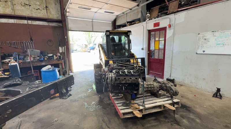

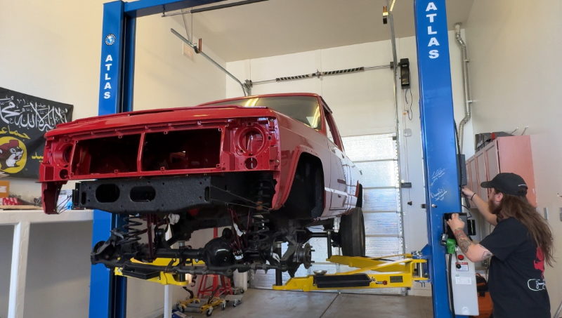

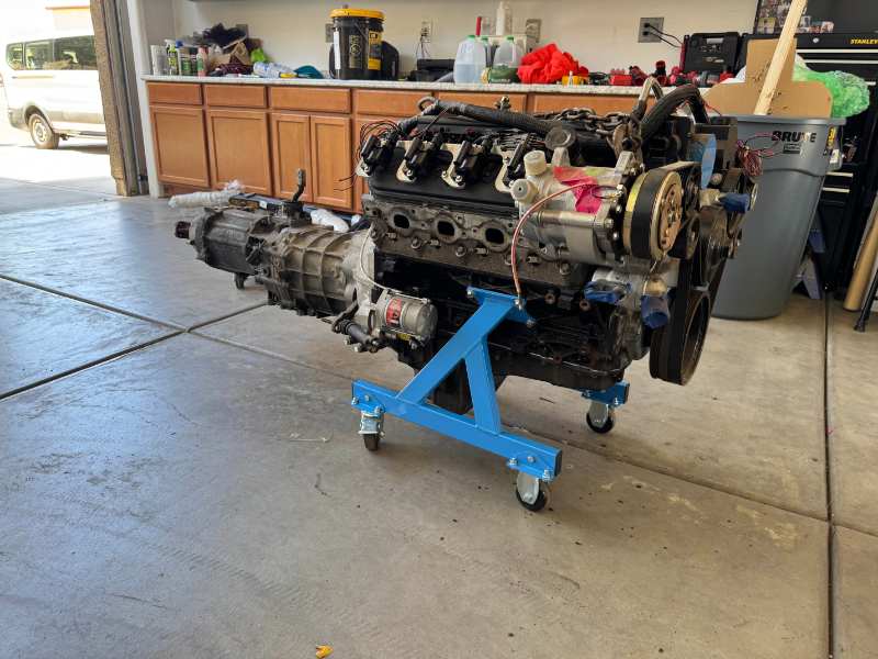

damianriel Posted May 23 Author Share Posted May 23 This year has been pretty hectic for me and progress on this truck has basically been non-existent. Hopefully with everything starting to settle down I can start to focus more on the truck than the other things that have been in play. That's not to say there hasn't been movement on this, or supporting projects, quite the opposite. However it does feel like there hasn't been any tangible movement on the actual truck, having a lift again will make this project much easier I believe. Last week I flew back to Rhode Island with my good buddy and we stripped as many parts as I could remember out of storage with my original truck. The shell is staying, I was going to put it outside and offer it up for free to whoever wanted to pick up what was essentially just a cab, dash, frame, and bed, but I think my brother got it in his head that it's worth something and he can sell it. Whatever. After loading everything up in our budget truck we started our 2900ish mile road trip back to Arizona. Unfortunately there may have been some losses along the way. Namely the SMS headliner I've had sitting around since 2018, still in usable condition but with how much effort I'm putting into the truck I'll be ordering a new one. And I found a crack on the black dash I had bought years ago as well, so I bought the only one I found on Ebay. I guess we can expect to see both these items listed on the classifieds soon. Link to comment Share on other sites More sharing options...

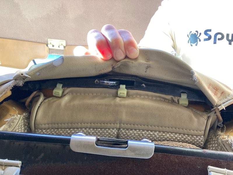

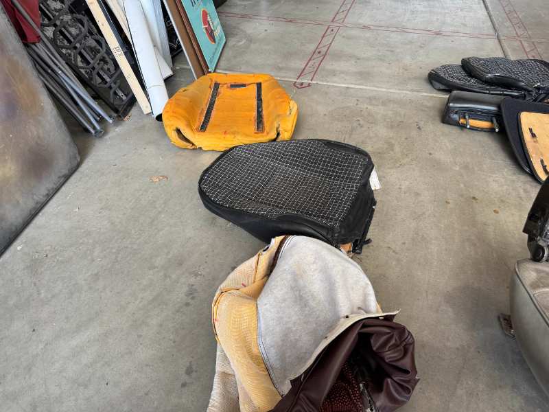

damianriel Posted May 23 Author Share Posted May 23 A few days after getting everything unpacked I did decide to try and get something done on the truck only for it to blow up in my face. When I bought the black interior back years ago I got seat upholstery. I decided to swap the upholstery onto the seat frames I got about a year ago. This is when I learned that the upholstery from a 4 door XJ seat would not fit the MJ/2d XJ seat frames. Back to the drawing board with that one I guess. I may just sell the seat frames, brackets, and upholstery separate, and throw some Corbeau GTS II's or something in the truck. Or I can see about taking my seats to an upholstery shop, but I think I'll need new seat foam and every one I've ever taken from a JY was torn in one way or another, I've read a good upholstery shop can remake foam, or at least close enough, but I've got 0 experience with that and I can't imagine there's too many "good" upholstery shops left. Link to comment Share on other sites More sharing options...
watchamakalit Posted May 23 Share Posted May 23 The upholstery should all interchange between bucket seats. I have 4 door xj upholstery with MJ seats in my truck. What part were you having trouble fitting? Edit: I almost forgot to say, the base cushions are interchangeable from xj passenger seats. Much better chance of finding a good passenger base, then just swap the upholstery. Link to comment Share on other sites More sharing options...
damianriel Posted May 23 Author Share Posted May 23 3 hours ago, watchamakalit said: The upholstery should all interchange between bucket seats. I have 4 door xj upholstery with MJ seats in my truck. What part were you having trouble fitting? Edit: I almost forgot to say, the base cushions are interchangeable from xj passenger seats. Much better chance of finding a good passenger base, then just swap the upholstery. I'm aware the foam is the same. The back rest portion is not cut the same at the bottom of the cover to allow for the tilt mechanism. After work today I'll take some pictures. Link to comment Share on other sites More sharing options...
fiatslug87 Posted May 23 Share Posted May 23 You can still get them to work. I zip tied them to the frame and the flap just hangs there. Link to comment Share on other sites More sharing options...
