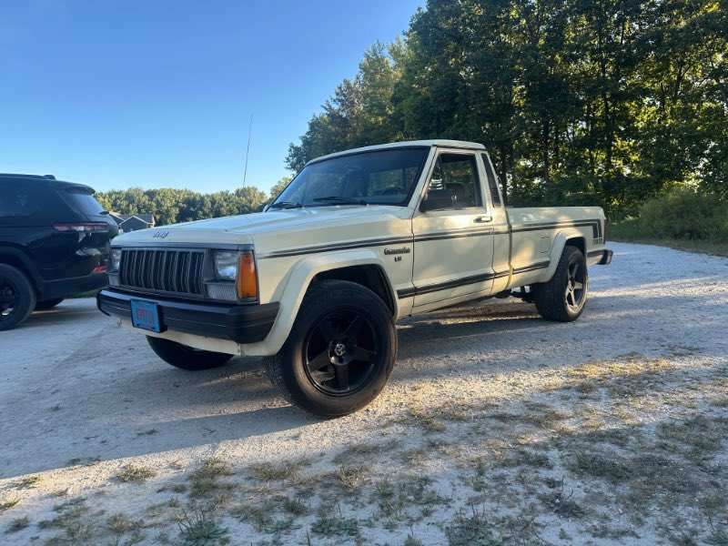

89eliminator Posted August 23, 2022 Posted August 23, 2022 Yes, i've bought another Comanche. Over the last year or so I've purchased/sold 2 other very clean MJs. Both had already been modified by the previous owners and I realized that I much prefer to have a clean slate to start a build with to put my own touches on. I saw this new one posted on a Comanche facebook page. Was only 4 hours from me and the deal was way too good to pass up. I am now the owner of an 88 4.0/auto Pioneer longbed. It has a dana 44 rear with heavy duty leaf springs. Full power interior, bucket seats, and best of all absolutely zero rust. This will be a slow build but my plans are a slight lift and keep it my street ride.

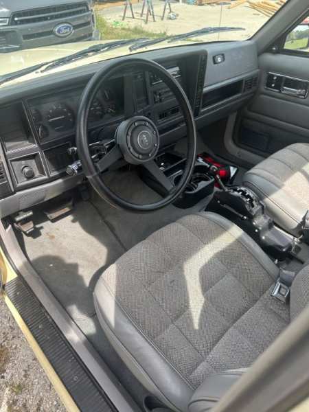

89eliminator Posted April 18, 2023 Author Posted April 18, 2023 Making slow progress as of late Due to clearance with the steering box and LS power steering pump along with the overall alternator height, I picked up some brackets to relocate all of that. Pump is sucked in closer to the engine centerline and the alternator is much lower. I also picked up a winters sidewinder shifter. Biggest remaining puzzle piece is the harness.
ThatJeepGuy Posted April 19, 2023 Posted April 19, 2023 Love the sidewinder shifter. There was a ratchet shifter in my orange truck when I got it home, the winters is absolutely preffered. The side to side for each gate takes a little getting used too but no hesitations on going this route again. Are you going to integrate the LS with the factory cluster, custom gauges, dual computer setup and retain factory cluster, holley terminator setup? Also are you going to retain the older body or go to newer body and dash setup?
89eliminator Posted April 19, 2023 Author Posted April 19, 2023 2 hours ago, ThatJeepGuy said: Love the sidewinder shifter. There was a ratchet shifter in my orange truck when I got it home, the winters is absolutely preffered. The side to side for each gate takes a little getting used too but no hesitations on going this route again. Are you going to integrate the LS with the factory cluster, custom gauges, dual computer setup and retain factory cluster, holley terminator setup? Also are you going to retain the older body or go to newer body and dash setup? glad to hear. i've heard a bunch of people say the sidewinder is awesome. my first plan was the terminator max, until i found out the lead times on actually buying one. truthfully i havent put much thought into the gauge side of things. i am keeping the body as is.

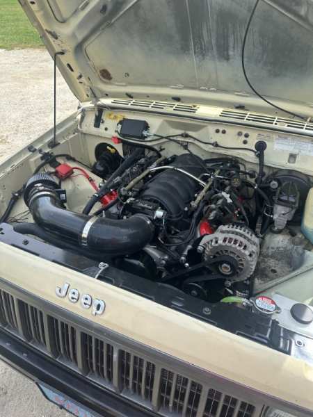

89eliminator Posted July 11, 2023 Author Posted July 11, 2023 Motor is in. Yes the intake is temporary lol. Also purchased a Holley Terminator X Max. My wallet hates me.

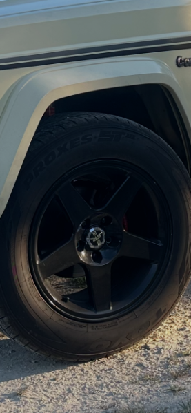

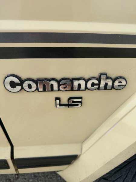

89eliminator Posted 2 hours ago Author Posted 2 hours ago Over 3 years later and a change of hands, this is done. Best part is it’s still in the family. I ran out of time and energy to ever complete this, but my newly retired dad and his need of a winter project came just in time. He was able to take what I started and finish it out. Came out really clean and it runs great. Found badges off a car in the junkyard that mimic the Comanche ones yet give a subtle hint to what’s under the hood.
