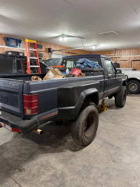

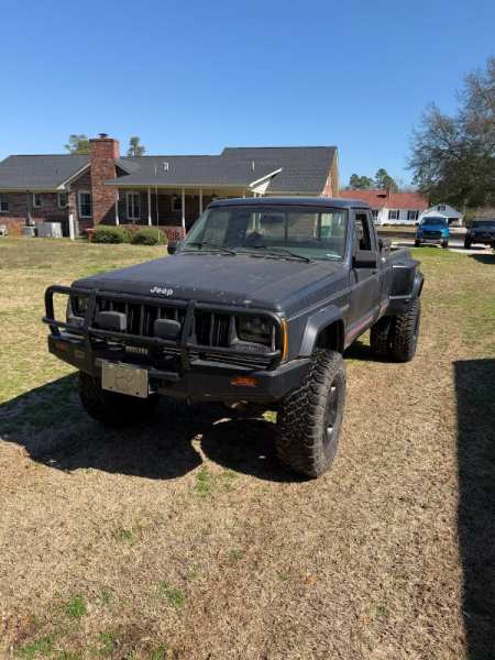

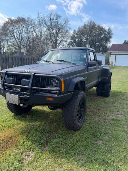

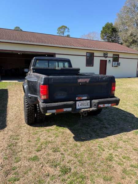

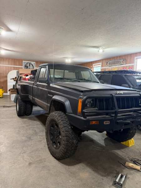

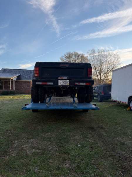

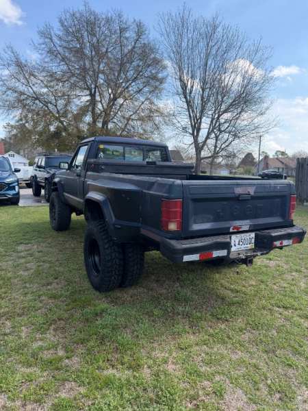

88mjsally Posted February 21 Author Share Posted February 21 It’s changed a little in three years….. Link to comment Share on other sites More sharing options...
neohic Posted February 22 Share Posted February 22 You know we need more information. Link to comment Share on other sites More sharing options...
89 MJ Posted February 22 Share Posted February 22 That’s awesome! Link to comment Share on other sites More sharing options...

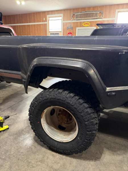

watchamakalit Posted February 22 Share Posted February 22 Is that one of the old JCWhitney dually kits? I think it looks awesome. More info please. Link to comment Share on other sites More sharing options...
Gjeep Posted February 22 Share Posted February 22 Looks great Link to comment Share on other sites More sharing options...

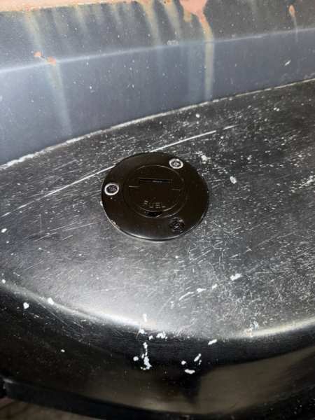

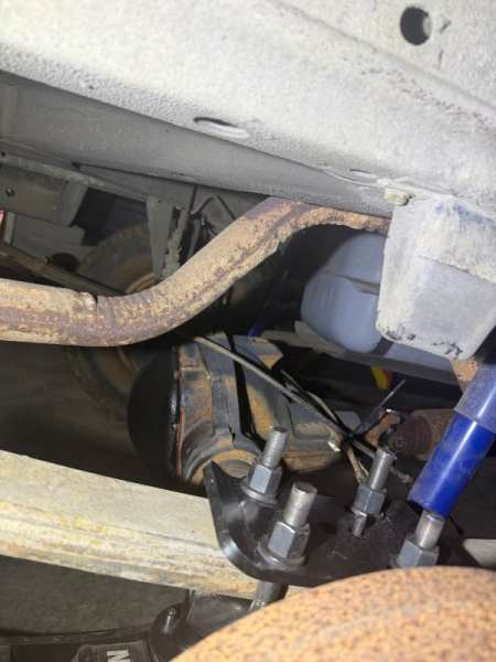

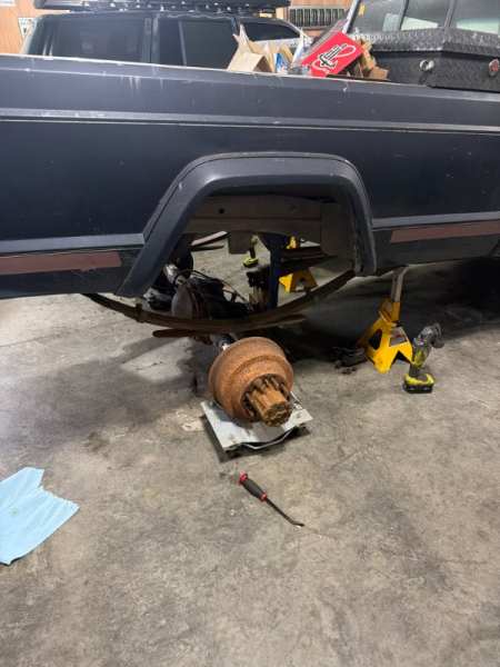

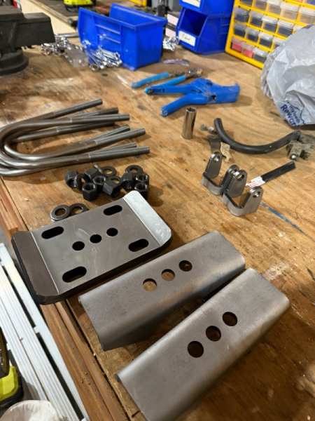

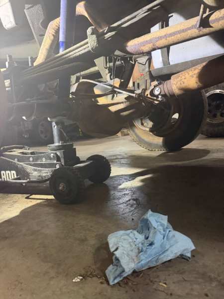

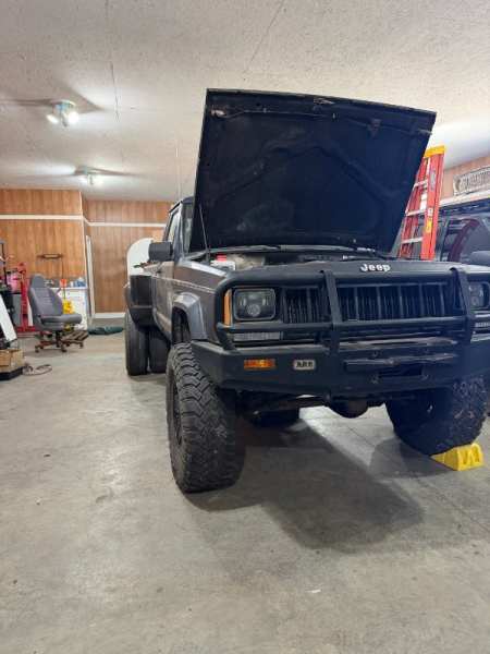

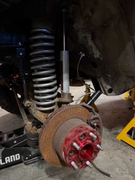

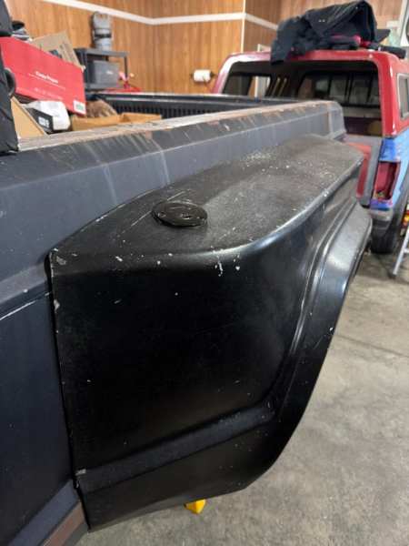

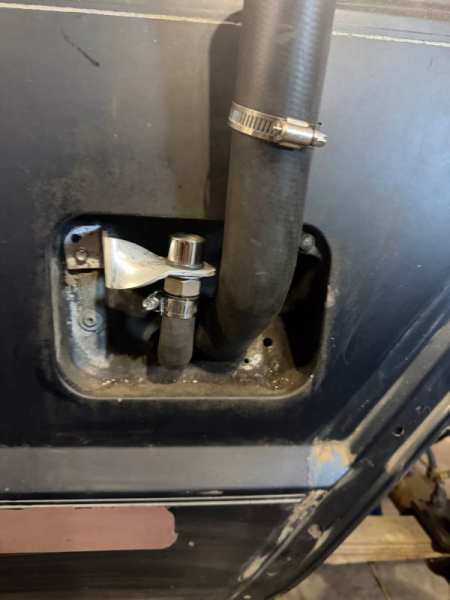

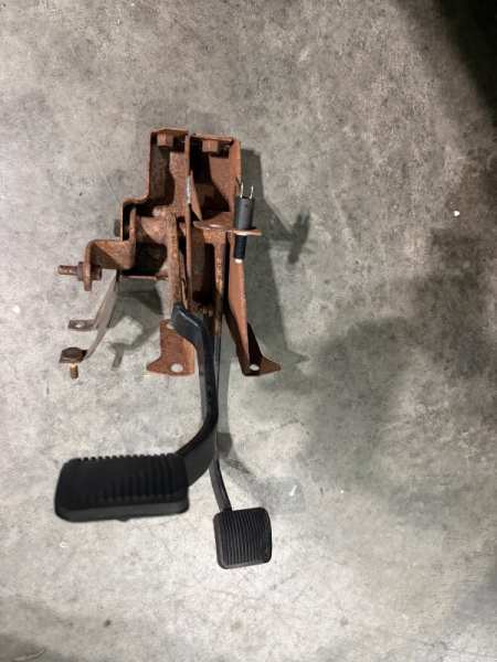

88mjsally Posted February 22 Author Share Posted February 22 Probably easier to do this as a list of the parts I used since it’s not really a kit other than the fenders. Rear axle: sterling cab and chassis 10.5 from a 1995 ford f-350 7.3 dually Front axle: Dana 30 hp from a 1996 Jeep Cherokee. Front suspension: rough country 4.5” springs shocks and lower control arms. IRO adjustable track bar and rough country extended brake lines Rear suspension: stock mj springs and shocks with Barnes 4wd perches welded to the 10.5 spring over. Dually fenders: came out of Florida from a truck that was getting parted out. Unsure if they are JC Whitney or something else but they are for sure mj specific. Someone did fill in the fuel door so I used boat parts to add one back in. Front Bumper: arb from a 97-01 xj with a 12k badlands winch installed in it Wheels and tires: front wheels are from a newer jk with adapters. Rear wheels are just stock steelies with new but cheap mud tires. Brakes: 95-96 xj booster and master plumbed to mostly original lines with the rear prop valve deleted. I used a 91-96 xj brake pedal so I didn’t have to try to grind on the rod from the booster. that’s most of the details and I added all the pics I took so far. Eventual plans involve removing the worn out 4.0 and replacing it with a 5.3 lm7 and 4wd ax15 Link to comment Share on other sites More sharing options...

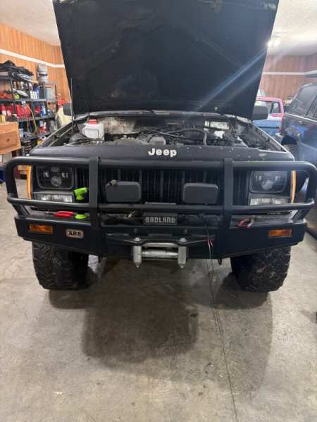

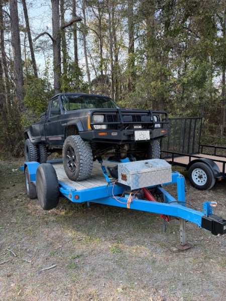

88mjsally Posted February 23 Author Share Posted February 23 I got the ROL fog lights wired up over the weekend and installed a 12k winch I had from a parts jeep in the bumper. Also fixed the blinker issues I was having and put in all new LED bulbs Link to comment Share on other sites More sharing options...

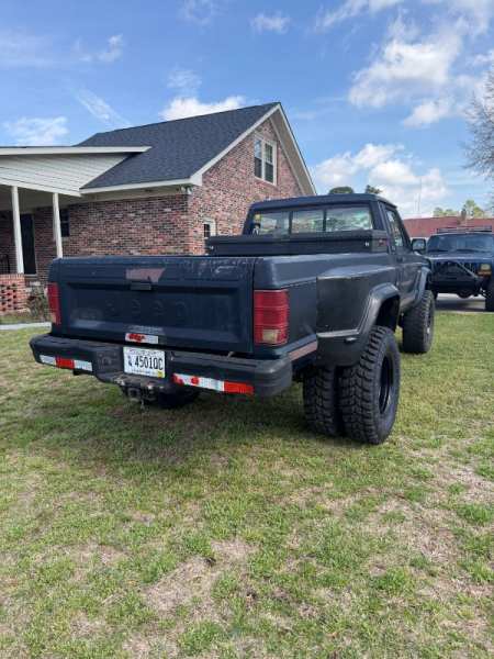

88mjsally Posted February 25 Author Share Posted February 25 Got some marker lights installed on the fenders. I don’t like drilling holes in impossible to find parts but I wanted them for safety and they make it look like a true dually Link to comment Share on other sites More sharing options...

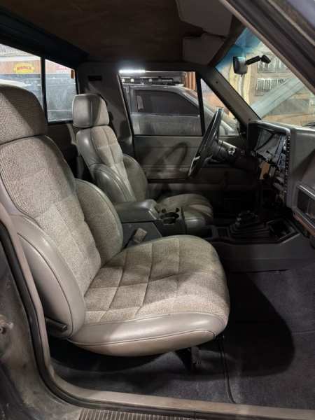

88mjsally Posted March 3 Author Share Posted March 3 Got the interior looking better with some xj buckets and a console to replace the well worn bench Link to comment Share on other sites More sharing options...

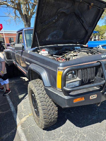

88mjsally Posted March 8 Author Share Posted March 8 Crispy got a bath today and a reman steering box yesterday. Did a tape measure alignment and adjusted the rear brakes so almost ready to go to a car show in about a week and a half Link to comment Share on other sites More sharing options...
