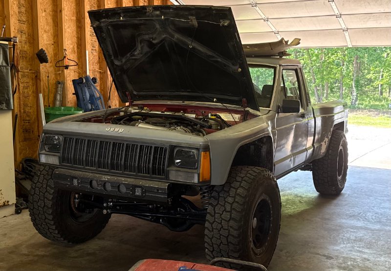

Comanche SS Posted July 4, 2018 Author Posted July 4, 2018 Day one with this truck went well, drove it around a ton. Picked up rims, ordered tires, went with 33 grabbers instead. Ordered the currie sway bar, ordered all metalcoak adjustable control arms, and some coil spacers until I decide if I want the acos with rubber bump stops or the full hydraulic setup. I got the wrong rear flares so calling hanneman tomorrow to get the correct rear bedsides. Met with a painter and finalized a paint scheme. Will match the race car I will be chasing in the baja races for. Once again, this is not a prerunner, its a daily thatll sometimes off road, go fast, or chase for the 500-1000 mile off road races. Its a do-it-all truck.

Comanche SS Posted July 9, 2018 Author Posted July 9, 2018 Metalcloak control arms, currie track bar, and tires are here! Waiting on the jks acos spacers, the antirock sway bar, and the remainder of the fiberglass Sent from my SM-G955U using Tapatalk

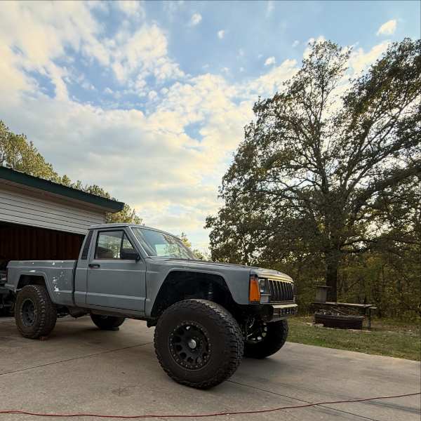

Comanche SS Posted July 12, 2018 Author Posted July 12, 2018 I'll start this by saying, I gave a good effort to keep this bed in good shape and let someone who needed it have it, literally for free. Not ONE person contacted me. I gave it until I couldn't wait anymore, and it's my truck anyway, this truck was for sale for awhile so anyone coulda bought it before me and restore it to original. Nobody did so I am making it my way because it's my truck. If you hate it, move along, it's not for everyone's taste it's for mine.I mounted the front and rear fiberglass today, fitment was pretty good all around. All in all took about 8 hours, and I coulda done it faster but u wanted to cut the steel besides off in a clean enough way so someone can use them as good patch panels.Mounted my 33*12.5*15 tires and rims as well. I love how wide it sits, it looks great in person.The front is sitting a little low still because I ran out of daylight to do my suspension work. So this weekend I'll be installing the jks acos, currie antirock, metalcloak arms, brake lines, and currie track bar.I didn't get time to buff, sand, or paint the besides today so there are still a couple rough edges that need to be gone over. Inner fender mounts need to be added.With these tires and track width plus a low center of gravity this truck handles nothing short of amazing. No under steer, no over steer. Light truck with big rubber patch is a whole lot of fun! Sent from my SM-G955U using Tapatalk

Comanche SS Posted July 18, 2018 Author Posted July 18, 2018 Got the front end suspension done, all that's left is installing the ene track bar once I rebuild the joints. And installing the rear shocks. Paint, bucket seats, and harnesses are the next small upgrades while in the meantime I search for a donor engine to swap in. May do a v8, unsure yet. But front end handles amazing, floats over big bumps and potholes. Hopefully taking it out on some trails this weekend! Sent from my SM-G955U using Tapatalk
