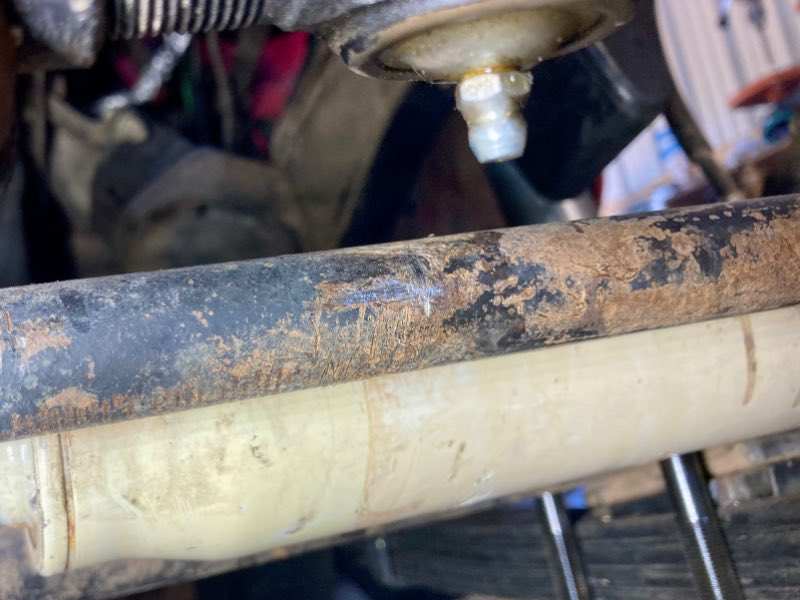

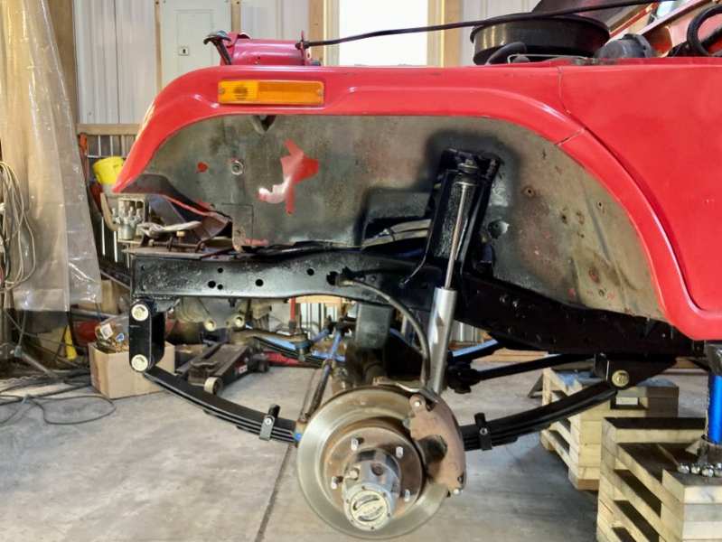

I’m such an idiot. Yesterday I was wrapping everything up for the day thinking, “sure will be nice to finish up the front end in an hour or so!” Then this morning happened. I got into the shop, started throwing hardware at it, and it was great!
… and then, “hu… is that scratch new?”

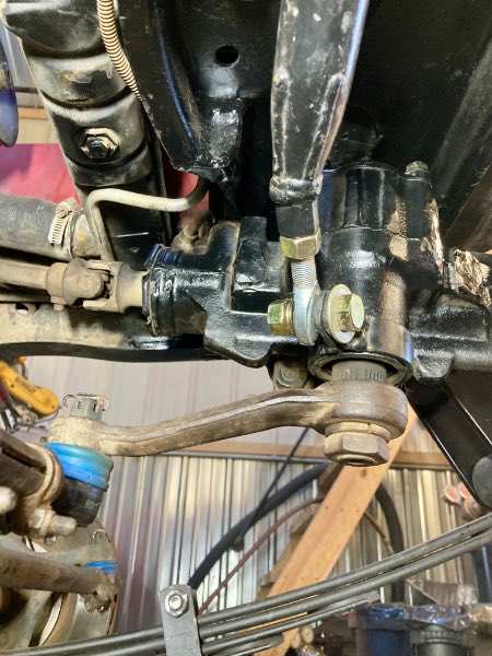

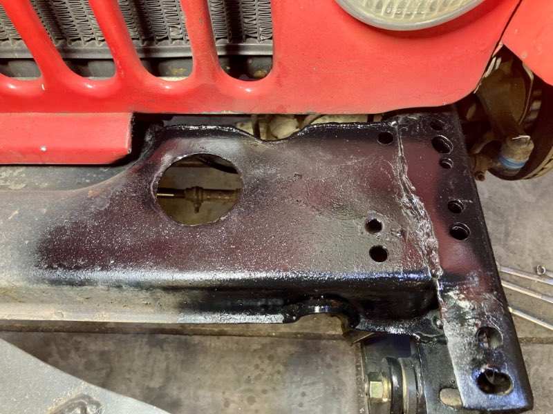

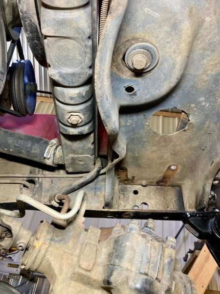

It sure was! At full compression the pitman arm was crashing into the tie rod. Not much… but enough to bend the tie rod slightly while turning at full stuff. Then comes in the total idiot part when I thought I could get away with drilling a few new holes and move the steering box forward. :nuts:

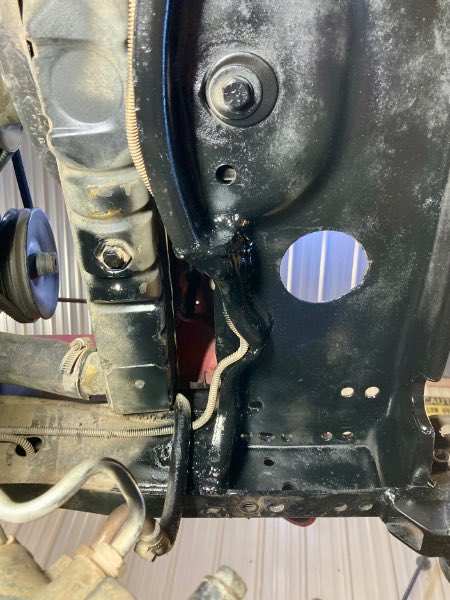

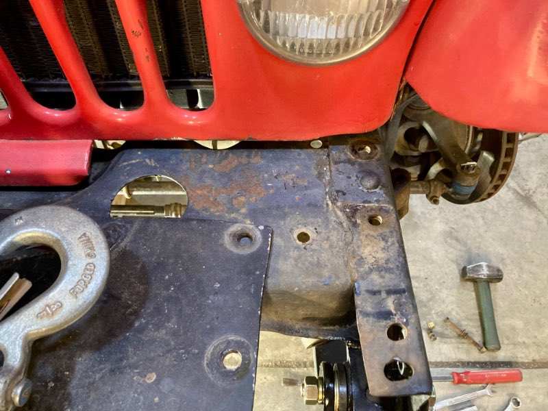

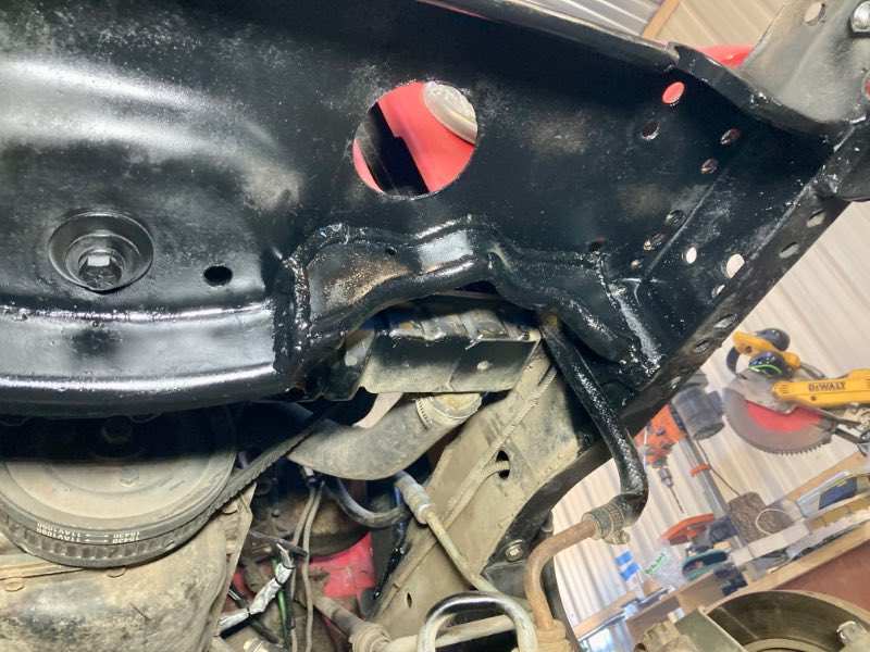

Yup… I ended up needing to cut the crossmember, move the goofy shaped rear leg forward that fits fairly tight around the steering box, weld it all back together, add some new reinforcements, AND THEN I could drill some new holes to move the steering box forward.
I put a little extension on the back of the winch plate to tie in all of the steering box mount hardware while I was at it. It was missing one of the bolts towards the center this whole time too. The final result after an entire day in the shop?
… plenty of room between the pitman arm and the tie rod. :fistshake2:
Then I took it out of the shop to turn it around to get the shop ready for starting the rear. Sits pretty good.

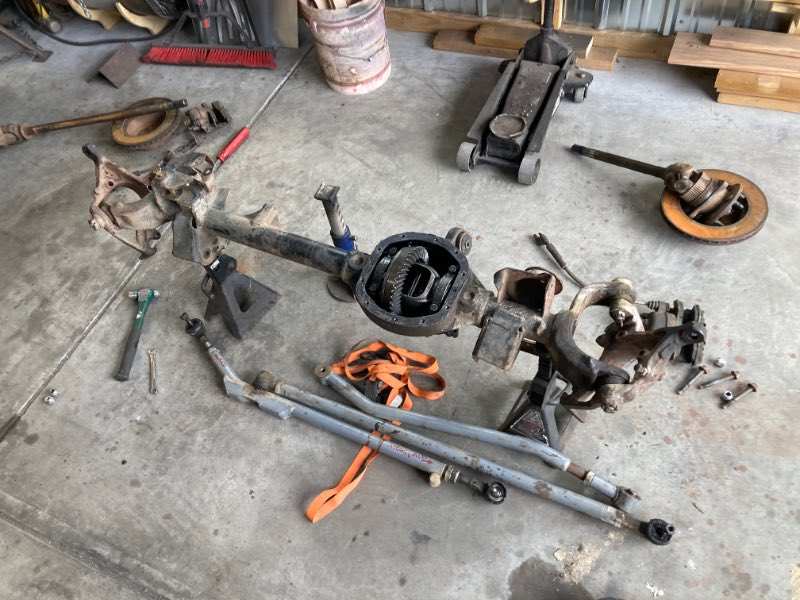

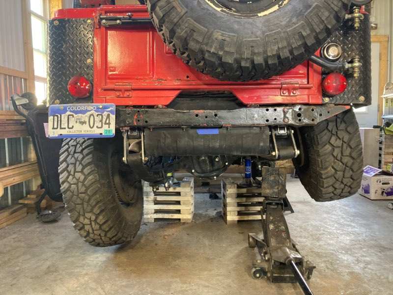

Rise and repeat. The CJ got turned around to start looking at the rear suspension today.

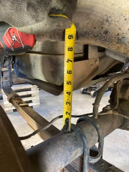

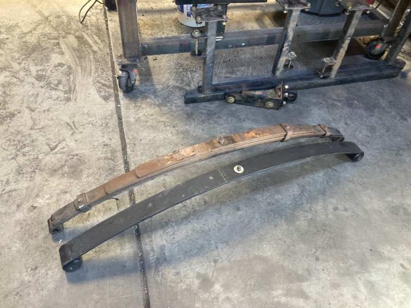

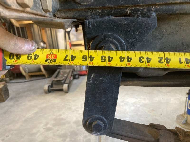

Didn't get too far into it. More so just measuring and making a plan. I hadn’t put a tape measure to anything in the rear before and finding that it currently has longer springs than a YJ really surprised me.

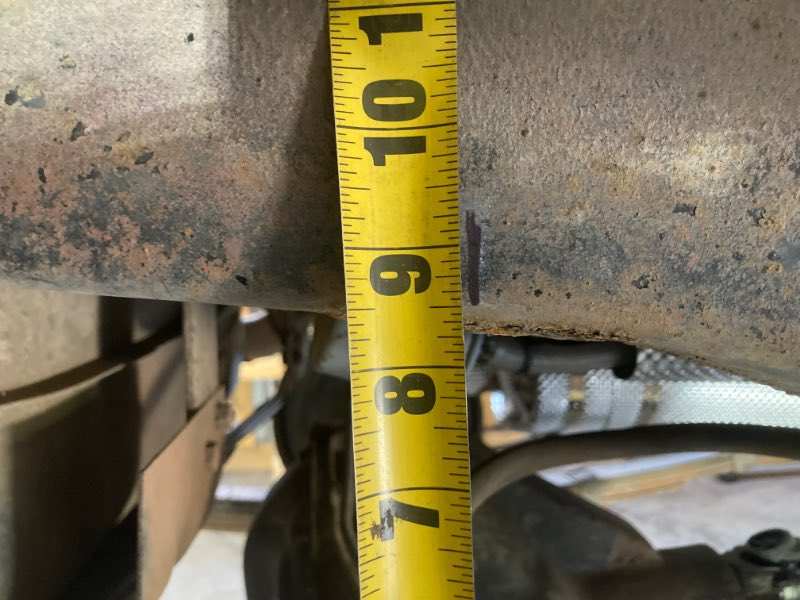

Stock YJ spring mounts are 43” eye to eye where this is 45”. Noted. Other measurements I took is the ride height from the top of the axle to the bottom of the frame, same as the front, just for reference.

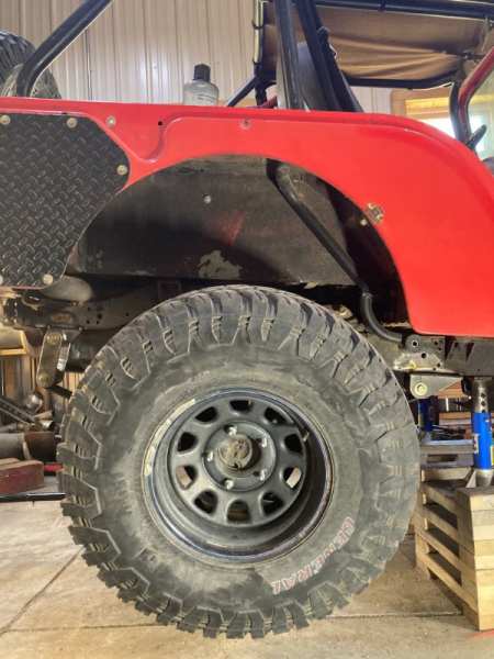

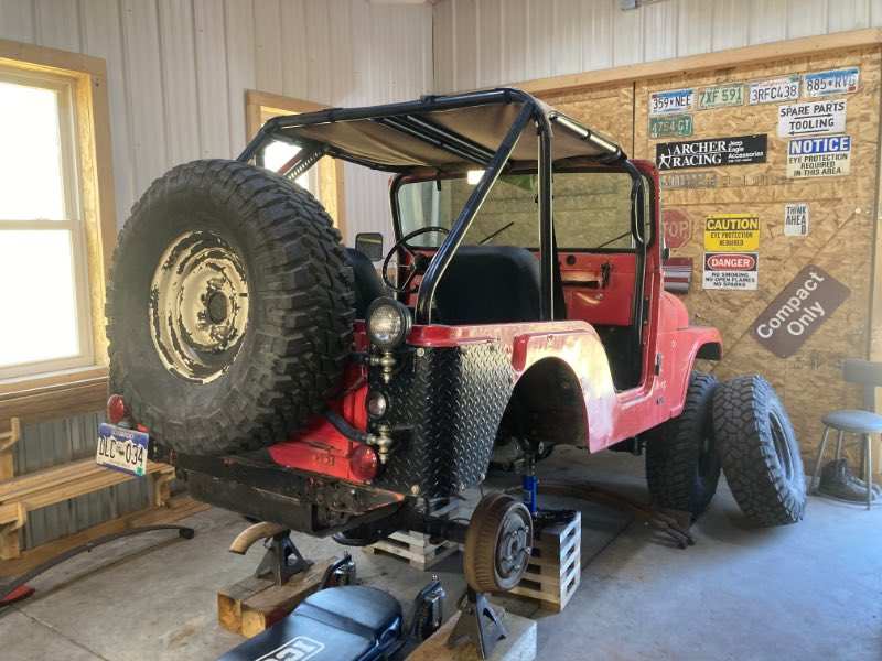

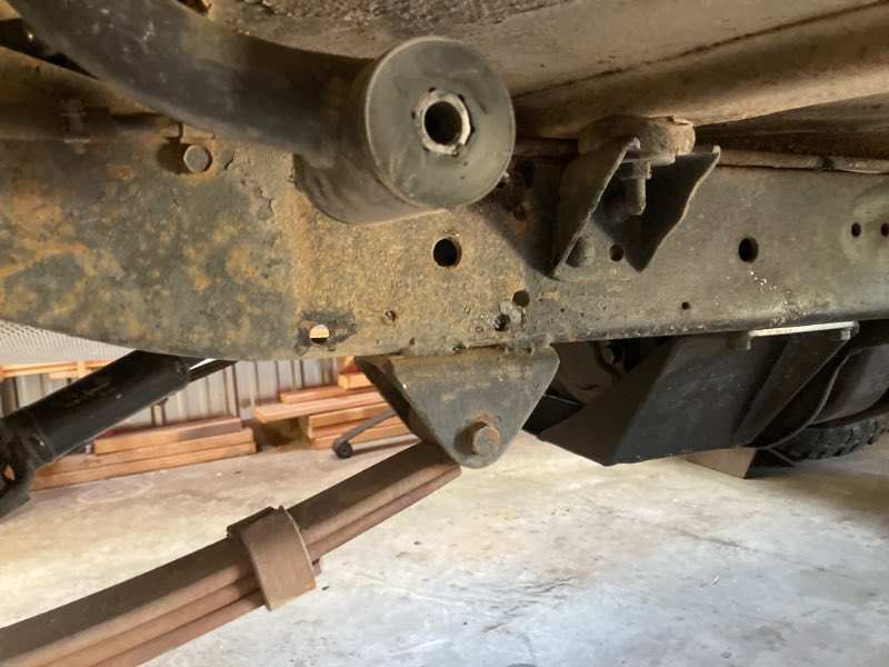

Then the more I looked at things the more I noticed things in the way. The rock sliders, rear recovery point, and exhaust had to go.
Everything came apart nicely. When I was originally making it all I tried to keep in mind fastener location. Thanks, past me! Before taking anything else apart, I found the center of the axle and measured out where the future mounts will end up.
The rear axle is centered on the springs same as the YJ layout. Super easy math being I’m not moving the axle. It was getting close to the end of my day and I was dangerously close to starting a new, giant mess so I called it quits after removing the suspension.

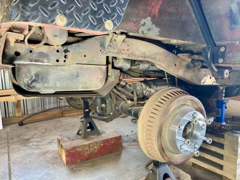

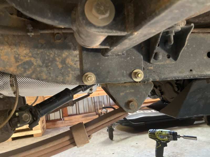

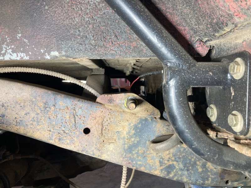

I took the weekend off from CJ things. Back on to the rear today though. All of the brackets came off just as easy as the fronts, however I will forever be (rightfully) skittish using a torch around a fuel tank.

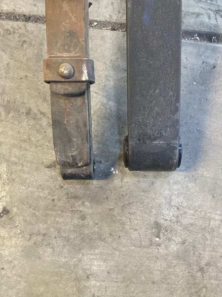

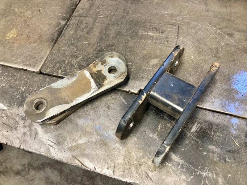

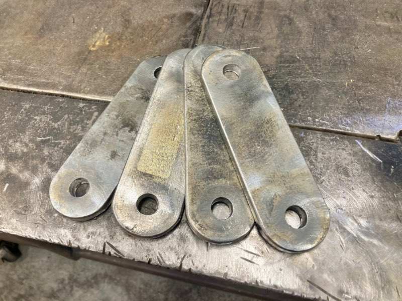

For the rear shackles, I reused the old ones but cut out the center stiffener and drilled them out for 9/16” hardware.

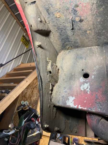

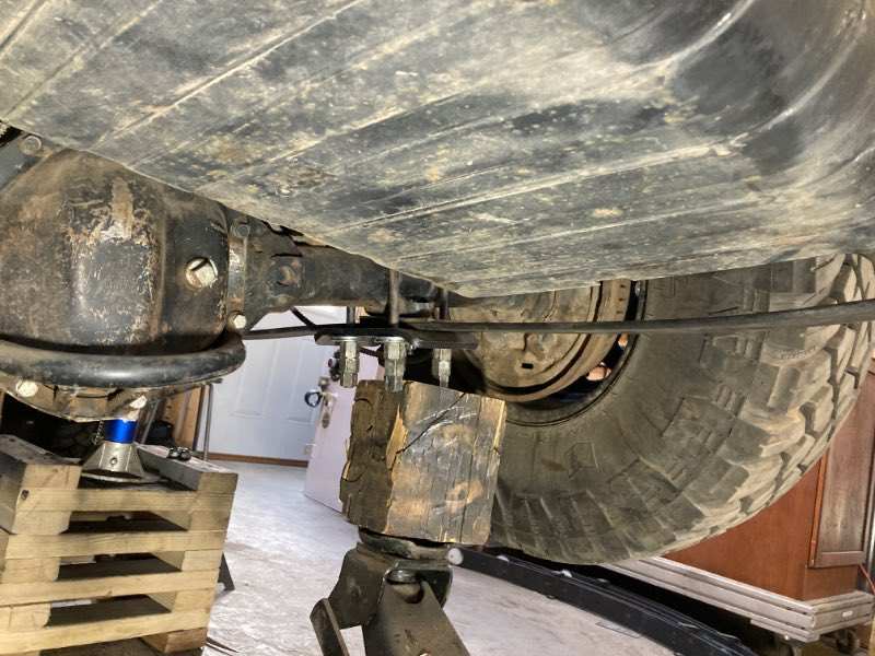

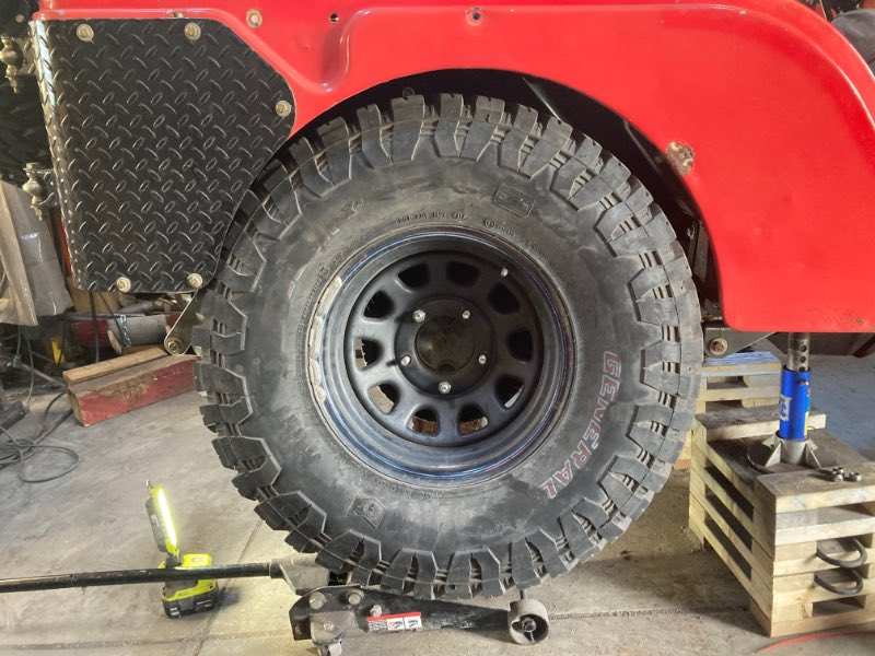

Bump stop measurements went the same as the fronts too. The axle got jacked up until the majority of the spring was flat and everything else was set from there. I did notice that the rear has some flex steer that pushes the axle towards the rear. The body/inner fender got trimmed for a little more clearance.

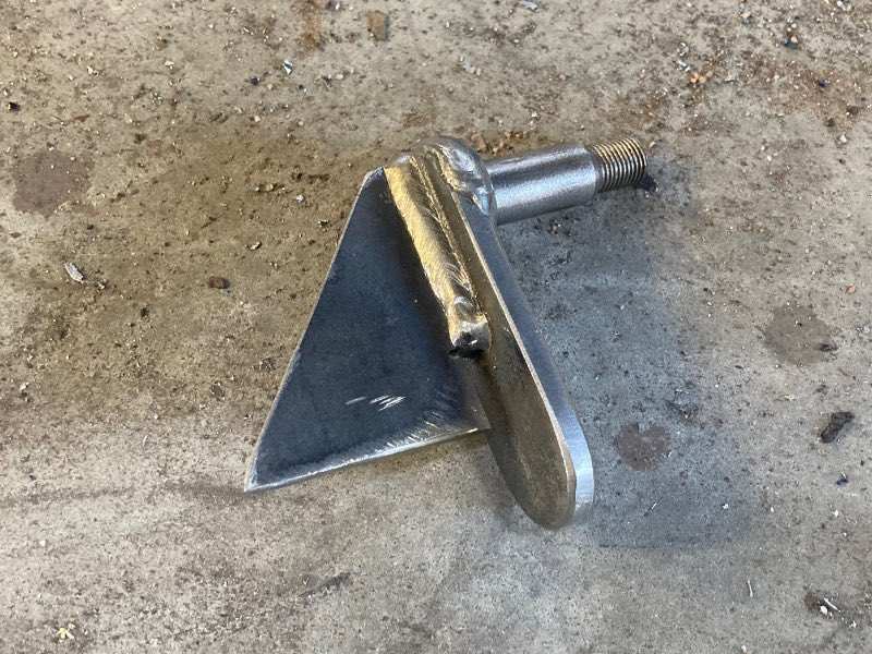

We’ll call it rust removal. There’s plenty of room for shocks in the rear compared to the front, but I didn’t like how the factory upper mount would’ve made the shock hang down if I had kept it like originally planned. The pocket the upper mount lives in between the frame and the body leaves enough room to push it up some.
The pinch seam got a little notch in it similar to how early Broncos do to get the shocks higher. Otherwise, the lower mount is just a stud welded to the spring plate.

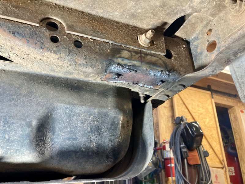

One week YJ swap is done! Heavy tacks went over everything so I could put the CJ on its own weight. Lower shock mounts were wrapped up too.
Currently, ride height is slightly lower but pretty much the same. With the wheel spacers on, the rear hub to hub width is now 54.5” and the front is 56.25”. Wheelbase is a WHOPPING 84.5”!! The last parts that needed to get made were the inner frame plating for above the spring mounts, and then a bunch of welding. Nice to get things wrapped up with paint and assembly!

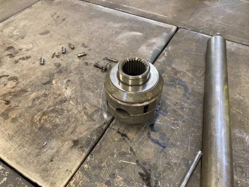

Today started with some other shop stuff and then it dawned on me that I had a set of axles sitting under my carport that one had a 27 spline locker in it. :idea:
The axles I’ve got are from the Jim Oshel Edition ‘86. Prior to that, these axles were in my old XJ. PRIOR prior to that, they were from another wheeler XJ in Minnesota. Lots of miles on these things and it’s crazy that I ended up with them again. As for the locker itself, I would’ve put that in the axle when it was under my Cherokee WAY back (11? 12 years ago?) when it was 1000 miles away in another state. These axles are really like the car part equivalent to getting anti seize on your forearm… just keeps coming back around. :laugh:
As for moving that little Aussie locker to the CJ, I found a bunch of junk along the way. Sure… it had fluid in it… but anytime I’ve ever thought about the front axle it was typically right before heading off somewhere and it was very much, “Yup! Theres fluid on it!” and that was that. I found a near milkshake of very watery fluid and some wasted u-joints. Not completely horrible?… not awesome though. It all came apart easy and right back together with new joints. It even got a fancy 3/8” cover thats been kicking around in my parts pile for years. Had to flip around the steering stabilizer to make everything fit happily.
What I need to do yet is add a way longer vent line. So, anyway… I wasn’t planning on putting a locker in the CJ today… but… here we are. :dunno:

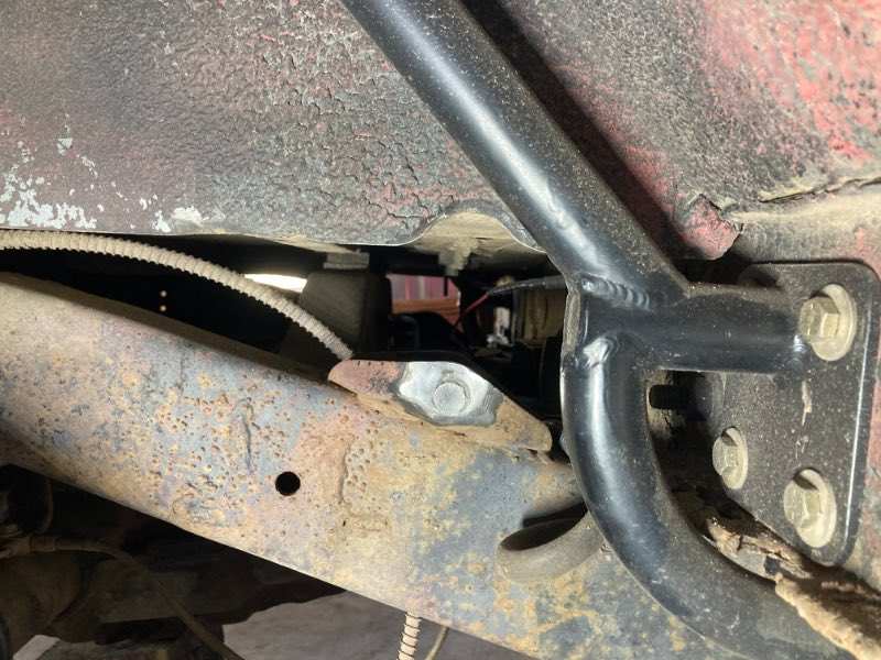

With the suspension now done, I was waiting to move it until all of the welding around the new spring hanger was complete. I also rerouted the fuel hardline. It was originally run along the top of the frame and was coming in contact with the bottom of the tub from the now collapsed rubber body mounts. The tub is where it’s going to be with how I did my sliders and tied into the cage, so moving the fuel line was to help out future me.
