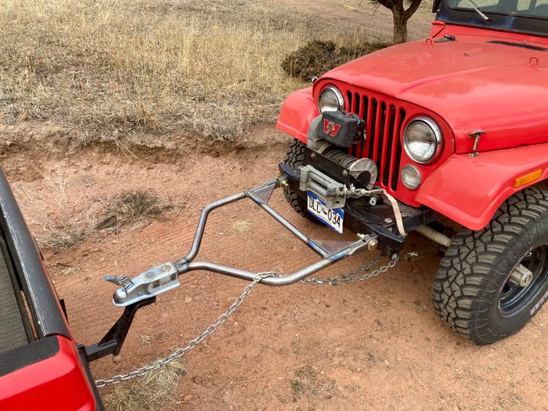

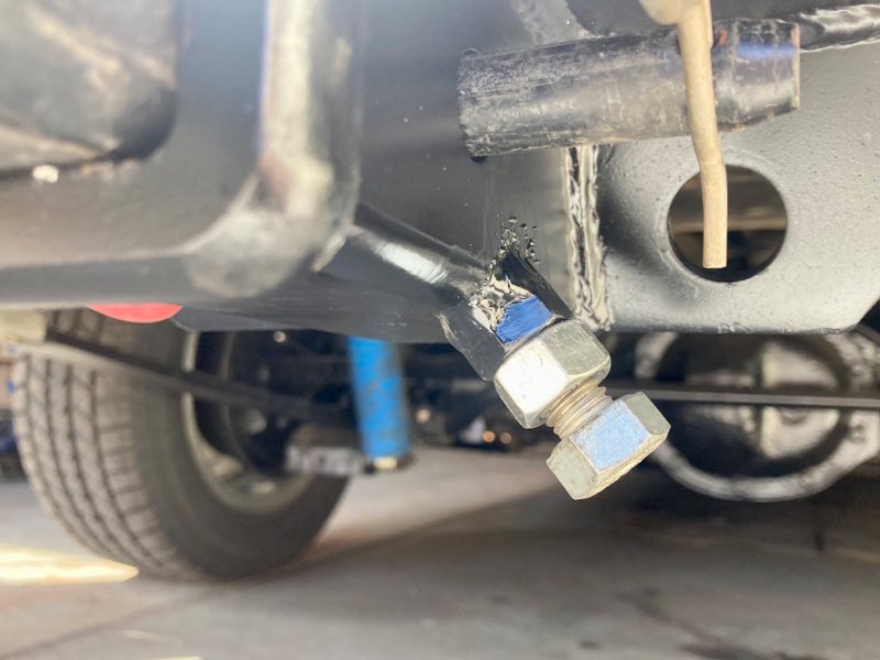

More Moab prep today. I was hoping to tug it around with the Eliminator but I ran out of time before the weather started to turn and the power went out. In preparation to match up with the tow bar, I’m trying to get rid of as much wiggle and rattles as possible. That started on the truck side. I added a big set screw on the bottom corner of the receiver to keep the draw bar from knocking around.
It’s just a 1/2” bolt and nut. There’s another nut welded to the receiver. Then the top came off the CJ because it’s always easier to get motivated on CJ projects after the top comes off. :L: Along the way, as things came off that are in the way of getting the top off, they just went in the bed of the truck.
Ballast! :applause:
The steering got all new tie rod ends and the radiator got new hoses. What I found when I was crawling around under the Jeep was a big ol’ crack in the frame behind the front crossmember and the steering box had just a little play at full lock. The play turned out to be the left side frame rail twisting. I didn’t have making a steering box on my bingo card for the day. :fistshake2:
I might readdress this in the future (which means I’ll probably never do anything else with it). It’s made of junk that I had around and I’m not super crazy about the 1/2” heim but it made a huge difference! There’s just a plate on the right frame rail under the winch plate tying it all together.

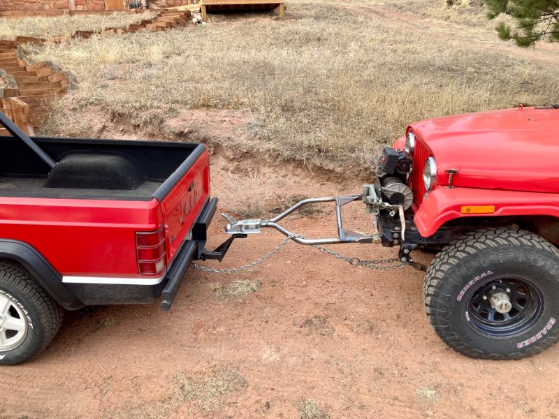

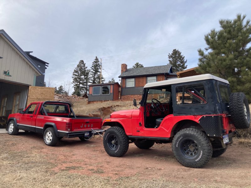

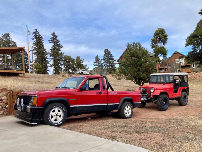

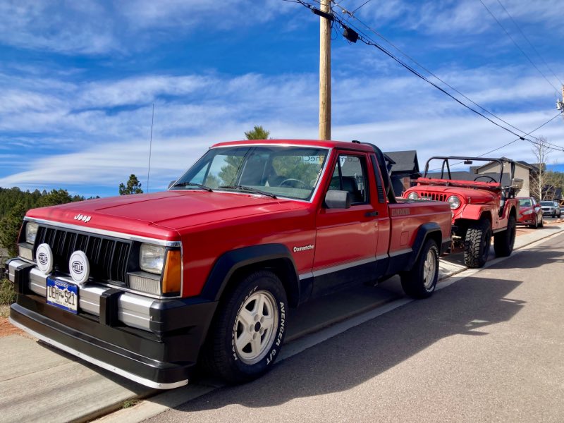

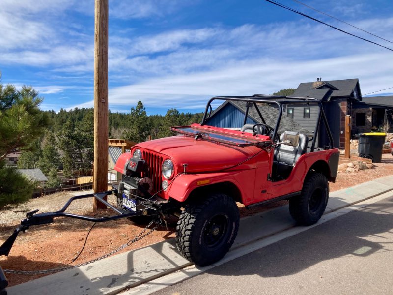

Test tow day!
… it didn’t go well… but that’s okay! I had high hopes but, in the back of my head, I quietly had my doubts. Around town, things went great! I took it for a drive up to 55mph that went around a bunch of curves and hills. 55-60 felt just about right. The truck did okay as far as temperatures and even power. A little more oomph would be nice. Unfortunately where things just didn’t feel right was in the brakes. We all saw that coming!… again, that’s okay. After a couple practice emergency stops and then one final hard stop going downhill I lost faith in the brakes. They got hot and smelly.
I’m sure I could get some brakes figured, but realistically I’m running out of time. Maybe U Haul is the next move?

Ok, I can’t lie, that’s an incredibly beautiful sight there. Now I’m a little disappointed it didn’t work out.
uhaul is a good idea, anything they have should easily do it.  although that $1 per mile is painful :(
Same. :dry: But… I’m still going. Stay tuned for more beautiful sights from Moab. :L:
14 minutes ago, fiatslug87 said:
That picture makes the CJ look huge!
RIGHT?! Unfortunately the final straw was the mass of the CJ. Everything was stripped off and out of it but it still wasn’t enough. Failure is always an option. :fistshake2:

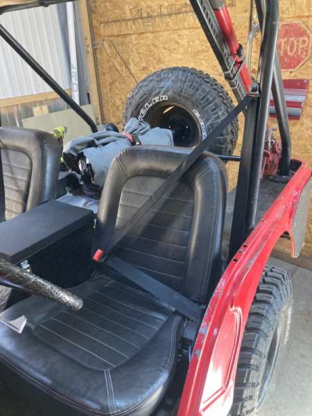

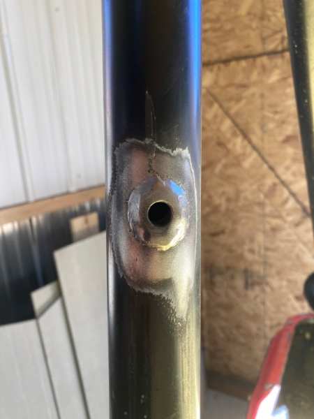

More work today. The three point seat belts got installed. These are “Jeep Wrangler” aftermarket but they could really go in just about anything. I had to weld a bung into the main hoop, but otherwise they just bolted in place of where the lap belts were.

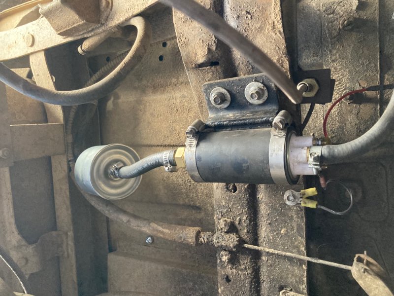

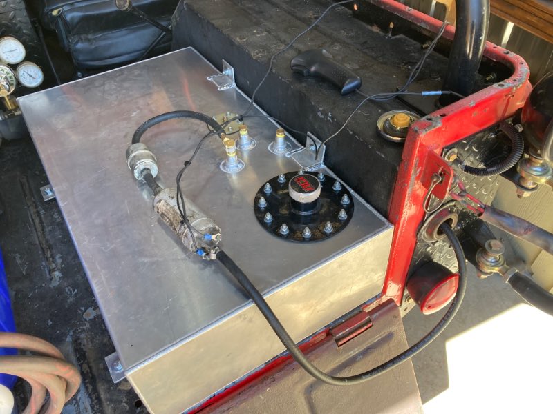

Then I moved onto the fuel system. There’s really nothing wrong with it, but the pump has been loud since it went in there. I went back to the parts list from when I pieced together a Howell setup for a friend’s YJ a while back and just used that part number.
The old pump is now the new transfer pump should I need it. It runs off of a remote starter trigger switch.
What I didn’t want to do is plumb in a permanent auxiliary tank. This way I can remove it when I want. Otherwise the punch list is down to trying to get the parking brake working, nut and bolt it, recentering the steering wheel, and check the toe again. This is a huge annoyance.
