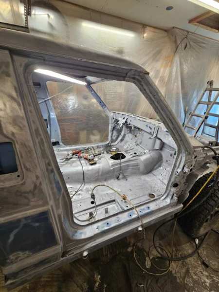

I decided to tackle a section of body work. Going to try and get the roof and cab down to just below the glass channels covered in epoxy.
Impressively, I've discovered there has been rust forming below the factory basecoat... 🙄
My dad used POR15 on the rocker panels of his 2000 Silverado plow truck. The rockers eventually rotted away anyways. We’ve started using Chassis Saver instead. It seems to work much better and is only a one part product.
