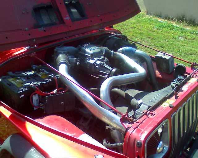

johnj92131 Posted July 8, 2014 Posted July 8, 2014 Hello What I can do to more power and more torque in lower rpm? engine 4 cyl 2.5. thanks One word: "Supercharger" You want more low end grunt, then you want a supercharger. Did not say it was cheap, but it will do more for that 2.5 4 banger than anything else. Especially big improvemet at the LOW end. Everything else you can do for the 4 banger will improve the top end, but not the low end. Now, gears will deliver more torque to the ground, but your engine will be screaming on the freeway. A big diesel engine conversion will also get you low end power in spades. But you will need $10K or so for starters.
yxmj Posted July 8, 2014 Posted July 8, 2014 Hello What I can do to more power and more torque in lower rpm? engine 4 cyl 2.5. thanks One word: "Supercharger" You want more low end grunt, then you want a supercharger. Did not say it was cheap, but it will do more for that 2.5 4 banger than anything else. Especially big improvemet at the LOW end. Everything else you can do for the 4 banger will improve the top end, but not the low end. Now, gears will deliver more torque to the ground, but your engine will be screaming on the freeway. A big diesel engine conversion will also get you low end power in spades. But you will need $10K or so for starters.
benjy_26 Posted July 9, 2014 Posted July 9, 2014 Hello What I can do to more power and more torque in lower rpm? engine 4 cyl 2.5. thanks One word: "Supercharger" You want more low end grunt, then you want a supercharger. Did not say it was cheap, but it will do more for that 2.5 4 banger than anything else. Especially big improvemet at the LOW end. Everything else you can do for the 4 banger will improve the top end, but not the low end. Now, gears will deliver more torque to the ground, but your engine will be screaming on the freeway. A big diesel engine conversion will also get you low end power in spades. But you will need $10K or so for starters. Hold the phone! Someone makes a SC for the TBI 2.5?
