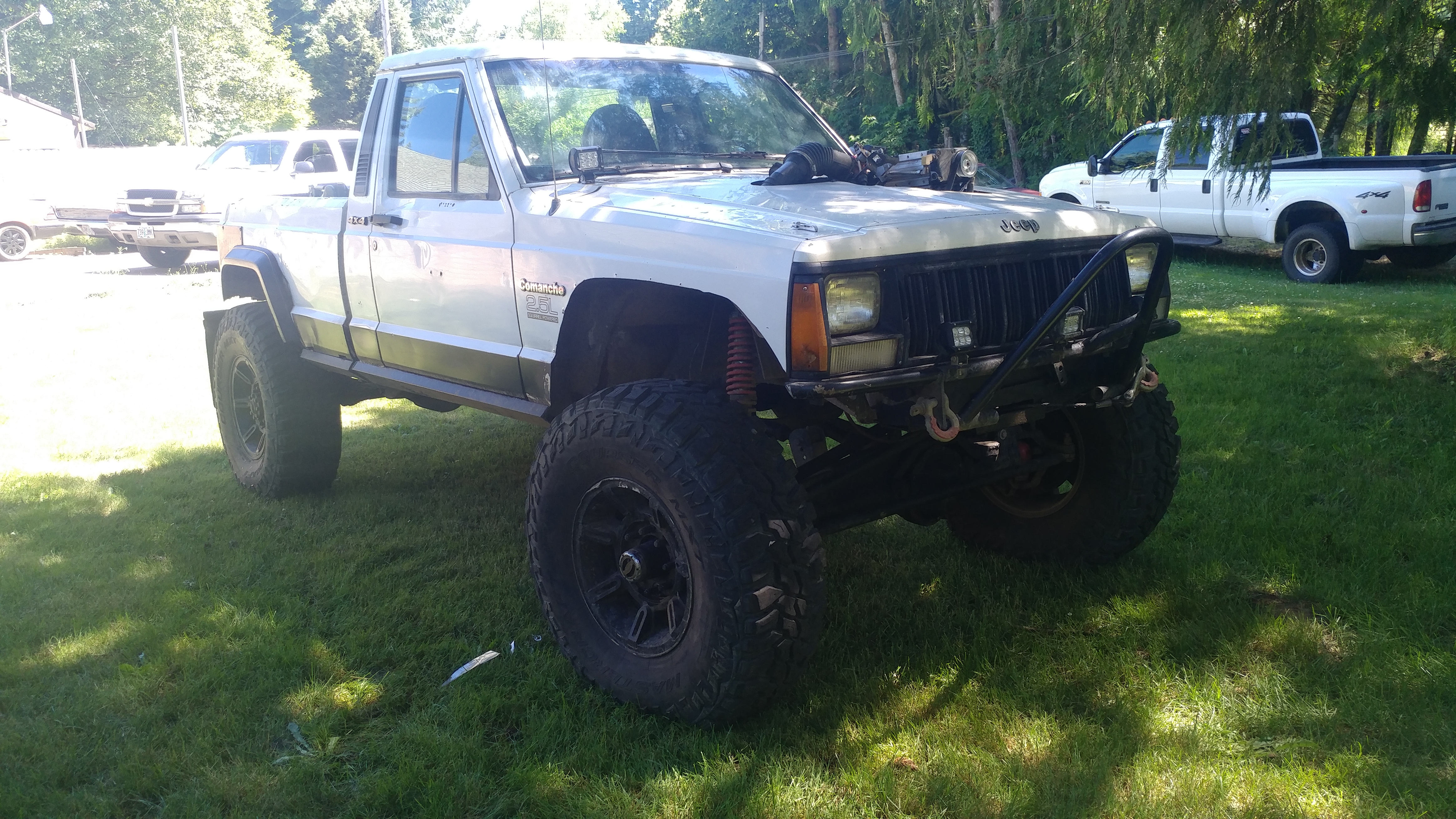

  5. As the Jeep grew, i just kept trimming away at the flares. I planned to eventually remove them but didn't get around to it till now. It looks good but different, it may take me a while to get use to it.
  6. Spent a couple hours in the garage tonight and made a sector shaft support for the MJ, it still needs a little more work to finish it, but should work pretty good.
  7. Finally got my Lincoln moved out of the garage and the MJ moved back in, tonight i decided to remove the rear flares, I've gone back and forth about it and finally decided to just start cutting. Now i have all sorts of room for activities, might have to get some 40s for it.
