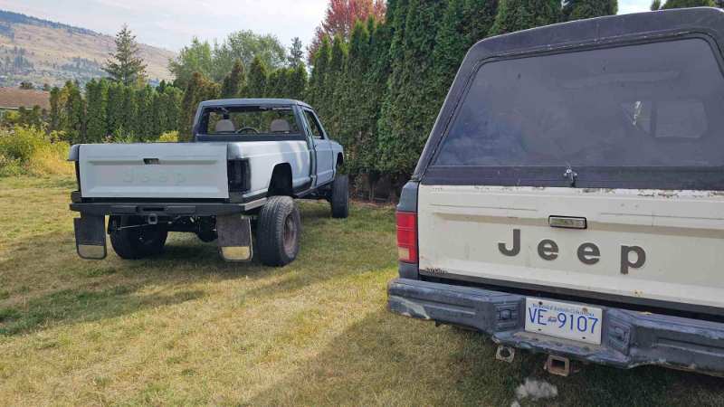

and a side by side shot of my cherokee and comanche!
