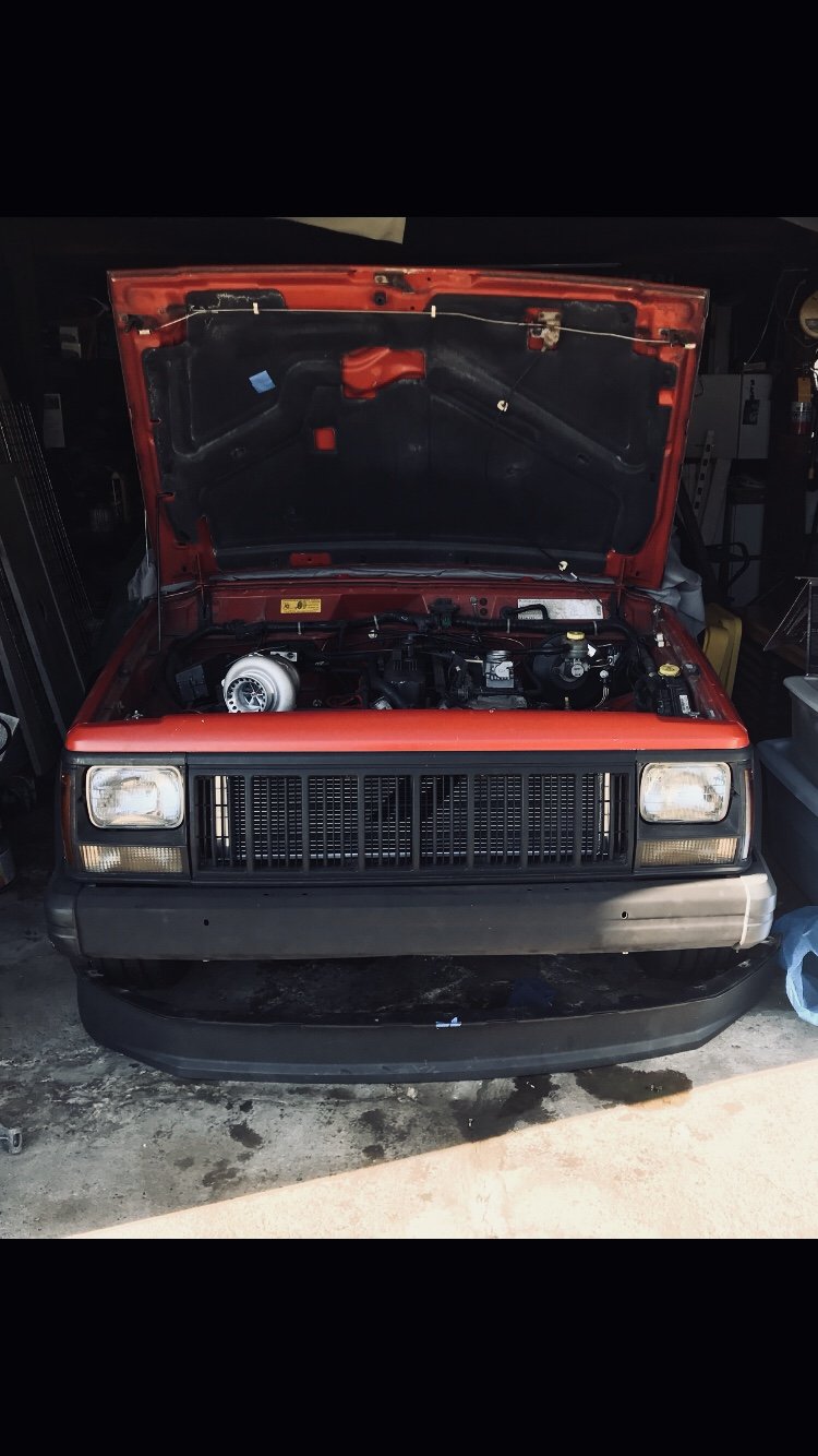

  10. It’s been awhile... Here’s a update. I still have the truck. I now have a son who is already 1.5 years old. He is the best thing in the world. But my whole life was on hold for a while. All is well now, but he had to have 2 surgeries before he was born, and 1 when he was a few days old. All I can say is I’m thankful for all the people at the Children’s Hospital Of Philadelphia. Then me being me, I broke my leg riding dirt bike and had to have a titanium rod hammered through my knee down to my ankle. But on to the truck. I have slowly been collecting and building parts to build a turbo 4.6 stroker. Using a 12 counterweight crank, Russ Pottenger pistons, rods, cam, ect... Edelbrock head, Precision 6266 turbo, Precision 46mm wastegate, tuning with Megasquirt MS3x. Currently I have the turbo, wastegate, built the megasquirt, crank, and I have a Vortech air to water intercooler.I have a bunch of other parts ready to go. Currently I am in the process of the turbo mounting. Its going slowly, but when we buy a new house (with a nice garage) I will get back to it.
