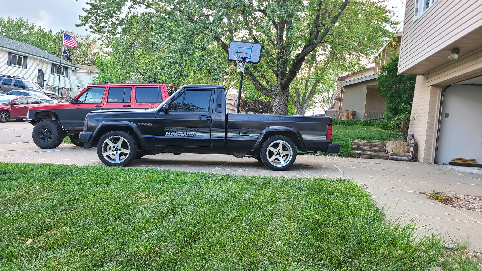

  11. Double update for tonight, got my new wheels/tires back from being mounted and balanced. My old tires were still the 17x9s that had 26mm of offset from an 03-04 mustang cobra. I needed to run 1.25" spacer on the rear to get the rears somewhat flush with the fenders as many have done, but I wanted to get away from the spacers if possible like I said. Enter the new setup: Those are 17x10.5" with 20mm offset matching cobra style rear wheels, with a nice fat lip. Finished them off with 315 wide Nitto NT555 G2 tires. Got it outside under its own manual power to take some quick photos. I couldnt be happier with it! Needs to come out about .5" either side to really be even with the fenders but she's sitting pretty now. Took it for a spin around the neighborhood quick, came back and rechecked the fluids and lug nuts and then took it for a quick spin out on the open road. First impressions are that 1st gear is all but useless! Acceleration is lightning fast even with 3.55s, would probably be a better cruiser with 3.05s but it's definitely quick enough for now. Speedo is STILL off, must have screwed up my math on that one, will have to explore further. Used a GPS speedo on my phone and it definitely gets out of its own way right quick. Had to hurry home to beat some storms but we made it! 4th and 5th gear whine pretty bad, especially under constant light throttle, probably needs more mileage to break in proper bit everything else is running perfect

  14. Sneak peek of another project. Old rear wheels with the 1.25" spacer from earlier. I've been really happy with them, but I don't like the idea of spacers at all so I'm working to get away from having to use them. Just a personal thing. And the fitment with the fender Again, I've been really happy with the look and fit of these wheels, however I have something else in store for the rears... No spacers on these, different offset and width. They're really close, by my math about 5mm further in, so slightly less than 1/4". I took the opportunity to measure my stock, 91' MJ dana 35 rear axle with drums and found it to be 60.625" (60-5/8") wms-wms. Information on these numbers is varied, and hard to come by but that's mine confirmed for this model,year and trim. Do with that what you will internet! I'd like to upgrade my rear anyway, so if I can find a rear axle with a measurement of ~61.5-62" I'd be happy but more research is needed. I could always run slightly longer studs with 1/4" shim spacers but that's a last resort. If anyone has any suggestions I'd appreciate it. Everything I've found says the late model 8.25s are around the same except the Liberty is ~63" which is a bit too wide but we'll see. I've looked into custom width 9" rear ends just with the wild thought I might V8 swap it down the line but they're pricey. The idea of an oem axle for cheap that's close to the right width and strong enough for the 6 now is appealing.
