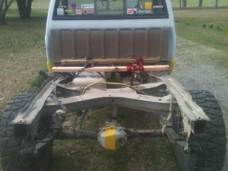

I'm removing mine now, however, this still my daily driver. I know I can zip-tie my tail lights to the frame and I've seen a picture of a guy who still drove his Comanche without a bed. I know I would need to support the tank somehow.Any ideas?

I used two 2x4s with holes drilled to mount them to the first two sets of bed mounting points. Then used ratchet straps to hold the gas tank in and exhaust up.
