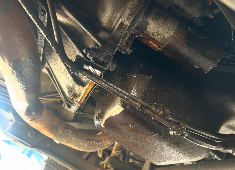

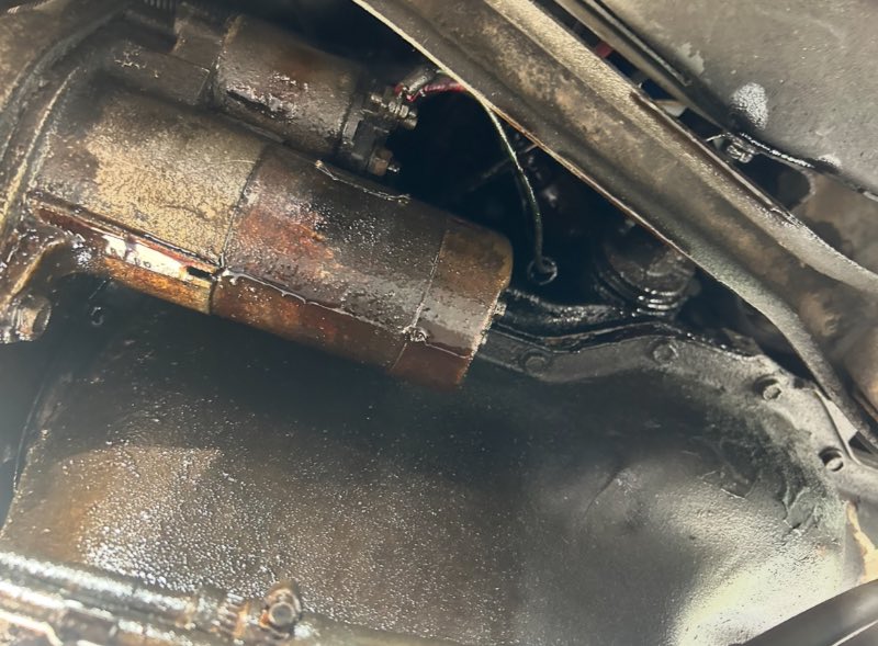

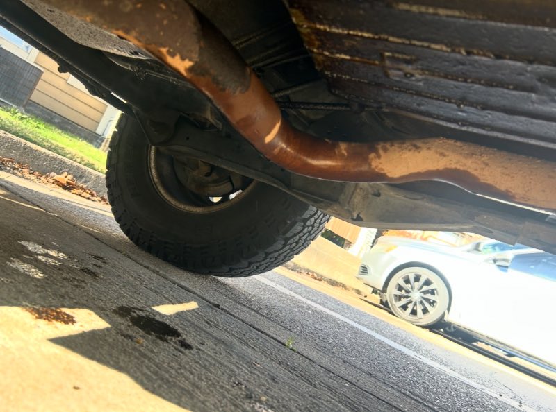

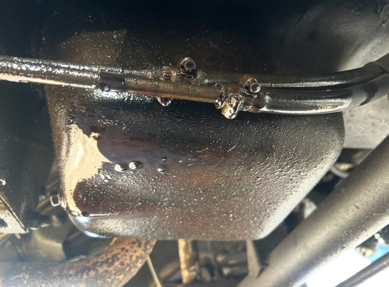

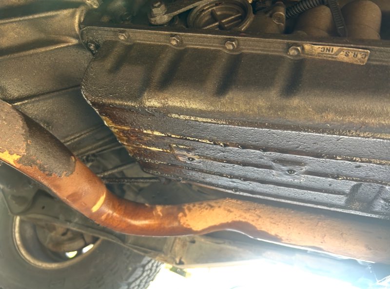

hgeranium Posted March 1 Share Posted March 1 My truck has been doing great recently and I’ve had zero problems for a couple of months now. Today I noticed a very strong new type of oil smell. When I got home I looked under the truck to see tons of oil dripping out with a lot of it landing on the exhaust and burning it up causing the smell. I remember I simultaneously had this exact issue when I was having problems with my fuel pressure a few months back but it just went away on its own. I just can’t tell where this oil could be coming from in such large quantities. The pictures won’t do justice of how much oil there is on everything and how fast it was dripping while it was running. It’s running so fast it’s making its way all the way to the transmission pan dripping from there as well ^ This picture you can see how much of the exhaust was getting covered and how wide of an area the oil was dripping Trans pan coated Here you can see how the oil pan is almost completely enveloped in oil. Same with the starter and the brake lines. The passenger area seems to be where it’s coming from. this is what it looks like looking down the engine from the passenger side. Everything is absolutely coated. The driver side is clean. I guess there’s only a few things that could be leaking but with how little room there is back there plus the heat it’s hard to check. Nothing’s coming from the top of the valve cover because after doing a double gasket on the oil cap, the top is totally dry. PCV and my homebrewed CCV solution are neither puddling nor seeping. Valve cover gasket on the passenger side does look like it’s seeping although I’m a bit skeptical of if it could be responsible for the volume of oil that I’m seeing although there’s no way for me to verify what the very back looks like. Driver side and the front of the VCG are bone dry. When I did my valve cover gasket in 2022 I do remember having a lot of trouble getting the correct torque on the very back bolt with that evil angle. If all my oil was originating up there in the middle back I would expect there to be more even drip on both sides of the engine. I couldn’t get a good picture but the driver side of the engine is clean metal. rear main seal is something I’m really hoping that is not the case, although I truly don’t know how I’d check when so much of the firewall side on this engine is covered in oil and grime I can get more pictures later when it cools down. I was pretty limited laterally with how hot it was down there. I already seared the top of my hand on the exhaust by accident. what do yall think? I wouldn’t be surprised if there was some crankcase pressure issues exacerbating it because I am still running a bit of a jerryrigged solution for my CCV hose that definitely has more of a restricted flow than the normal hose. Another thing that confuses me is how fast it onset. It suddenly got so bad so quickly. Yesterday there was no smell and zero leaks under the truck, and today it was terrible. there’s certainly always been something leaking in whatever area it is since I’ve had the truck. there’s always been a lot of oil and grime buildup on that part of the engine but it’s never been enough to drip on the ground. I’m guessing it just finally fully failed and is just letting tons of oil out. My oil pressure is still great though FWIW Link to comment Share on other sites More sharing options...
Eagle_SX4 Posted March 1 Share Posted March 1 It might just be your oil filter adapter. The o-rings are cheap and easy to replace. Link to comment Share on other sites More sharing options...
hgeranium Posted March 1 Author Share Posted March 1 5 minutes ago, Eagle_SX4 said: It might just be your oil filter adapter. The o-rings are cheap and easy to replace. I didn’t even think about the adapter. It’s certainly something I’ve never changed and I’ve done at least 3-4 oil changes on the truck lol. Oil change time is coming around quite soon coincidentally. My past oil changed I used T6 Rotella and I can tell it’s freeing a bunch of deposits. I wouldn’t be surprised if it opened back up a failure point in the adapter gasket that was sealed up by gunk. Have you heard of the adapters failing in this way in the past? I suppose it makes sense but I’m just worried with the volume of oil I’m seeing it’s the adapter plus some other things that I’ll be chasing around trying to fix. Link to comment Share on other sites More sharing options...

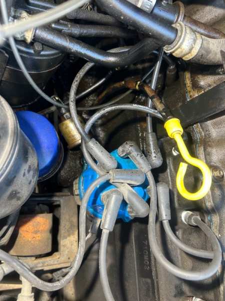

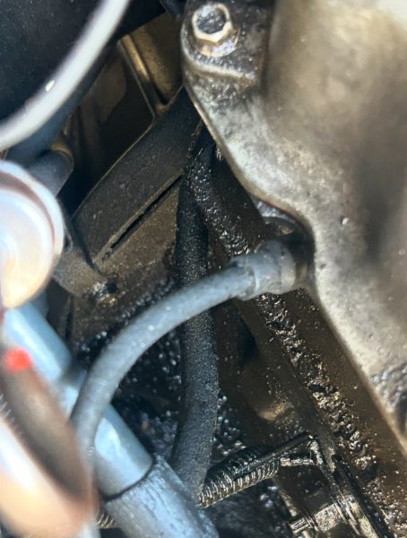

hgeranium Posted March 1 Author Share Posted March 1 17 minutes ago, Eagle_SX4 said: It might just be your oil filter adapter. The o-rings are cheap and easy to replace. The bulk of the leak as seen on the ground is definitely coming from the area of the oil filter. Of course it’s not leaking now that it’s idling but I’m guessing it starts to spray out under pressure and continued driving The side of the engine close to the oil filter and to the left of the dizzy is soaked and everything to the right of the dizzy is dry. So that also tracks that oil is spraying from the filter and getting blocked by the dizzy from splashing further to the front of the engine. Although oil is certainly seeping from the rear quarter of the VCG, I’m thinking that there’s no way it’s enough to do what the oil filter seems to be capable of. I guess regardless it would be good practice to change the adapter considering I’ve never done it Link to comment Share on other sites More sharing options...

GonzoTheGreat Posted March 2 Share Posted March 2 Can we talk more about this CCV situation? Is the crankcase able to relieve blowby pressure through its vent on the valve cover, as its supposed to? If its building excess pressure in the crank, that pressure is gonna want to find a way out. The dipstick tube looks pretty central to the oily mess. Any chance thats whats going on? Link to comment Share on other sites More sharing options...

hgeranium Posted March 2 Author Share Posted March 2 57 minutes ago, GonzoTheGreat said: Can we talk more about this CCV situation? Is the crankcase able to relieve blowby pressure through its vent on the valve cover, as its supposed to? If its building excess pressure in the crank, that pressure is gonna want to find a way out. The dipstick tube looks pretty central to the oily mess. Any chance thats whats going on? I do have it venting, it’s just not going through the air box to stop it from soaking my air filter for the meantime until I have the time and tools to redo the valve cover gasket and do the valve cover mod at the same time. Like I said before, I’ve had this issue since I got the truck, even when the original CCV hose was installed. The reason I took it off was that the grommet was so deteriorated that it was letting a lot of oil out onto the valve cover. I had a spare PCV grommet so I just stuck that on there with an old PCV hose and then just routed it towards the ground. I know the diameter of that hose is quite a bit smaller than the CCV hose but I havent seen anything occur as a result that wasn’t already happening before so I think, while it certainly isn’t helping, it’s likely not the main culprit. The only reason I’ve put off just putting on the CCV it’s that I would have to buy an entire new vacuum harness just to break off the hose that I need. I have an HO air box and a capped EGR so my vac routing is very simplified. Link to comment Share on other sites More sharing options...

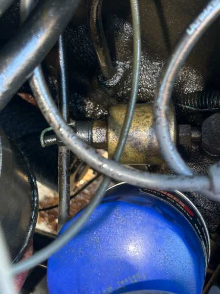

88towmanche Posted March 2 Share Posted March 2 I didn't see it mentioned here but I had a sudden massive oil leak on a Cherokee ('88, Renix, 4.0) and it was a failed sending unit - cheap and easy. Link to comment Share on other sites More sharing options...
