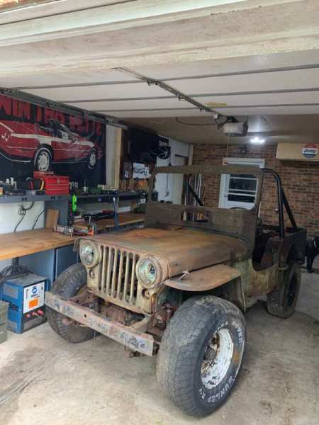

Recently dragged home this 195* Willys M38.
Hoping to start on this project next summer and I thought it would be neat for the Comanche Club to decide how it is built.
The poll feature only allows for so many questions, so the first round of polling will be for Engine, Trans, And T-Case. More will follow as progress is made and parts are collected.

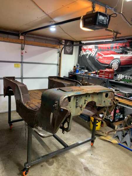

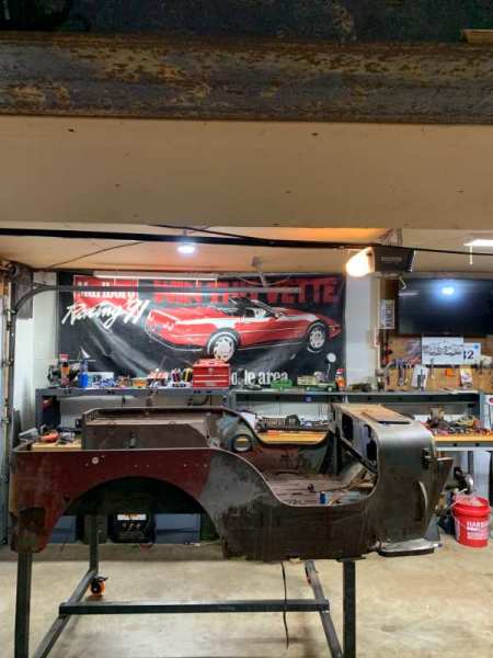

Right now, it is a blank slate. I removed the body and built a roll around body cart for it. There was no engine, transmission (t90) is on the workbench and is in bad shape, transfer case is still attached to the trans.
The good..
Frame is extremely solid.
Body is somewhat solid. Needs some floor panel and rocker work.
Military Version (Beefier Frame?)
Axle gearing both seem to be healthy
The bad..
No title
No engine
T90 transmission is in bad shape
