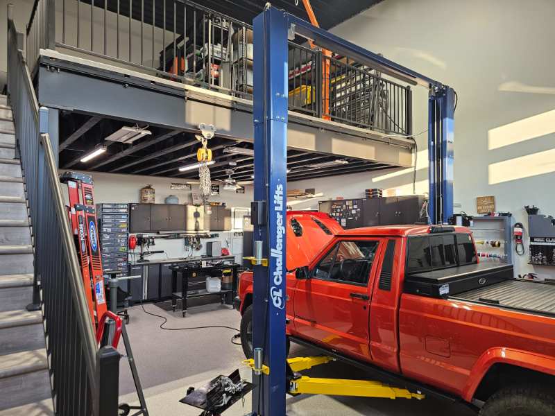

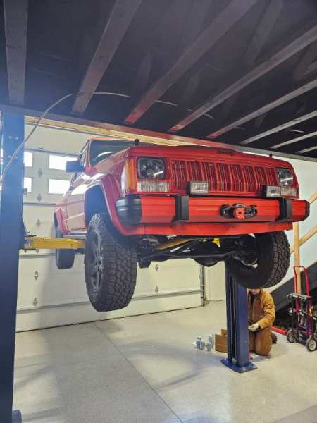

Limeyjeeper Posted December 31, 2025 Share Posted December 31, 2025 I have a Challenger 10k Versymmetric lift. Not the cheapest but I wanted something that I know won't fail. It is high quality and safe. Do not buy a lift that doesn't have ALI certification. Link to comment Share on other sites More sharing options...
