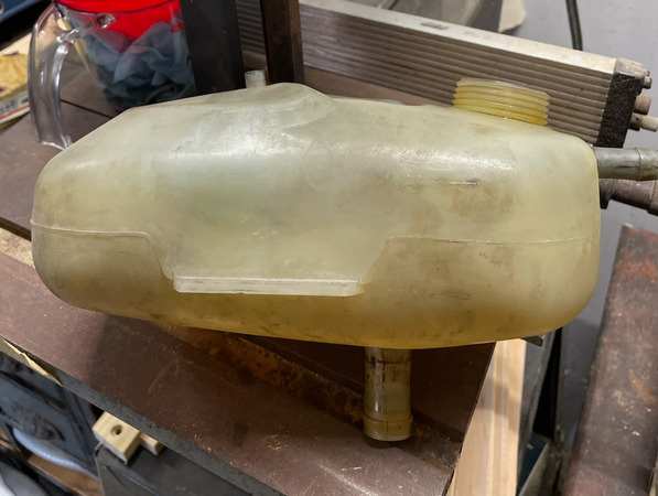

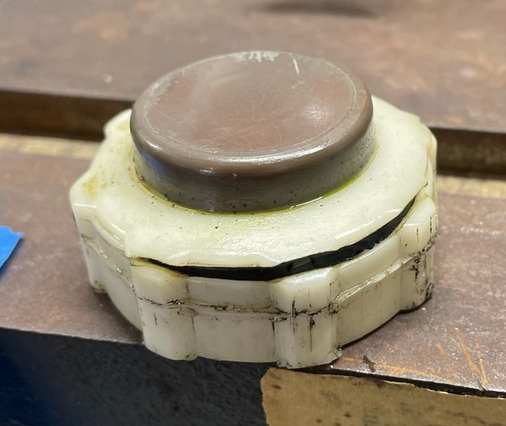

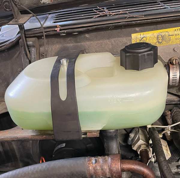

AnotherOldJeepGuy Posted September 28, 2025 Share Posted September 28, 2025 I just swapped out my coolant reservoir. I think this might be the 4th time over the years! My question is about the cap. I adding in a picture of the old split cap, as well as pictures of the old very bloated tank and the new one. The old tank swelled up a couple years ago, I think this was a result of overheating (which was due I believe to insufficient coolant because the folks that swapped in a new radiator didn't burp it well., but I managed to get it burped and the overheating stopped). Anyway my real question is about the cap. The split open open one has an obvious pressure release, but the new cap doesn't particularly look like it does. The new tank is Dorman 603-300 purchased a few years ago when I knew I'd need it sooner or later. The last time I replaced this tank, it had the same black cap but I didn't use it, opting to reuse the one from the one before that, the one that has now split. Is this new cap also designed to let off excess pressure but just doesn't look like it? If the answer is NO, can anyone direct me to when I can get one like my old one? I do see that every Dorman 603-300 I can find online now has this same black cap. Oh, my other question is, that is the metal threaded orifice/port on the top of the tank used for? Link to comment Share on other sites More sharing options...
fiatslug87 Posted September 28, 2025 Share Posted September 28, 2025 That black cap is fine. That’s what my ‘90 had when I purchased it new. I think the one that split is a different aftermarket one. I’ve seen some ‘87s in the junk yard that had a bracket attached to that threaded piece instead of the strap. Link to comment Share on other sites More sharing options...

89 MJ Posted September 28, 2025 Share Posted September 28, 2025 3 hours ago, AnotherOldJeepGuy said: Is this new cap also designed to let off excess pressure but just doesn't look like it? If the answer is NO, can anyone direct me to when I can get one like my old one? I do see that every Dorman 603-300 I can find online now has this same black cap. I ordered the Dorman one and used the cap a few years ago. My tank let go, it wasn't the cap that let go from the pressure. That could've just been a bad tank though. Link to comment Share on other sites More sharing options...
AnotherOldJeepGuy Posted September 30, 2025 Author Share Posted September 30, 2025 I attempted to determine if the cap was hitting the hood with a propped up piece of masking tap on the cap and closing the hood. I don't think it is touching, I am pretty sure the old one did a little because of the bloated tank. I read that the Volvo cap is lower profile, but it's also closing in on $20 at this point, so my plan is to monitor for a little while and if no leaks are seen, leave it alone. If I see leaking I might go ahead and get the Volvo cap and see what happens. If I learn anything useful, I'll post it. I saw on a different forum that someone lowered the tray a little for clearance to the hood, I have wondered about this myself but have not pursued it, yet Link to comment Share on other sites More sharing options...
pizzaman09 Posted October 3, 2025 Share Posted October 3, 2025 The best combo I found was the doorman tank with the original black cap. The cap with the brown vent just wouldn't hold pressure for me for the three different tanks I went through. Link to comment Share on other sites More sharing options...

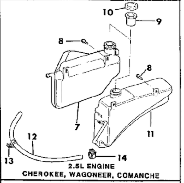

PIKE Posted October 4, 2025 Share Posted October 4, 2025 1 hour ago, fiatslug87 said: Using the Mac’s tank essentially turns it to an open system. The expansion bottle from a 2.5 liter works very nicely with the Macs tank. It bolts right in, the mounting holes are already there. https://www.quadratec.com/products/51216_02.htm?gad_source=1&gad_campaignid=19472278524&gbraid=0AAAAAD_wpjimqWgguCgVpB6d83jQ2KQ0l&gclid=CjwKCAjwi4PHBhA-EiwAnjTHuSHNute531deQ-asKqcdWeqKsHb1cH5bsOR2Dl948PO8905E3VziIhoC_M4QAvD_BwE Link to comment Share on other sites More sharing options...
fiatslug87 Posted October 4, 2025 Share Posted October 4, 2025 Then you need this cap for the 2.5L overflow bottle. https://www.amazon.com/gp/aw/d/B000C5G8CM?psc=1&ref=ppx_pop_mob_b_asin_title Link to comment Share on other sites More sharing options...
PIKE Posted October 4, 2025 Share Posted October 4, 2025 38 minutes ago, fiatslug87 said: Then you need this cap for the 2.5L overflow bottle. https://www.amazon.com/gp/aw/d/B000C5G8CM?psc=1&ref=ppx_pop_mob_b_asin_title There was also a short round tube that would go with that under the cap originally, I haven't been able to find one. I think it was to prevent coolant from sloshing out the cap since it is vented. Number 9 Link to comment Share on other sites More sharing options...
AnotherOldJeepGuy Posted October 7, 2025 Author Share Posted October 7, 2025 On 10/3/2025 at 8:21 PM, fiatslug87 said: There's also this option, price has gone up significantly but it will be the last tank you will ever need. https://macsradiatorshop.com/product/macs-1987-1990-jeep-cherokee-aluminum-coolant-tank/ Yeah, I'll be holding off on this one, way too pricey for me! And I kinda like to be able to do a 2-second level check. I have already purchased the next new tank, I generally keep one of these in the garage ready for replacement. Link to comment Share on other sites More sharing options...
AnotherOldJeepGuy Posted October 7, 2025 Author Share Posted October 7, 2025 On 10/3/2025 at 6:13 AM, pizzaman09 said: The cap with the brown vent just wouldn't hold pressure for me for the three different tanks I went through. I think mine was a constant source of a little leak as well, but I was never really sure it was the cap's fault since because of the tank bloating, I think the brown part touched the inside of the hood. Either way, the new unbloated tank w/ new black cap has been working leak free, so I guess I'll keep it. Link to comment Share on other sites More sharing options...
hgeranium Posted October 7, 2025 Share Posted October 7, 2025 9 hours ago, AnotherOldJeepGuy said: I think mine was a constant source of a little leak as well, but I was never really sure it was the cap's fault since because of the tank bloating, I think the brown part touched the inside of the hood. Either way, the new unbloated tank w/ new black cap has been working leak free, so I guess I'll keep it. I must’ve gotten unlucky with my parts. That new black cap instantly started leaking from all around when it got pressurized.. Reusing the brown one made it airtight again. Link to comment Share on other sites More sharing options...
