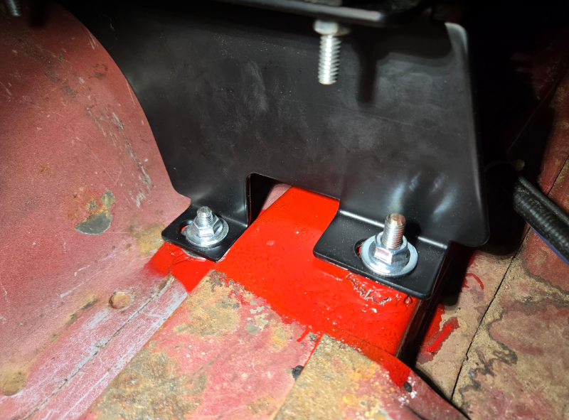

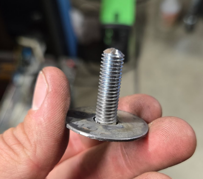

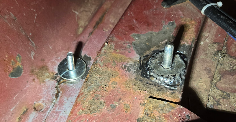

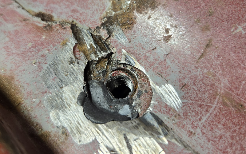

James92 Posted June 15, 2025 Author Share Posted June 15, 2025 On 6/13/2025 at 12:09 PM, 89 MJ said: Looks like a super nice truck! Thanks! This weekend I had to fix my seat bracket. The previous owner did a really hack job installing the XJ buckets, which I didn't notice until I sat down the other day and the seat was very loose. They had cut off the stock mounting bolts and drilled a hole next to the OEM one to put a threaded rod through it. Since there wasn't any room, they just put a threaded rod through the hole with some washers and a nut. The washers had tilted and the nut ended up clamping against the brake line!! I don't have a good picture of it, but this is the threaded rod, and you can see a little bit of wear on the brake line where the washers had worn against the brake line... I ended up drilling out the factory threaded rod and tapping the stock welded nut. I filled the hole that the PO drilled with JBWeld StickWeld. I know this isn't ideal, but the brake lines are RIGHT there, so I couldn't weld it closed. For the other side, I got some threaded rod, cut it to length, then welded a washer to it. Then, I welded the washer to the floor pans in the stock location. I know my welds aren't great, but I'm working with what I got! It'll hold for now. I grinded down the welds and painted it so it wouldn't rust. Again, I know the red looks terrible, but it was what I had on the shelf. It'll eventually be under sound deadening and carpet, so I don't really care. Bolted down the seat with Krustyballer's seat bracket and now it's not loose anymore! Much better. Link to comment Share on other sites More sharing options...
watchamakalit Posted June 15, 2025 Share Posted June 15, 2025 I would recommend treating the rest of the floors with some rust stop. The surface rust that is there won't get any better under carpet. Link to comment Share on other sites More sharing options...
James92 Posted June 20, 2025 Author Share Posted June 20, 2025 On 6/15/2025 at 5:20 AM, watchamakalit said: I would recommend treating the rest of the floors with some rust stop. The surface rust that is there won't get any better under carpet. Thanks, I'll definitely be cleaning up the floors before I put in the sound deadening and carpet. Not sure if I'm going to paint with POR15 or just grind down the rust and repaint red, but we'll see. I'm in Minnesota now visiting a friend and we swung by the junkyard. There was a really sweet loaded maroon on maroon 92 XJ there. I pulled a few parts that I should be able to fit in my luggage or ship back. I got a spare gauge cluster (to hopefully fix my odometer issue), the dual note horns, cruise control(!), the brackets to mount the center console, and an underhood light. I wish I was local, I would've pulled the power seats and interior. Maroon is sweet! The original chrome grill and headlight surrounds were in great shape too, and the chrome door handles. But I think I prefer the black plastic look personally. Hopefully someone else can grab them and make good use of them. Link to comment Share on other sites More sharing options...

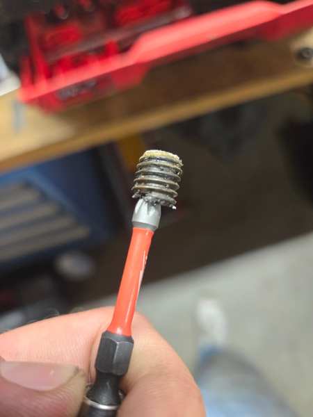

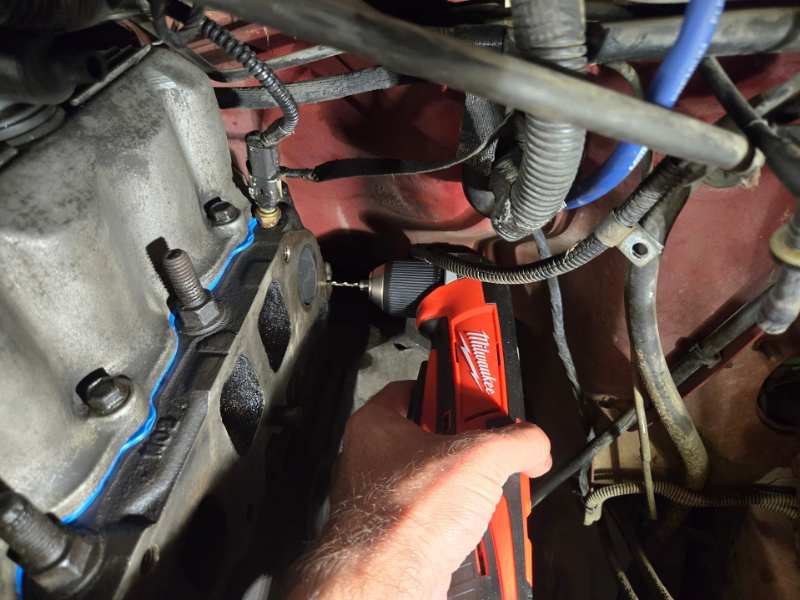

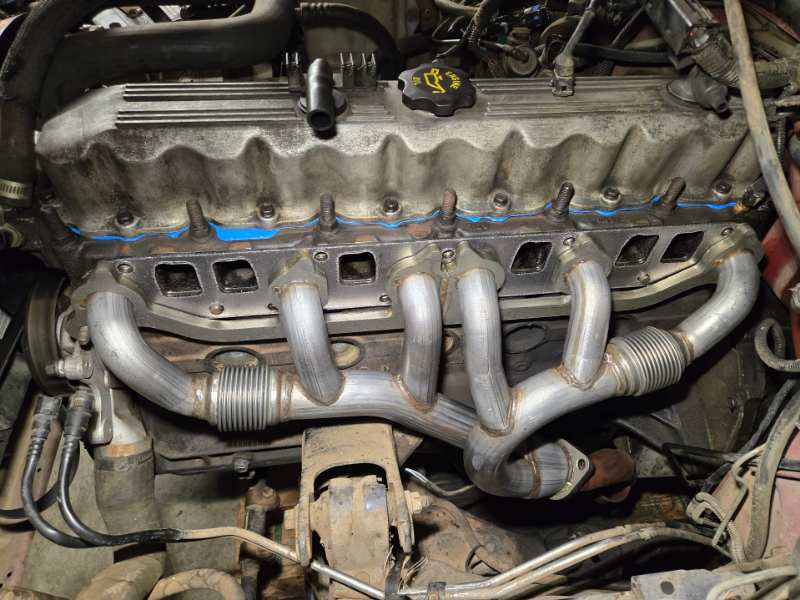

James92 Posted September 5, 2025 Author Share Posted September 5, 2025 Well, labor day weekend was busy for me. I decided to finally take a crack at the exhaust manifold. It was pretty straight-forward. It seems like most people report that all exhaust manifolds crack eventually, even the fancy Banks headers. So, I bought the cheapest ones on ebay and threw them on. I used a nice Remflex gasket, which worked great. The worst part, of course, was the rear stud was broken deep within the head. I had to get a new tool, right hand drill (oh no what a shame more tools!), and luckily enough that took it right out: Along the way, I found the power steering pulley had a chip in it, and the lower radiator hose was barely held on by the hose clamp. Whoever replaced the water pump last put the hose clamp on the very very edge of the hose. I'm lucky it didn't blow off. I ended up replacing the hose and flushing the coolant while I had it all apart. Also, the heater control valve was extremely brittle and snapped apart while I was manipulating the hoses around. And I figured I'd replace the valve cover gasket and clean it up. So all in, new: exhaust manifold, valve cover gasket, power steering pulley, serpentine belt, lower radiator hose, heater control valve, and fresh coolant. After all this work, I took the truck for a test drive... and the CEL came on. Code 51 - lean mixture. Very disappointing. I checked all the vacuum lines and the manifold bolts. Nothing. Checked the O2 sensor wiring - also fine. So I bought a new O2 sensor and diagnosed the old one. Grounds all checked fine and the heater wire was getting 13V. The signal wire seemed a little off potentially, but it was hard to tell. So I swapped in the new O2 sensor, and so far no codes! The O2 sensor I took out still had the original Mopar PN on it, incredibly. I don't quite understand how it's possible that before all this, there were no codes. And after all these issues were fixed, now I get a code? Weird... Here's the crack, pretty gnarly! The truck is a lot quieter now, and it always feels nice finishing big jobs like this. After 30+ years of 4 owners, you never know what's going on under the hood. Each job makes you more familiar with the truck, giving you a little more piece of mind that things are done right. Happy Jeep up in the mountains: Link to comment Share on other sites More sharing options...

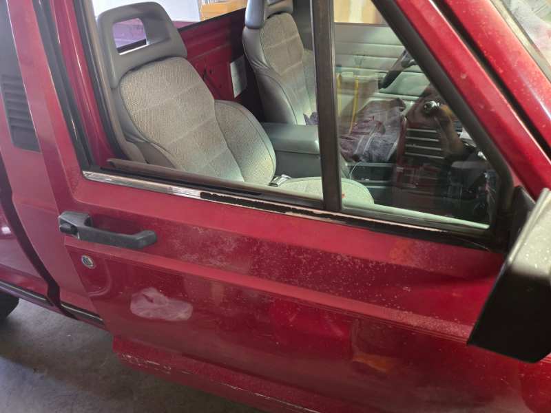

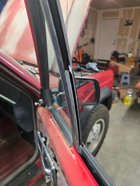

James92 Posted September 5, 2025 Author Share Posted September 5, 2025 ... and that wasn't all I did last weekend. I decided that wasn't fun enough, so I took apart the doors and replaced all the weather stripping. The old felt was pretty brittle, and the window scrapers were almost non-existent. The Precision Replacement Parts kit was great. It's pretty cheap and fit very similar to OEM. Out with the old... And... oops.. I don't have any pictures of the new. I'll grab some, but you get the idea. It looks a lot better now. One of the big things I was looking forward to with this job was finding the build sheet inside the door panels. Unfortunately, no luck. This is all that remained: Thanks for reading! Link to comment Share on other sites More sharing options...

Big_Mark Posted September 6, 2025 Share Posted September 6, 2025 REMFLEX FTW!!!! The last manifold gasket you will ever need Nice MJ as well Link to comment Share on other sites More sharing options...
James92 Posted September 6, 2025 Author Share Posted September 6, 2025 4 hours ago, Big_Mark said: REMFLEX FTW!!!! The last manifold gasket you will ever need Nice MJ as well Yes! Thanks! I'm glad I saw the recommendation on here. I also had a felpro on hand, and it doesn't comlare to the Remflex. Much much nicer! Link to comment Share on other sites More sharing options...
Big_Mark Posted September 6, 2025 Share Posted September 6, 2025 1 minute ago, James92 said: Yes! Thanks! I'm glad I saw the recommendation on here. I also had a felpro on hand, and it doesn't comlare to the Remflex. Much much nicer! Especially if you're running headers, the 1/8" Remflex gaskets fill the irregularities nicely, and keep em filled! Link to comment Share on other sites More sharing options...

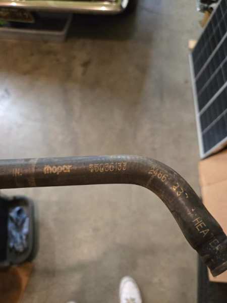

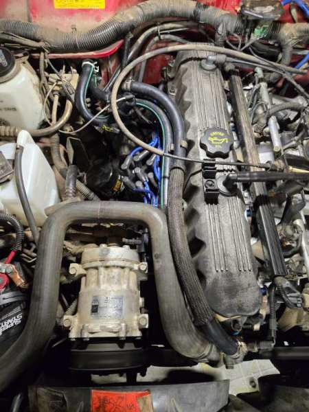

James92 Posted December 31, 2025 Author Share Posted December 31, 2025 Alrighty, been a busy few months. Merry Christmas and Happy New Year to everyone! Hope you all are enjoying the time with friends and family. I'm a big fan of Sears (RIP), so I couldn't resist a photo op at this Sears Auto Center. Most of my garage time has been taken up by the Barracuda recently, but I did get a chance to replace all my *original* heater hose with really nice Gates green stripe heavy duty hose. I bought 50' of it on Rockauto for all my projects. Now I kind of regret it. The stuff is almost too nice! It's so thick that it's very hard to route it around curves. But I was able to get it all to work well. Finally, I'm very excited to report that I found a set of Eliminator wheels while home for the holidays. I've been looking since I bought the truck and wow these wheels are hard to find. The ones I bought aren't in the best shape, but I think I will try to bring them to a wheel shop to see what can be done. I got them all packed up and shipped out last night. Will also need to find some center caps... That's all for now! Link to comment Share on other sites More sharing options...

Salvagedcircuit Posted January 1 Share Posted January 1 14 hours ago, James92 said: Alrighty, been a busy few months. Merry Christmas and Happy New Year to everyone! Hope you all are enjoying the time with friends and family. I'm a big fan of Sears (RIP), so I couldn't resist a photo op at this Sears Auto Center. Most of my garage time has been taken up by the Barracuda recently, but I did get a chance to replace all my *original* heater hose with really nice Gates green stripe heavy duty hose. I bought 50' of it on Rockauto for all my projects. Now I kind of regret it. The stuff is almost too nice! It's so thick that it's very hard to route it around curves. But I was able to get it all to work well. Finally, I'm very excited to report that I found a set of Eliminator wheels while home for the holidays. I've been looking since I bought the truck and wow these wheels are hard to find. The ones I bought aren't in the best shape, but I think I will try to bring them to a wheel shop to see what can be done. I got them all packed up and shipped out last night. Will also need to find some center caps... That's all for now! I really dig this photo. What year was it taken? You'll never know Hehehe Link to comment Share on other sites More sharing options...
