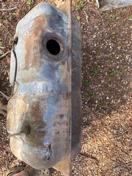

Kickin’Chicken Posted May 23 Share Posted May 23 4x4, automatic and 4.0. so I ordered the tank - the only tank - that I concluded was original in the truck, since mine was full of rust. I also ordered a new sending unit/pump that appears to match that tank. Anyway, I just removed the tank to dispose of and it has a 16 gallon tag on it? Should I reverse course and order another 16 gallon or will the 23.5 work? TIA and a pic of the tank …. Link to comment Share on other sites More sharing options...

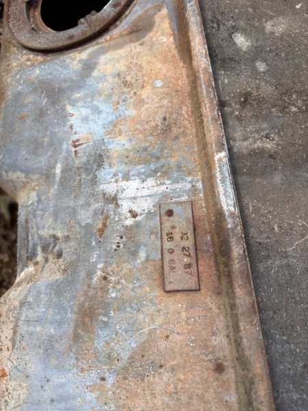

Kickin’Chicken Posted May 23 Author Share Posted May 23 Here’s a pic of the tag: Link to comment Share on other sites More sharing options...
coheed Posted May 23 Share Posted May 23 So the 16 and the 23 are actually the same size. The vent tube is just lower in the tank making it so you can't fill it up as much. I had a 16 in my 86 and swapped a 23 in with no issues. Link to comment Share on other sites More sharing options...
89 MJ Posted May 23 Share Posted May 23 You might need to swap to the sending unit for the 23 gallon tank though, if I recall correctly. Link to comment Share on other sites More sharing options...
JeepSchmidt O'Guinness Posted May 23 Share Posted May 23 If your oem 16gal had three straps the 23 gal should fit inplace without issue. Shortwheelbase used a smaller 16gal tank with only two straps that don't match the placemen of the 23gal long wheel base. Link to comment Share on other sites More sharing options...
eaglescout526 Posted May 23 Share Posted May 23 6 minutes ago, JeepSchmidt O'Guinness said: If your oem 16gal had three straps the 23 gal should fit inplace without issue. Shortwheelbase used a smaller 16gal tank with only two straps that don't match the placemen of the 23gal long wheel base. Youre thinking of the 18 gallon tank. Link to comment Share on other sites More sharing options...
JeepSchmidt O'Guinness Posted May 23 Share Posted May 23 I thought something seemed off when writing 16. Thx Link to comment Share on other sites More sharing options...
Kickin’Chicken Posted May 23 Author Share Posted May 23 57 minutes ago, JeepSchmidt O'Guinness said: If your oem 16gal had three straps the 23 gal should fit inplace without issue. Shortwheelbase used a smaller 16gal tank with only two straps that don't match the placemen of the 23gal long wheel base. Yes. It has 3 straps!👍 Thanks 😁 Link to comment Share on other sites More sharing options...
