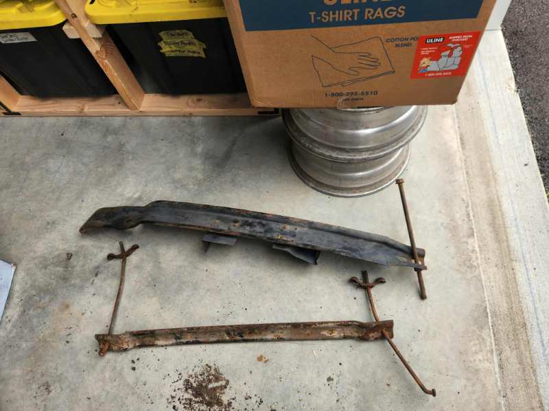

DesertComanche86 Posted October 8, 2023 Share Posted October 8, 2023 Looking for some help. I'm wanting to repair my Spare Tire Carrier. Its components are working but I need to get the end piece of the wire and the bolt/nut that crimps on to the wire to make it work. I don't know the names of these two components, if anyone can help me I would really appreciate it. I'm posting a picture of my Spare Tire Carrier as it is and a picture I found on ebay which shows the components I'm looking for. Hopefully someone out there in the Jeep Comanche community can help me identify these parts, better yet, if you can let me know where to buy them I would be very appreciative. Link to comment Share on other sites More sharing options...
Salvagedcircuit Posted October 8, 2023 Share Posted October 8, 2023 I believe the end part is crimped on. I Don't think it's a disassemblable component. You could probably get away with any stamped piece of metal for the tire holder part, but I do not know how to reliably crimp onto a stainless cable. Link to comment Share on other sites More sharing options...
eaglescout526 Posted October 8, 2023 Share Posted October 8, 2023 Could always find an S10 winch and just sandwich it between the mounting pieces of the old assembly. Link to comment Share on other sites More sharing options...
Pete M Posted October 8, 2023 Share Posted October 8, 2023 hardware stores will have various clamping options for ya. Link to comment Share on other sites More sharing options...

OldSch88L Posted October 9, 2023 Share Posted October 9, 2023 Dang, I should've taken pics of my setup! My wire was cut just like yours, so I took the retainer off my 1998 Ford Ranger, which just barely goes through a Ravine wheel's center bore, then took a beefy bolt and washer, drilled a hole through the bolt, looped the cable through the hole and tied it with 2 cable clamps. I keep an eye on it from time to time and all is good so far. Link to comment Share on other sites More sharing options...

Salvagedcircuit Posted October 9, 2023 Share Posted October 9, 2023 Hmm. My spare tire holder works great, but I wonder if it's worthwhile to have a safety strap of some kind so I don't end up with a torn cable or failed crimp. Link to comment Share on other sites More sharing options...
fiatslug87 Posted October 9, 2023 Share Posted October 9, 2023 You should. Good, cheap insurance and the cable won’t be bearing all the weight. In 86 there was an optional (??) support bracket. Link to comment Share on other sites More sharing options...

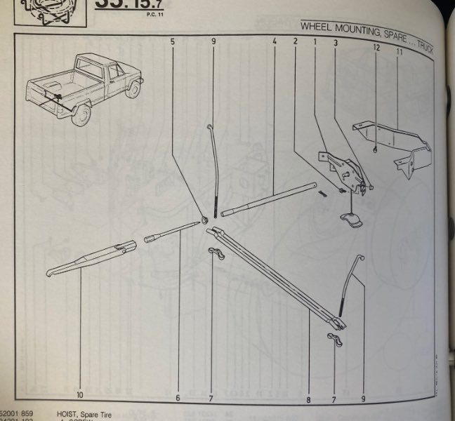

fiatslug87 Posted October 9, 2023 Share Posted October 9, 2023 There’s this On eBay Link to comment Share on other sites More sharing options...
Salvagedcircuit Posted October 9, 2023 Share Posted October 9, 2023 27 minutes ago, fiatslug87 said: You should. Good, cheap insurance and the cable won’t be bearing all the weight. In 86 there was an optional (??) support bracket. This is a pretty straight forward design. I like it. I'll fabricate something up. I'm hoping the j-bolt slots are still there in the bed frame. Link to comment Share on other sites More sharing options...
eaglescout526 Posted October 9, 2023 Share Posted October 9, 2023 35 minutes ago, Salvagedcircuit said: This is a pretty straight forward design. I like it. I'll fabricate something up. I'm hoping the j-bolt slots are still there in the bed frame. Knowing AMC, they are still there. Link to comment Share on other sites More sharing options...
fiatslug87 Posted October 9, 2023 Share Posted October 9, 2023 The keyholes in the frame for the j bolts are only accessible and in the correct locations in the LWB models so you’ll be good to go. LWB SWB Link to comment Share on other sites More sharing options...
Salvagedcircuit Posted October 9, 2023 Share Posted October 9, 2023 10 hours ago, fiatslug87 said: The keyholes in the frame for the j bolts are only accessible and in the correct locations in the LWB models so you’ll be good to go. LWB SWB I love how you know this and have photos readily accessible to back it up. A legend indeed. I should absolutely go ahead and fab one up. Thanks a ton! Awesome! Thanks 10 hours ago, eaglescout526 said: Knowing AMC, they are still there. Link to comment Share on other sites More sharing options...
JolietJEEP'84 Posted May 27, 2025 Share Posted May 27, 2025 On 10/8/2023 at 11:46 PM, fiatslug87 said: The keyholes in the frame for the j bolts are only accessible and in the correct locations in the LWB models so you’ll be good to go. LWB SWB It appears in my stash of parts I found one or more of these. Any idea if the support at the top of the picture is actually MJ specific? Maybe for SWB? Link to comment Share on other sites More sharing options...
watchamakalit Posted May 27, 2025 Share Posted May 27, 2025 I think this might be the elusive (86?) Only tire carrier bar..... Link to comment Share on other sites More sharing options...
fiatslug87 Posted May 27, 2025 Share Posted May 27, 2025 I don’t think the top bar is from an MJ. Link to comment Share on other sites More sharing options...
