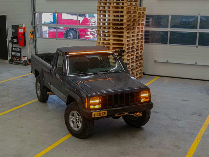

Wouter Posted September 17, 2024 Author Share Posted September 17, 2024 It's back on the road! Finally managed to get the car all put together last weekend. Dropped it off for testing yesterday.... And failed. No big issues luckily, I just had to take out the seatbelts and side indicators. Why? Because of idiotic rules. Anyway, went back today to have it checked again. Now it was all good, so it's good to go on the road for the next 2 years. Link to comment Share on other sites More sharing options...

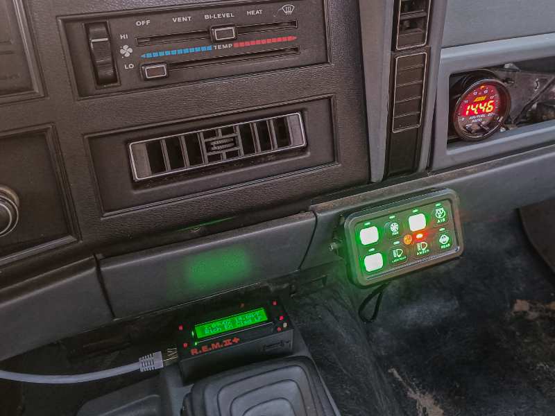

Wouter Posted June 20, 2025 Author Share Posted June 20, 2025 It's been a while, so here's an update. Most important, I'm now in the new shop! It's not completely done yet, but we're getting close. In other news. It's still a great daily driver and it is just getting better. I finally have my REM running with a wideband O2 sensor after a couple of months of pulling my hair out and frequent messaging with Nick. Turns out export market vehicles come with a different ecu that does not recognize an 02 signal. Ended up getting a '249' computer from Ebay, swapped it in, and it's now running better than ever before. Hopefully now this is all done I can finally get on with the camper! Link to comment Share on other sites More sharing options...
