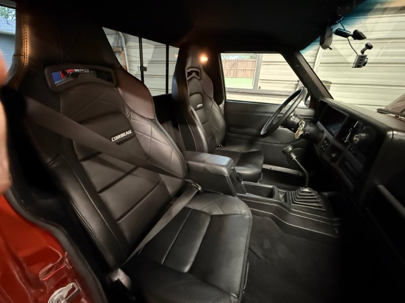

Salvagedcircuit Posted April 29, 2025 Share Posted April 29, 2025 3 hours ago, ghetdjc320 said: Some final shots before leaving Absolutely stellar work right there! Wow. What did you end up choosing as a head unit? Thanks! Link to comment Share on other sites More sharing options...
ghetdjc320 Posted May 1, 2025 Author Share Posted May 1, 2025 On 4/30/2025 at 1:38 AM, Salvagedcircuit said: Absolutely stellar work right there! Wow. What did you end up choosing as a head unit? Thanks! I used the Joying 6.2” single din head unit. Can’t say enough good things about that unit. @Limeyjeeper was the one who first suggested it. Seems like very good quality unit. Unfortunately, I don’t see it listed on Joying’s site anymore though the 7” single DIN *may* fit Link to comment Share on other sites More sharing options...

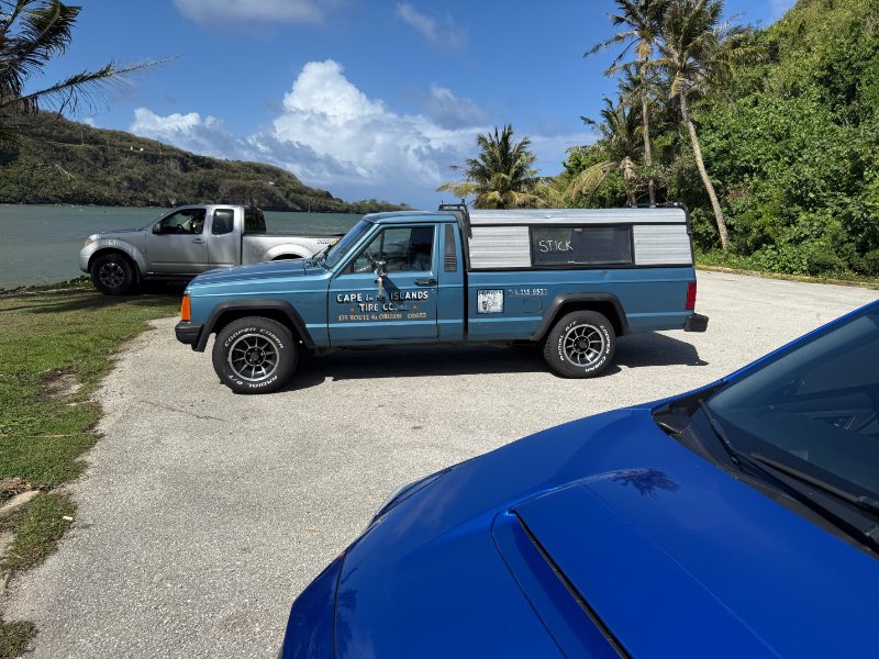

ghetdjc320 Posted May 17, 2025 Author Share Posted May 17, 2025 Very cool to spot a fellow club members’ MJ here on island today @Yellowoctupus Next year in May there is an island wide car show at Andersen Air Force Base. I say we arrange an MJ takeover for anyone willing and able Link to comment Share on other sites More sharing options...

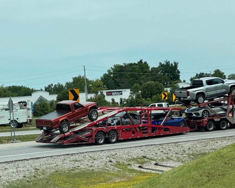

ghetdjc320 Posted May 29, 2025 Author Share Posted May 29, 2025 Truck is few days out now from port. It made a stop over at Honolulu for a day. According to the shipper, the truck came in at a weight of exactly 3,231 lbs. Link to comment Share on other sites More sharing options...

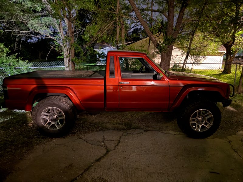

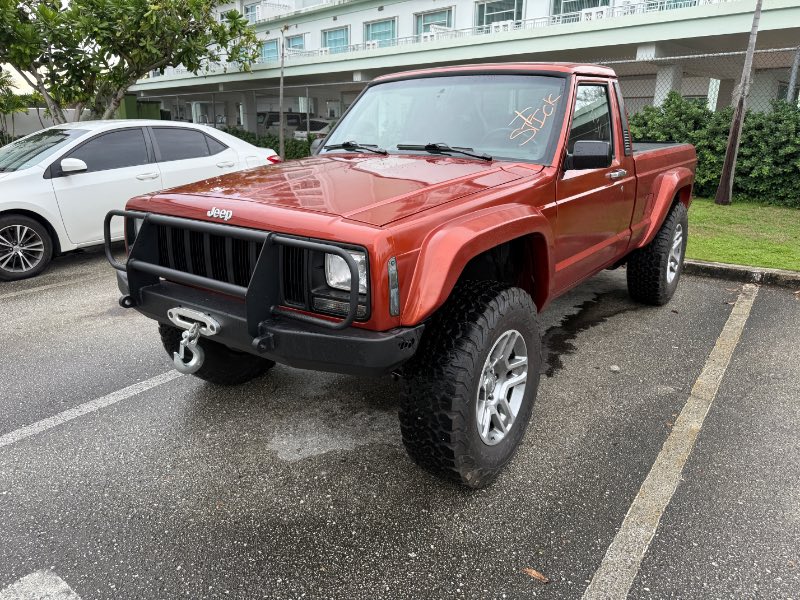

ghetdjc320 Posted June 4, 2025 Author Share Posted June 4, 2025 About to pick it up from the port Link to comment Share on other sites More sharing options...
ghetdjc320 Posted June 4, 2025 Author Share Posted June 4, 2025 It has arrived!! Definitely need to fix the drivers side interior door pull/armrest. That’s first on the list. It runs great though. I’m going to grab an HP Tuners and adjust the speed sensor input on the PCM since I’m running the Dakota GPS speed sender. The sender is working great and gives me an accurate Speedo. The fuel gauge also appears to have resurrected and is functioning perfectly again . I’m guessing it maybe just needed a full tank and some road miles?? Funny how some bugs work themselves out. I’m not happy with my steering though. The steering is too stiff. It’s definitely some form of power steering but it’s too heavy. I’m guessing the 12:1 box with the 33’s is asking a bit too much. Will probably go with another PSC big bore box or something that gives me a better steering feel. The brakes work well and seem to be well proportioned. I can tell that I could benefit from a slightly larger master cylinder in the 1” or 1-1/16” bore range as it takes a good bit of fluid movement (aka pedal travel) to move these massive calipers. But they do work very well. I would definitely recommend this style brake setup if you have the pre-90 knuckles. Will have to get some glamour shots but here is a quick pic. Link to comment Share on other sites More sharing options...

ghetdjc320 Posted June 6, 2025 Author Share Posted June 6, 2025 So it turns out it’s the actual steering box that is defective. It doesn’t want to return to center, it’s very tight and resists turning left badly. Ordered up a new PSC big bore box and will never again buy a rebuilt box no matter who builds it. Redhead has a pretty good reputation but this box is trash. Link to comment Share on other sites More sharing options...
Comanche SS Posted June 6, 2025 Share Posted June 6, 2025 1 hour ago, ghetdjc320 said: So it turns out it’s the actual steering box that is defective. It doesn’t want to return to center, it’s very tight and resists turning left badly. Ordered up a new PSC big bore box and will never again buy a rebuilt box no matter who builds it. Redhead has a pretty good reputation but this box is trash. How did you determine its bad? Also curious what PS pump you ran? The LS pumps are generally Saginaw series II (or P-series) but they have different flow/pressure for truck and car applications. I run the Car pump, with a 1.5:1 steering ratio and mine does well…original 250K miles box on mine. Link to comment Share on other sites More sharing options...
ghetdjc320 Posted June 6, 2025 Author Share Posted June 6, 2025 5 hours ago, Comanche SS said: How did you determine its bad? Also curious what PS pump you ran? The LS pumps are generally Saginaw series II (or P-series) but they have different flow/pressure for truck and car applications. I run the Car pump, with a 1.5:1 steering ratio and mine does well…original 250K miles box on mine. These box issues are a familiar one. The pump itself is quiet, flowing well and bubble free. You can feel the feedback in the wheel from the steering box. Almost feels like those “Cruisin USA” arcade game steering wheels that would pull the wheel one way or another as you drove. The return to center is non existent and the steering is stiff only when turning left. All the steering components such as ball joints, linkage etc are all new. I’m truly starting to believe that a “rebuilt” steering box is a myth. Once they go, send em to the scrap heap. I’m running the stock C5 TC 2 steering pump which is rated at 1200 psi with the upgraded GM performance pulley. The only thing is dislike about the C5 power steering setup is the reservoir. The location is great for feeding the pump but is tough to fit your intake around. I cut and welded that bracket on every dimension possible to eliminate all but the tiniest bit of clearance between the reservoir and the engine. I’d run a PSC reservoir and TC 2 pump but there just isn’t a great spot to add that reservoir on a C5 belt drive. Chase bays has a pretty sweet little reservoir I may try someday. But I’ll see how the steering does with the PSC box. I had one on my YJ before and it was the best steering I ever had on a non-rack & pinion Jeep. Link to comment Share on other sites More sharing options...
ghetdjc320 Posted June 7, 2025 Author Share Posted June 7, 2025 Was able to replace the upper arm rest retainer clip and finally get my arm rest solid. Started tracking down a slight clanking sound when going over bumps. I found a bit of play on the passenger lower control arm mounting bolt. Going to try tightening everything up and see if that takes care of it. Been keeping a close eye on all fasteners as I start daily driving it. The AC works excellent and I’m very satisfied with how the ls pcm handles the controls. Just need to take care of the clanking sound and replace the gear box with the PSC. Plenty of small little projects that are now enjoyable to do since the major stuff is finished. Link to comment Share on other sites More sharing options...
