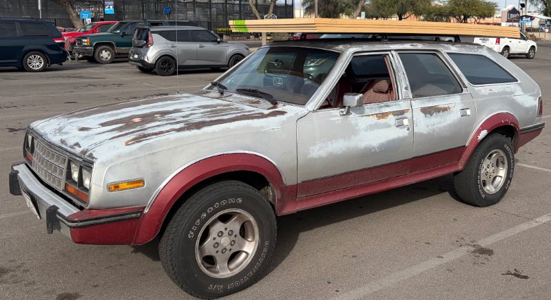

89 MJ Posted May 28, 2021 Author Share Posted May 28, 2021 Here is the current state. The car is in PA. I am in WI. I am looking into some shipping options. If I can’t get it shipped reasonably, we are planning to drive there and back the weekend of the 19th. Since I sold the car, the owner says he has done nothing with it. He is planning on getting it fired up this weekend and will try to send me more pics then. This car is going to be my year round driver. When I get it back, I want to take it apart and fix any rust (was an AL car, so it is very solid) and then rust proof the ever living snot out of it so it will survive. I will also have to keep it clean in the winter. I want to lift it a couple of inches and run 235/75R15s in an All Terrain flavor. I also want to modify it in a period correct 80s kind of way. It isn’t going to be painted anytime soon either. The red may get redone, that is TBD when I get the car back. Link to comment Share on other sites More sharing options...
