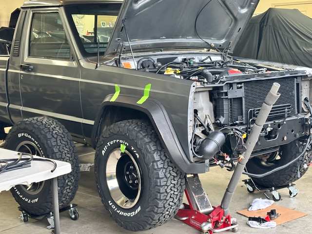

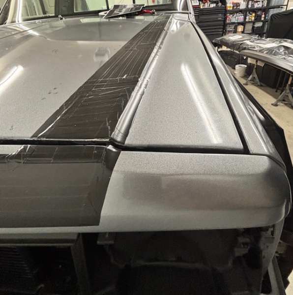

Gjeep Posted October 17, 2025 Author Share Posted October 17, 2025 This is how my graphics lay-out started a little over a month ago, using my ’91 MJ as the guinea pig. Had to see how it would look in person. Seeing things on-screen just isn’t the same. So, I bought I don’t know how many rolls of electric tape and 1/4” pinstripe tape to represent the cut-out where body color would be shown. Many, many, many, many visions and revisions got me to here: These graphics are 99.9% final. Aiming to have files off to the graphics guy for mid-Nov tweaking/production. This is a photo of my MJ with graphics laid on via Adobe Illustrator but during the day while working I dabble using MS Word, updating master file later. You can see the sloppy blocks. The graphic will start/stop 1/2” from the flare following the contour. Hood will have a Comanche Chief-ish stripe but simpler. The tailgate center-most area will be blacked out with ‘Jeep’ letters cut out (like the ‘Comanche’ on the side) so the silver paint is exposed. The header panel Jeep logo will be a cut-out as well with solid black ‘4x4’ decal on the cab in the usual spot. I cut the wheels/tires off so I can see in my mind a couple different wheel options. Link to comment Share on other sites More sharing options...

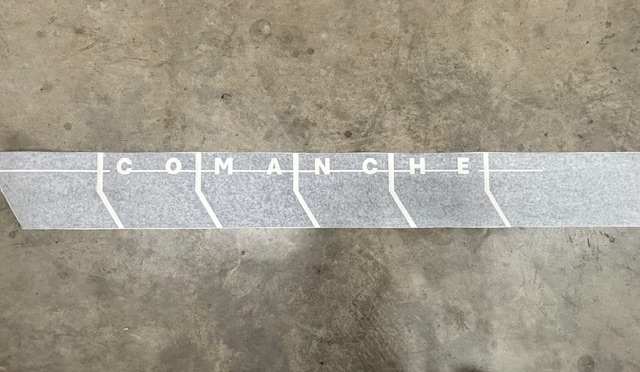

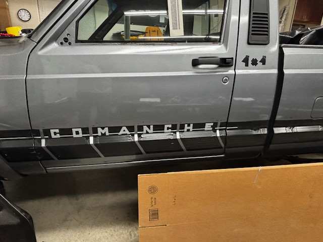

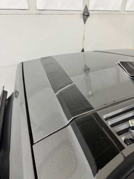

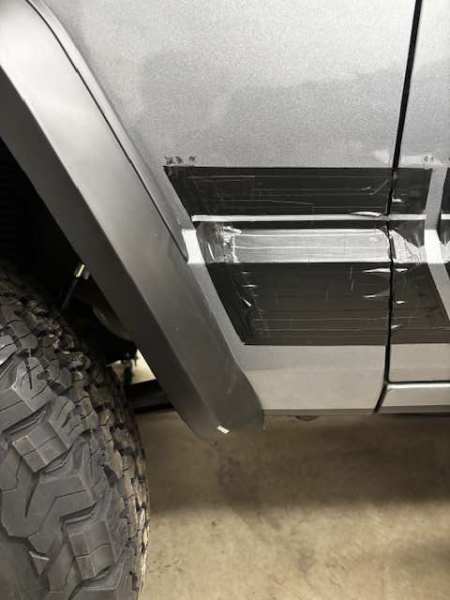

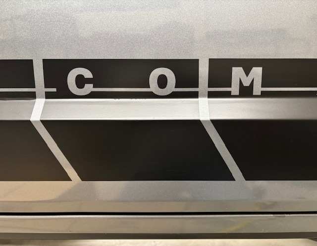

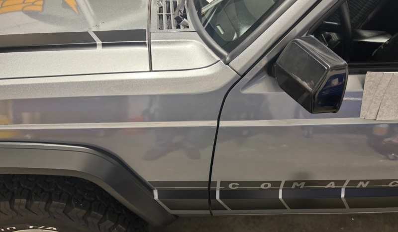

Gjeep Posted October 23, 2025 Author Share Posted October 23, 2025 First pass of the graphic is spot-on. Trimmed a small portion of this pre-production vinyl and applied to the only clean side of my ’91 MJ test-case truck. I’m using my ’91 as the proving ground before the ’92 MJ gets its final stripes. Next week I’ll have a portion of the hood stripe to lay. Link to comment Share on other sites More sharing options...

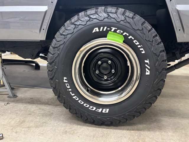

Gjeep Posted December 29, 2025 Author Share Posted December 29, 2025 Decided that the XJ/MJ factory steelies widened as they are and even possibly painted matte black (versus the current argent color) wouldn’t work with the graphics of the truck. Tooooo many slots and too much visually going on in those factory rims that detract from the direction I’m taking this project. Will save those for another build. Bought and returned a number of wheel possibilities, but the only one that felt right from the get-go were these 15x8 Mopar steelies (4.5” BS) I just took delivery of. Love ‘em. Once I decided on the wheels, I then went through a plethora of center caps, settling on something clean and simple. Had a silver color matched Jeep logo insert made to finish things out. Chrome lug nuts and the same NOS 15x8 Corvette Stingray era trim rings will be used for pop on these rims. The trim ring in the current pics are cheapie Amazon sourced 15x7’s just for visual. This Stroker MJ will still be running 31” BFG’s and the stance this wheel/ tire combo provides gets two thumbs up. The pics show it mounted on my ’91 MJ guinea pig as it’s the one with the work in progress graphics in place also. The Stroker MJ has another 1.5” of lift on the nose end of it and at least 2+” more in the rear. Link to comment Share on other sites More sharing options...

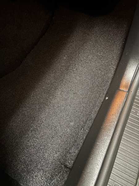

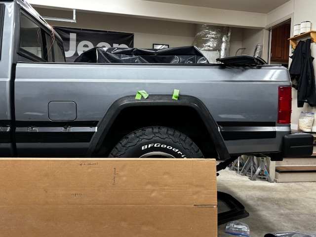

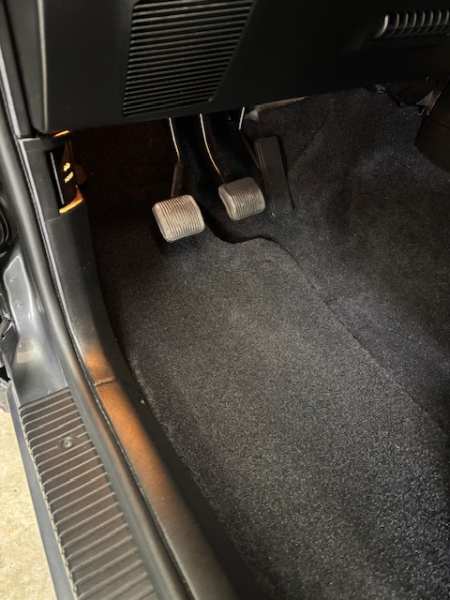

Gjeep Posted February 12 Author Share Posted February 12 I revised the graphics slightly for this build and submitted them to the local graphics shop for production. Sounds like I’ll get them back Tuesday and will be able to lay them out on the test truck (my ‘91) by end of next week. It will be the side, hood, and tailgate blackout. Looking forward to seeing them right and ready for final installation on this ‘92. In the meantime, the ACC floor mats have been haunting my sleep for close to 2 years. Ever since I first dropped them in. They’re too wide. At least by 1.5” all around and curl up at the tunnel. Not the best look. I asked they redo them and unfortunately a miss again… so I traced out a proper template on cardboard, taking into consideration the border that will surround the carpet. Then I got to tracing/ cutting the rubber underside and carpet itself. The final glue-together in a week or so. After that I’m going to replace the Hurst shifter – just the stick itself. The angle of this is perfect for the ‘97+ XJ’s but not quite right for the first gen dash in my eyes that is more vertical. Got to get it right. Link to comment Share on other sites More sharing options...

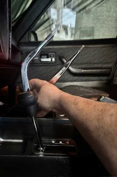

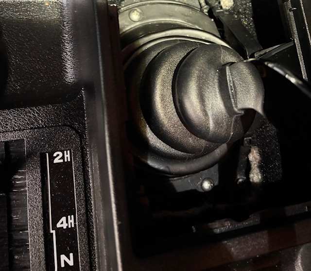

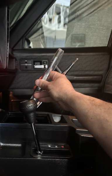

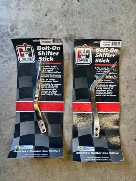

Gjeep Posted February 13 Author Share Posted February 13 I went through the Hurst website couple years back looking for the proper angle shifter for this MJ. It took some time going through the options and I ended up ordering 6 of them that seemed close to what I was looking for. Once received, there were only two that I kept to decide between once I got to it… and I finally got to it. The stick in place is what came with the short shifter kit. I always felt to be at too hard an angle towards the driver. Photos really don’t depict how odd it looks, especially when the outer visible interior boot is removed. When the boot is in place it crumples up tight console side even in neutral. Looks bad. First gear sits about where I think neutral should be. These pics are first gear shots. The options: The Original: P/N 5388009: P/N 538 7236 The 009 is the winner. It has a bend in it like the factory stick and feels right where the throws should be. It shouldn’t be too difficult swapping this out as I have a cut factory floorboard boot over the top of the Hurst boot. No need to remove the factory one, just slide the Hurst one out and unbolt the stick from the assembly. Link to comment Share on other sites More sharing options...

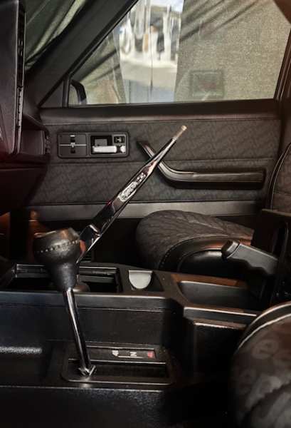

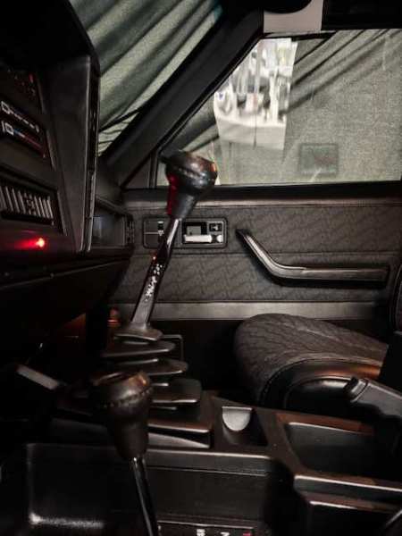

Gjeep Posted February 13 Author Share Posted February 13 Now this is right. Bolted the new shifter in this morning and it not only looks but feels/ falls right. No bunched-up boot in second gear any more. Some pics: Comparison: First: Neutral: Second: Sitting in driver seat, neutral: Glad I swapped it. Link to comment Share on other sites More sharing options...

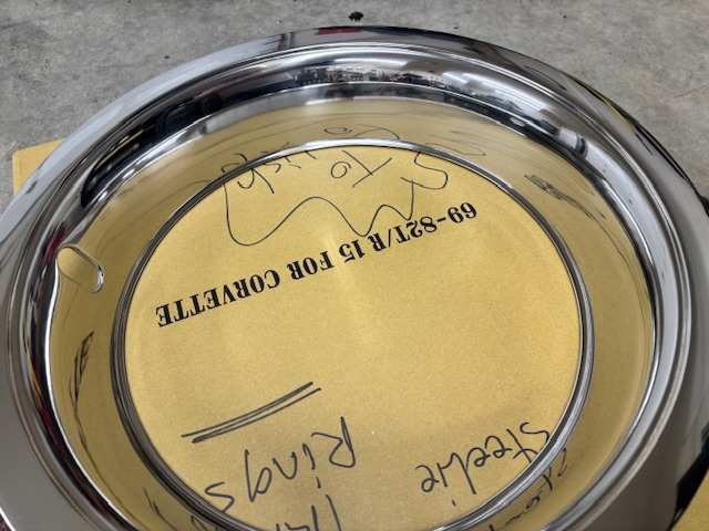

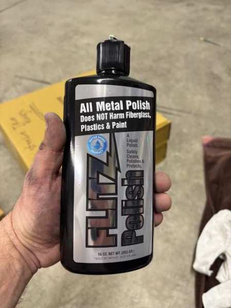

Gjeep Posted March 5 Author Share Posted March 5 Polished the stainless trim rings for the Mopar steelies. Fairly sure I’m going to install these, as some pop on the exterior should look right with the matte black graphics. Front end will have a polished Warn fairlead and mesh grille behind the black surround. Will see. There will be of course a Jeep logo on the center cap. Only thing inside that’s shiney are the sticks (transmission and transfer case). Two thumbs up on the Flitz Polish. User friendly and does its job well. The trim ring closest to me has not been polished yet, while the solo pic has been 3x. Link to comment Share on other sites More sharing options...

GonzoTheGreat Posted March 6 Share Posted March 6 21 hours ago, Gjeep said: Two thumbs up on the Flitz Polish Thats the number one choice for stainless in the superyacht scene, at least on this side of the atlantic. Excellent product! Link to comment Share on other sites More sharing options...

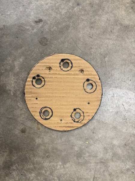

Gjeep Posted March 6 Author Share Posted March 6 I’m crazy. I’ll start there. Won’t even try the ‘call me crazy’… I’ve found just getting on with it is the way to go. So, when my wife asks, “why did you buy another Jeep. Don’t you have enough of them”. I simply reply, ‘I’m crazy’. Leaves nothing to question, bottom line next step is off to the asylum. Those center caps were nagging at me. I’ve always wanted to run those Jeep flat caps occasionally seen MJ/XJ’s with the 15x6 steelies. So, bright and early cut out a cardboard template and went to town with a 1/2” hole to recess the Jeep center into the rim. On the factory steelies the center cap rested on top on the rim and then the bolts screwed through from the backside. I needed to have the mounting points of the center caps go through the wheel because the near 1/2" rise looked odd on this Mopar steelie. So, through the rim the mounting points went to be attached with truss screws (wide head). And the stainless trim ring is still a work-in-progress decision. And I've got matte black lug nuts headed my way just to see how that would look. Options. Link to comment Share on other sites More sharing options...

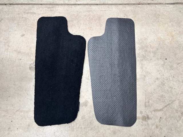

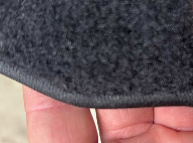

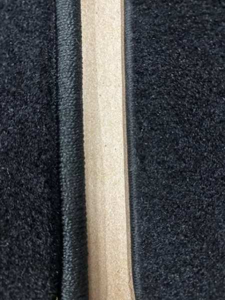

Gjeep Posted March 18 Author Share Posted March 18 Finally getting to the floor mats – I had purchased ACC mats way back when I bought the cab carpet and they were near 2” too wide, rolling up on the trans tunnel. That fact and the living room throw rug 1” border just didn’t look right. I asked ACC redo the mats again, reducing by 1” all around and of course I got the exact same misfit. Since carpet color match was important to me, it was at that point I decided to get into the floor mat making. It’s really not so different than wrapping sun visors or doing a headliner as far as thinking ahead of the contours and what you need to do with the cuts and medium. Instabind was a carpet edging I found when searching. I ordered a few other brands, but Instabind looked right and the black was an exact match to the Comanche’s carpet. Here are some work-in progress shots of the driver and passenger side. Instabind calls for the use of a hot glue gun at the immediate bond between the border and carpet edge, but that would have looked funky. Instead, my trials landed me at using 3M black weatherstrip adhesive. Does the exact same thing but matches the floor mat and is easier to use. To finish the floor mat off, I purchased a roll of the needed backside that keeps it in place. Link to comment Share on other sites More sharing options...
