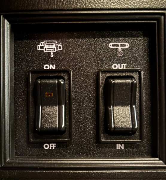

Gjeep Posted May 25, 2022 Author Share Posted May 25, 2022 Switch pods came together -- NOS XJ rocker and SJ momentary (winch in & out) switches. Link to comment Share on other sites More sharing options...
