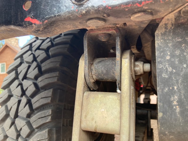

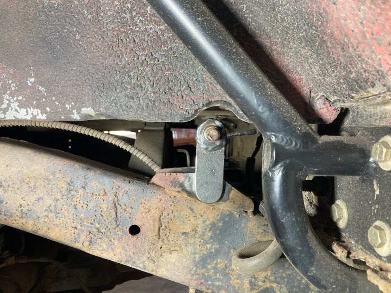

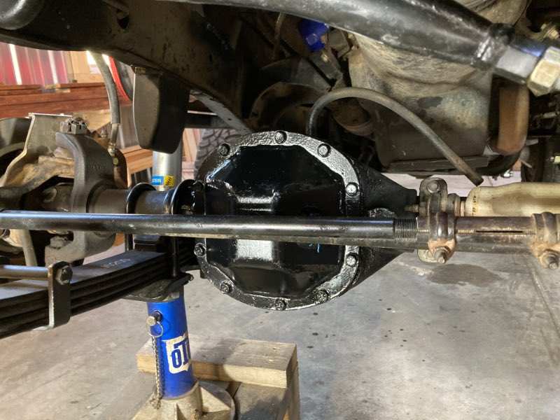

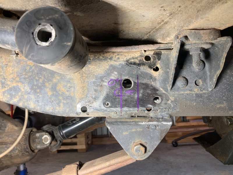

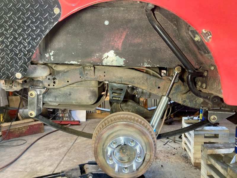

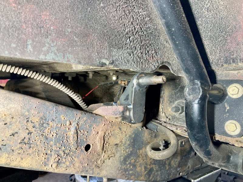

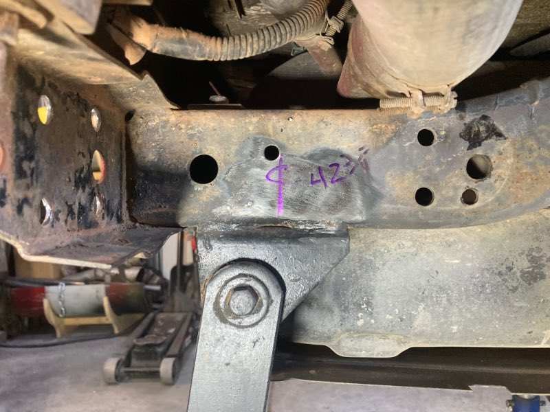

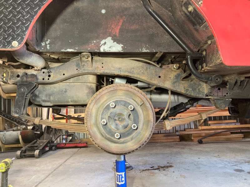

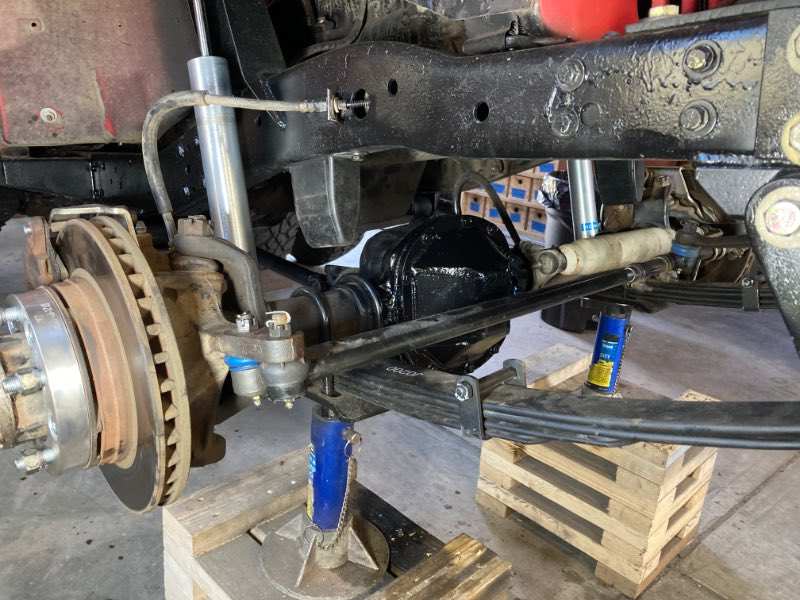

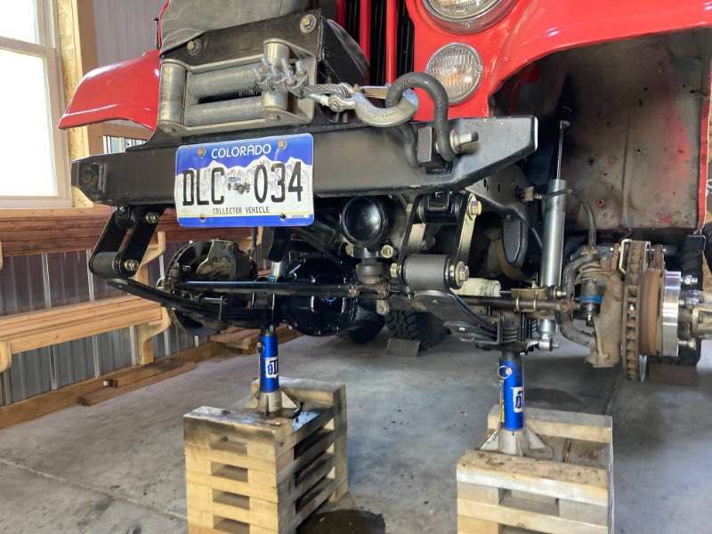

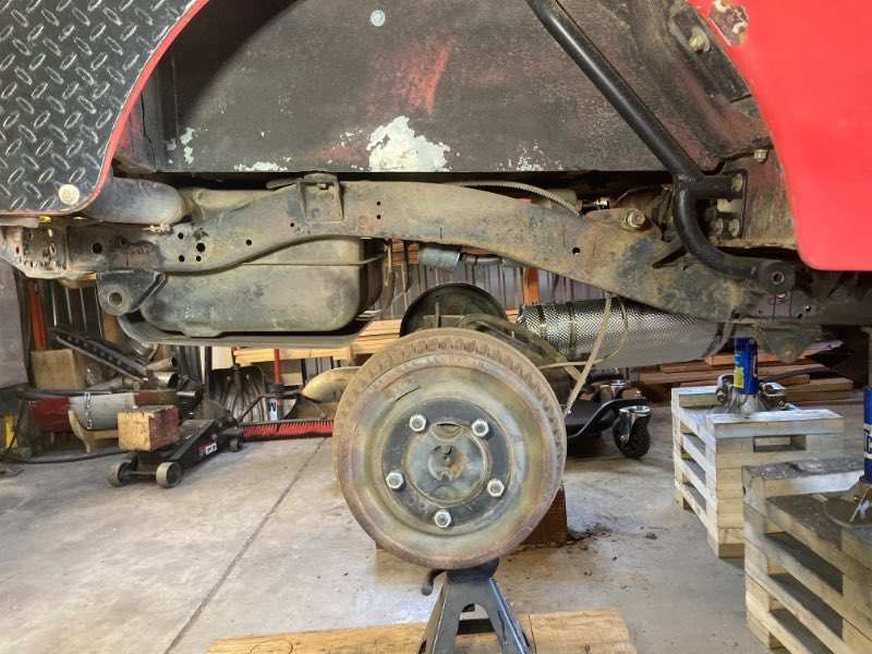

neohic Posted June 7, 2025 Author Share Posted June 7, 2025 Time to shed some winter weight. I didn’t take any in-process pictures but I’m sure you can connect the dots. It’s raincoat still fits too, so that’s good. Might need to get serious about a YJ spring swap too. All (important) fluids got changed today and I found three of the four shackle mounts have some level of cracks. The springs are clapped out along with every bushing being cracked and gone. Pretty sure the tires living at 20 psi is more suspension than the suspension is. Link to comment Share on other sites More sharing options...

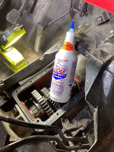

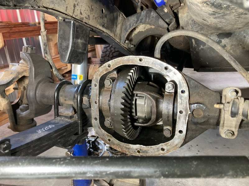

neohic Posted June 8, 2025 Author Share Posted June 8, 2025 Time to get back to the transmission. It still has a rattle since I did the swap and I’m pretty sure I didn’t do it any favors using whiz-bang Royal Purple gear oil. Do your stuff, gooey magic sauce! It got a quart of Lucas and three quarts of 80/90 dinosaur juice. First impressions are pretty good. I’m also certain that these things belong to others things in the transmission. It’s quiet?… er?… maybe? Still need to make suspension decisions. Probably fix what’s there in the mean time. Link to comment Share on other sites More sharing options...

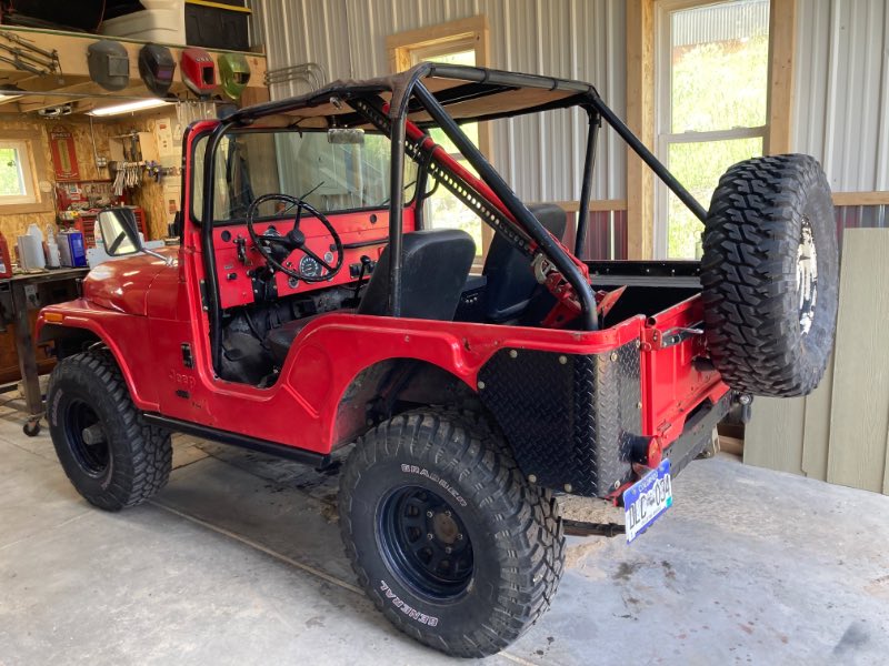

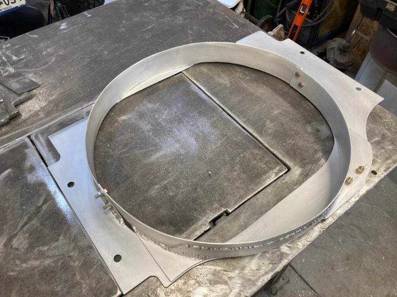

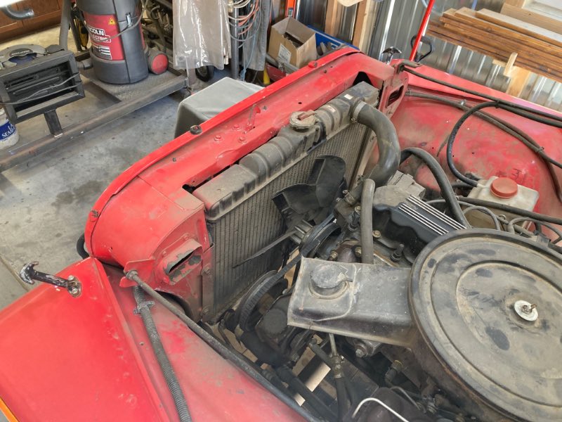

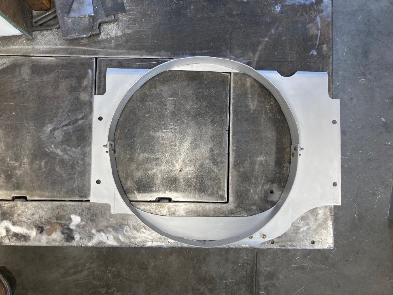

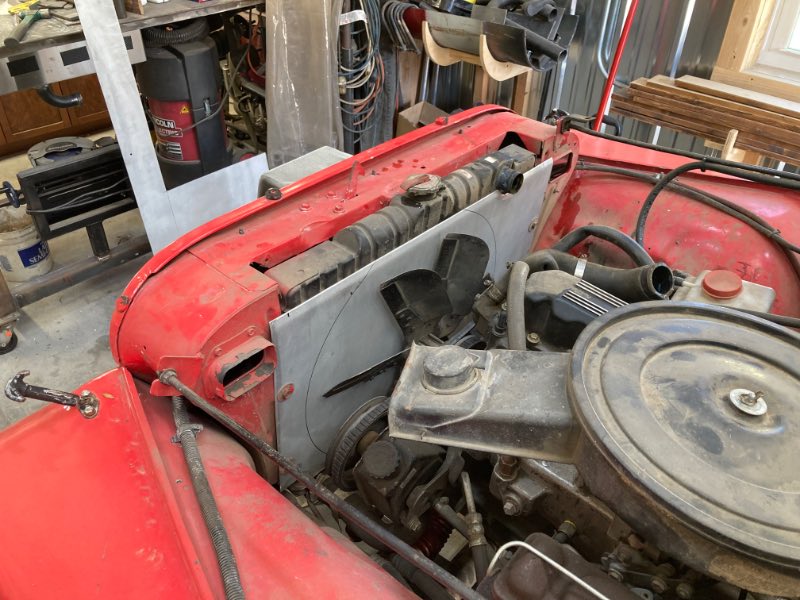

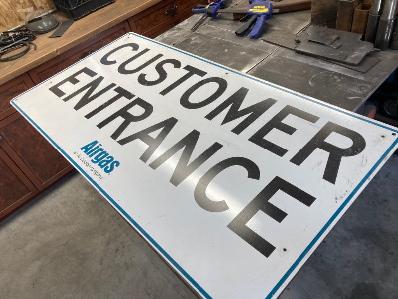

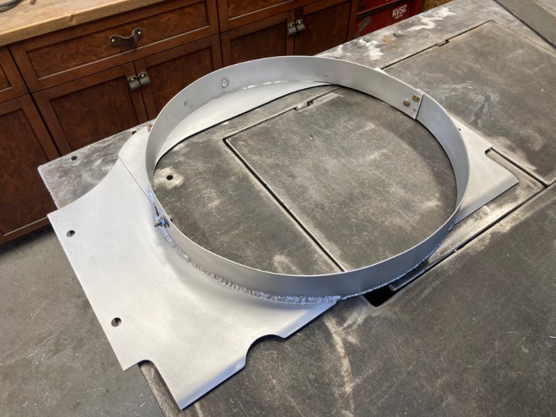

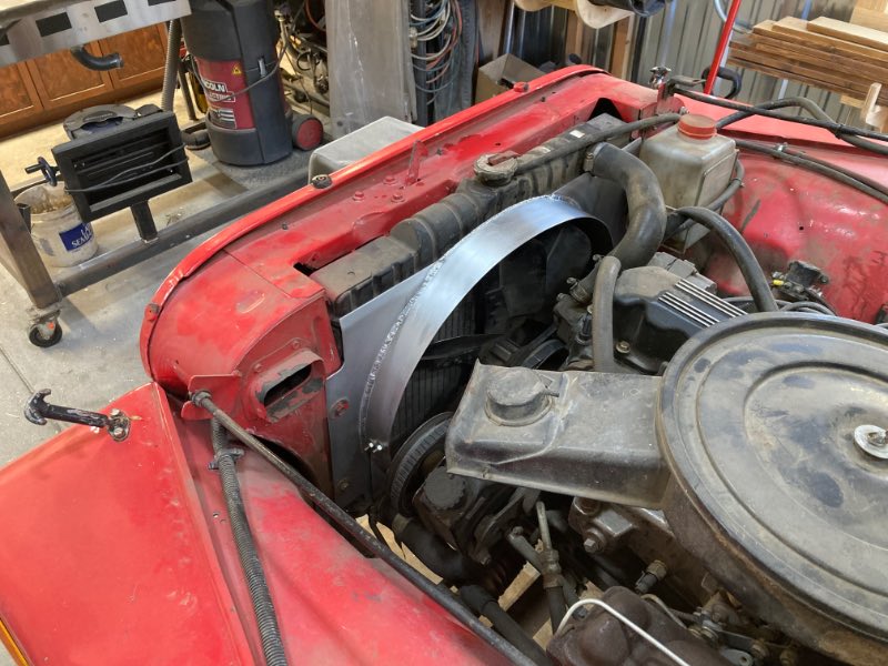

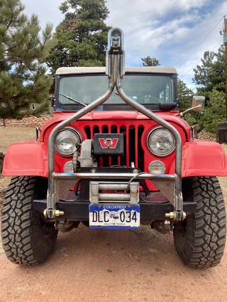

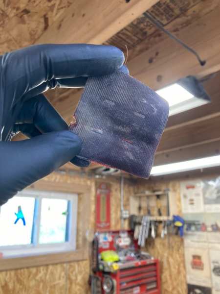

neohic Posted August 11, 2025 Author Share Posted August 11, 2025 I’ve got this constant list of projects for this thing that every once in a while I actually pick a line item that mechanically benefits the Jeep. Most recent pick was finally putting a fan shroud on it. Could’ve sworn I had one around. Oh! There it is! This sign is aluminum and a pretty good size. It took a bit to strip off the paint, but a DA with 80 and 120 grit made for a nice finish. I left about an inch all the way around the fan for clearance and made the shroud in two pieces. The main piece drops down from the top (with the upper hose off) and then lower section goes up from the bottom. The airflow difference is awesome! The CJ has never over heated on me… knock on wood. The temp gauge has read up to around 210° when toodlin’ around on a hot day, although I’ve never put a different gauge on it. Interested to see what kind of difference there might be. Link to comment Share on other sites More sharing options...
fiatslug87 Posted August 12, 2025 Share Posted August 12, 2025 Link to comment Share on other sites More sharing options...

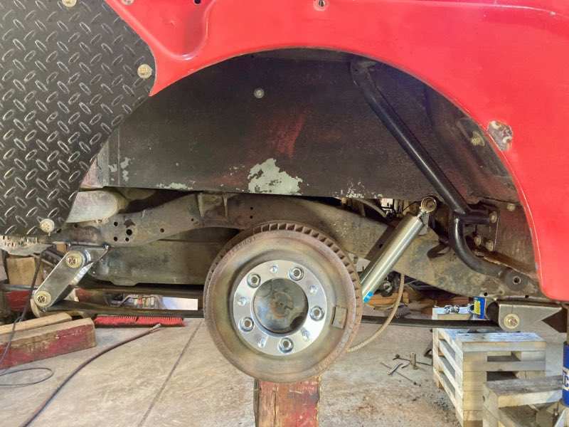

neohic Posted September 14, 2025 Author Share Posted September 14, 2025 Didn’t hardly pay to take the top off this year. Really didn’t drive it much this summer. I welded shut 26 holes in the rear fender well tops before the top went back on… completely forgot about the cracks in the suspension mounts until the shop was cleaned up. Getting to be sweater weather. Link to comment Share on other sites More sharing options...
Salvagedcircuit Posted September 15, 2025 Share Posted September 15, 2025 Nice Lookin Fan Shroud Link to comment Share on other sites More sharing options...
neohic Posted September 15, 2025 Author Share Posted September 15, 2025 24 minutes ago, Salvagedcircuit said: Nice Lookin Fan Shroud Haven’t even driven it since to know if made any difference. Link to comment Share on other sites More sharing options...
