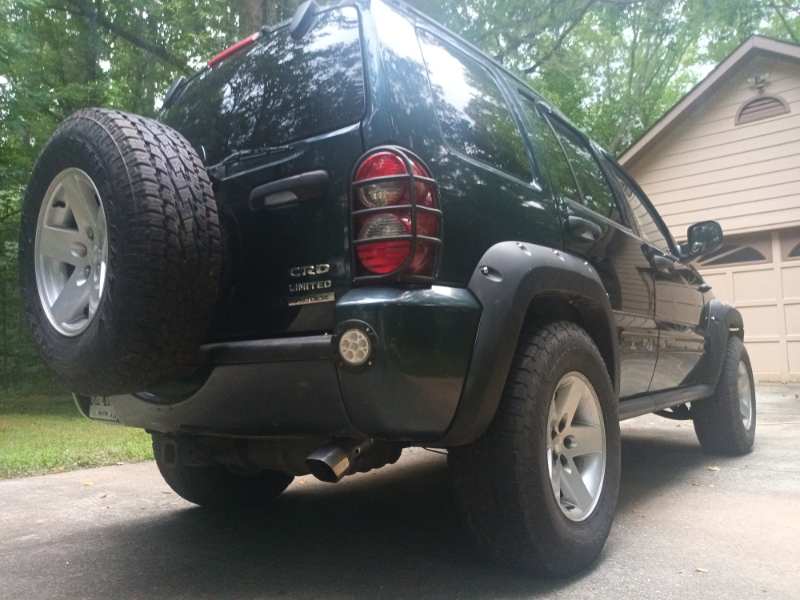

Pete M Posted July 9, 2025 Author Share Posted July 9, 2025 updates. removed the rotted exhaust, drilled a big access hole in the fender well, got the CPS out with an extraction socket, fabbed a new exhaust out of straight stainless pipe (still has the bend over the rear axle so I can keep my cool exhaust tip), and reassembled everything and made some promising (and cool sounding) trips around the block. but she's been sitting for a while when I was working on Breanne's MJ. a little too long. 3 of my 4 calipers seized up on me on the inaugural shakedown trip into town. tomorrow I address that. but the engine was revving like normal so I might have finally licked being stuck in limp mode all the time. Link to comment Share on other sites More sharing options...

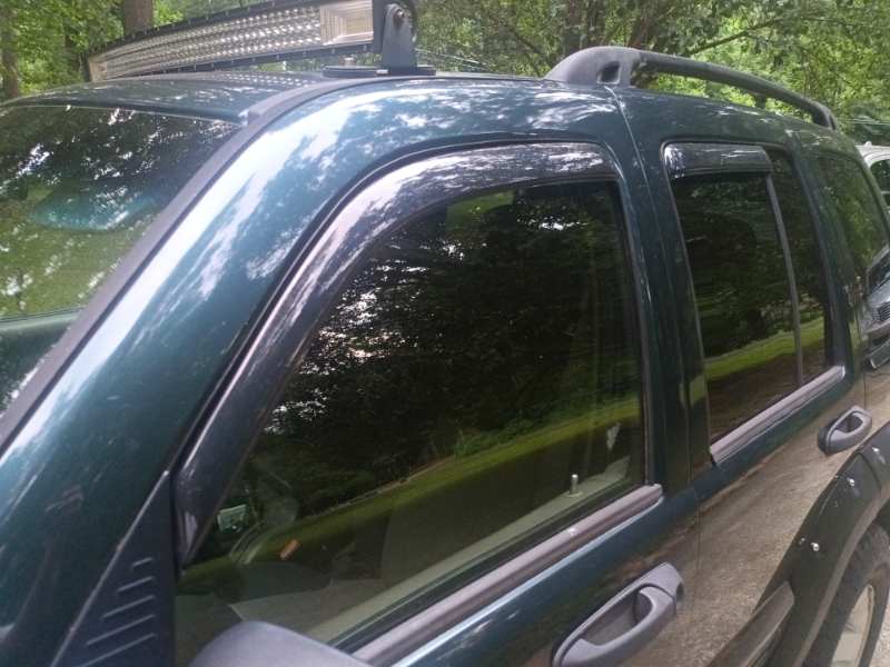

Pete M Posted July 10, 2025 Author Share Posted July 10, 2025 I was worried about droning at speed, but I don't even hear the exhaust over the other noises the Jeep makes. lol. today I installed some junkyard window rain vent thingies. Link to comment Share on other sites More sharing options...

Pete M Posted July 12, 2025 Author Share Posted July 12, 2025 the exhaust is a work in progress. I was able to salvage the middle hanger from my spare drivetrain. currently there are stainless hose clamps holding the pipe to the hanger. I'm not doing anything more until the Jeep proves reliable. Link to comment Share on other sites More sharing options...

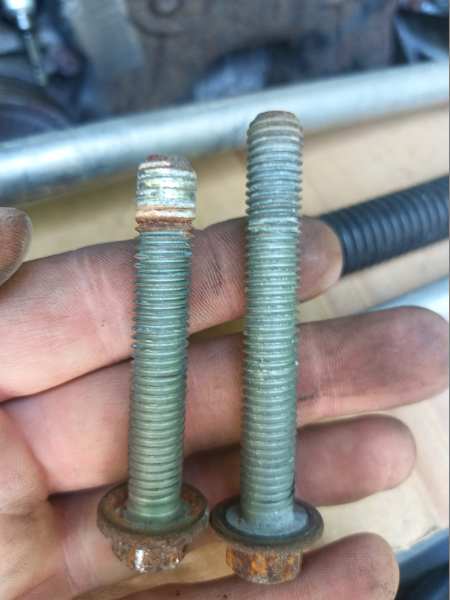

Pete M Posted July 17, 2025 Author Share Posted July 17, 2025 this is why I don't like people touching my stuff. the bolt on the left was holding my tensioner pulley in place. the bolt on the right did the same job on my spare engine. a huge thanks to whomever did the timing belt procedure a decade ago and crossthreaded a bolt that was too short to begin with. Link to comment Share on other sites More sharing options...

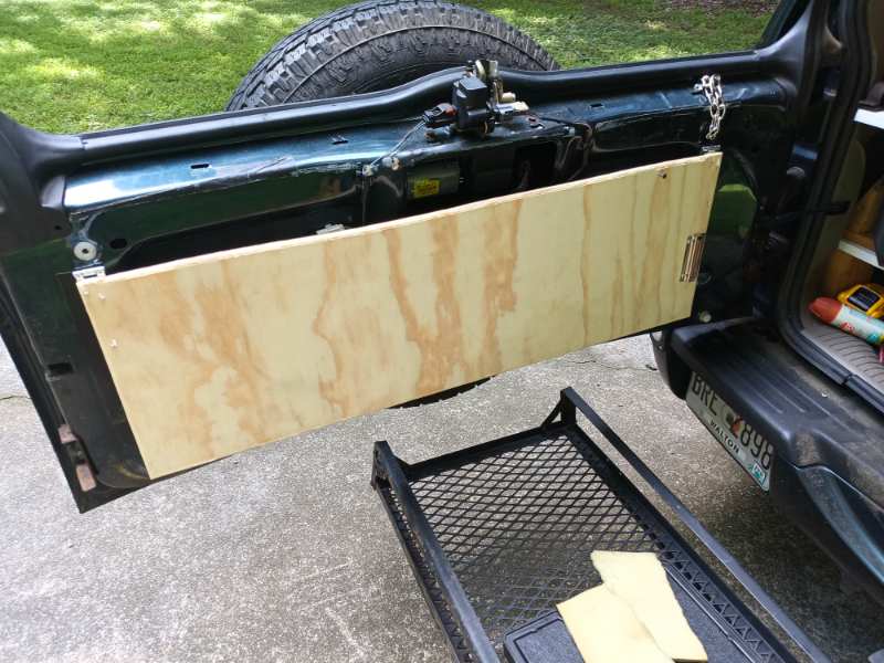

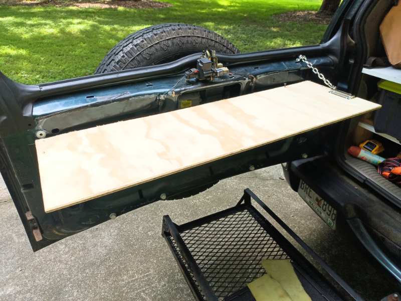

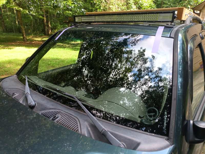

Pete M Posted August 8, 2025 Author Share Posted August 8, 2025 balljoint is here, so I'll try and do that this weekend. in the meantime I built a work shelf for the tailgate. this is just a test version. I'm still trying to figure out how to properly support it underneath. the chain lock works great to prevent it from collapsing when bumped, but hardly strong enough to support any real weight. and I got a new windshield today! hoo-baby I've been wanting one of those for a while now. most all her miles have been on concrete freeways and the glass has been covered with thousands of teeny-tiny sun-catching chips for years. Link to comment Share on other sites More sharing options...
watchamakalit Posted August 8, 2025 Share Posted August 8, 2025 What about some hooks that go up and out the window. Like a carhop tray. I know I'm showing my age but qhio cares anymore. Lol I feel you on the new windshield thing. I didn't realize how bad the chips in my MJ were till I put new glass in it. Link to comment Share on other sites More sharing options...
